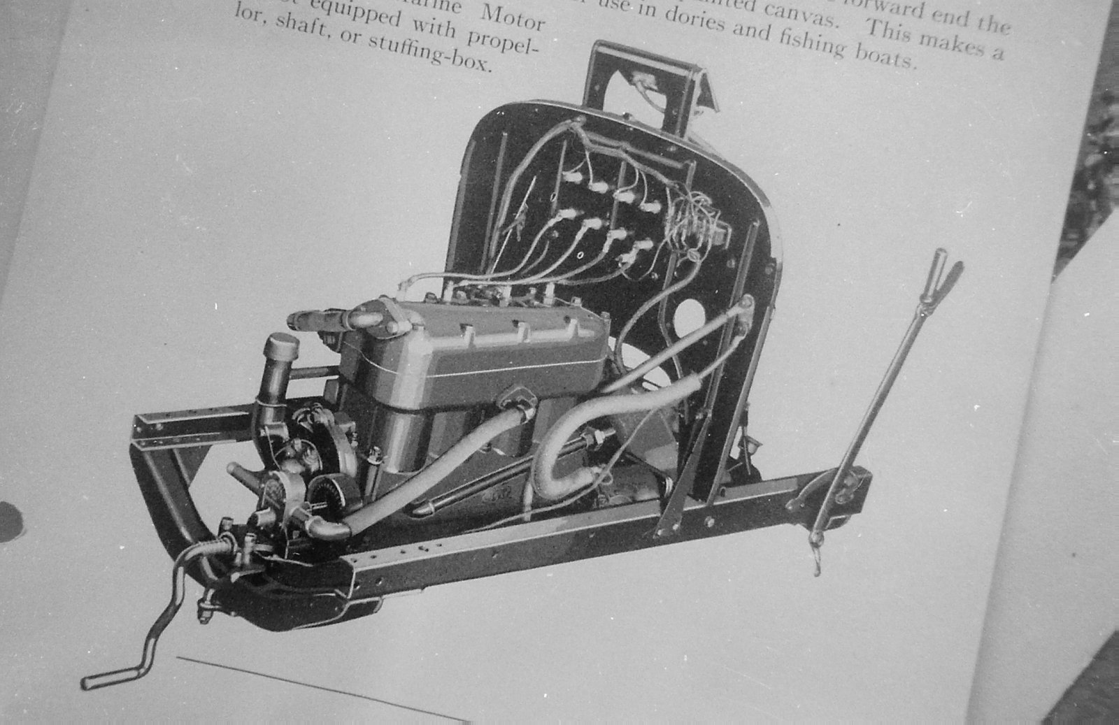

mario,
here is a photo of the Ford Canada motor, should have added it to the previous comment

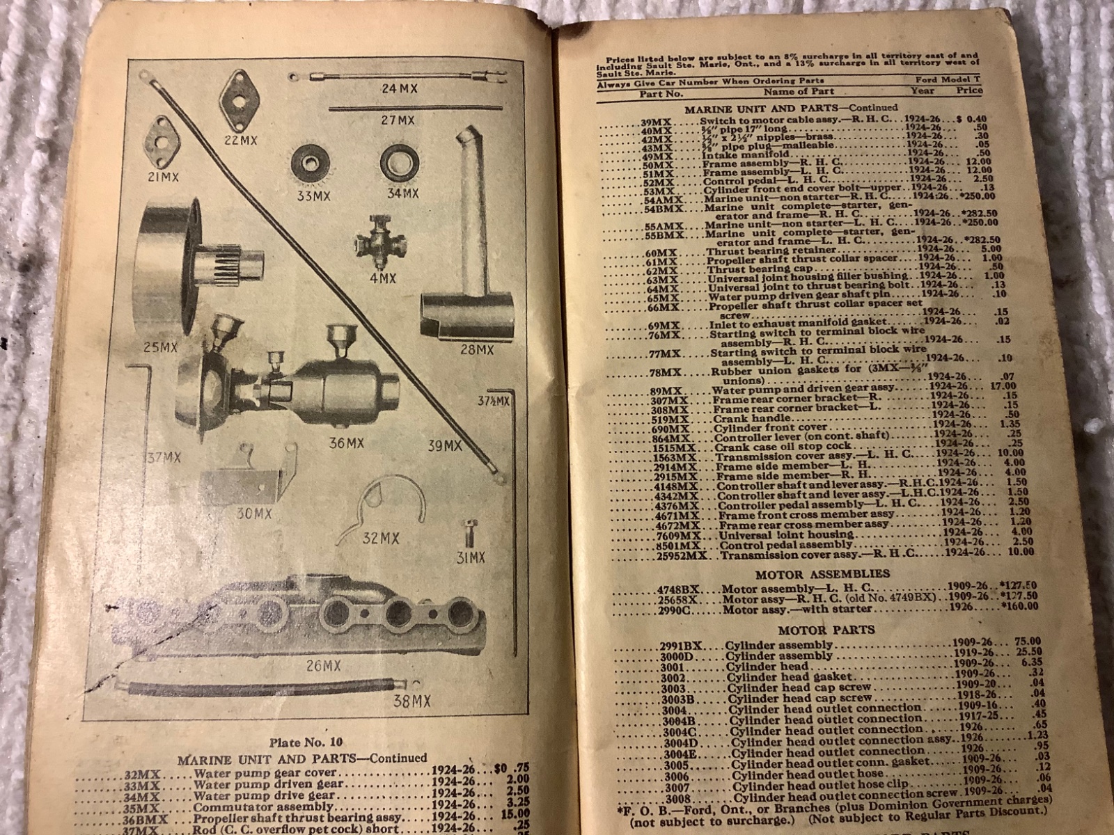

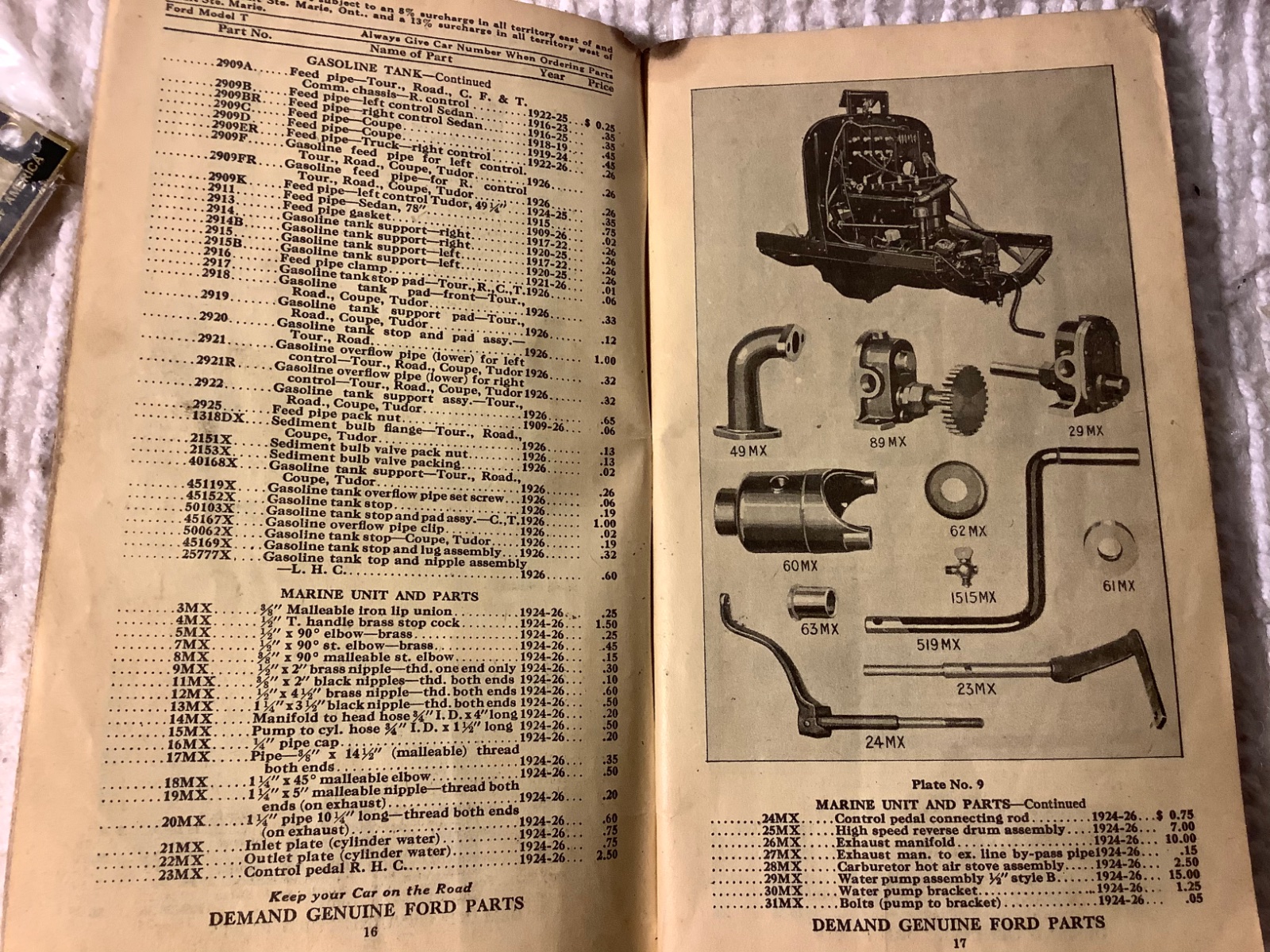

I’m missing the cover page but I believe this is the Canadian Ford catalog. Someone mentioned Roberts, that was in Sandusky Ohio. Right at the lakeshore. They made a lot of marine motors, mostly stand alone, but also a model T conversion.
