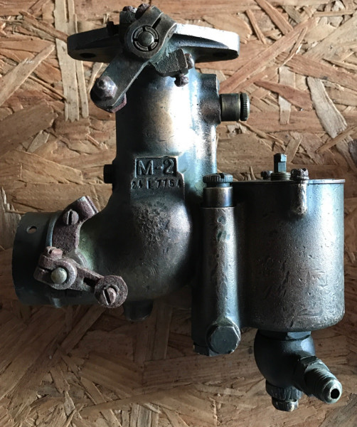

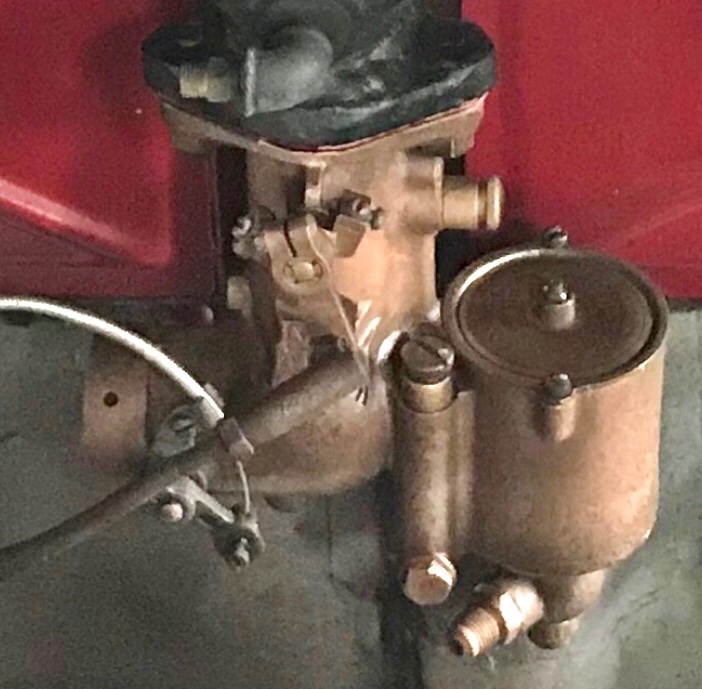

Re: Ultrasonic cleaning solution
I used vinegar..
After cleaning, blow it out and wipe it down good to clean off any loose gunk, then reclean again to get the best result.
I then clear coated it to try and extend the life.
