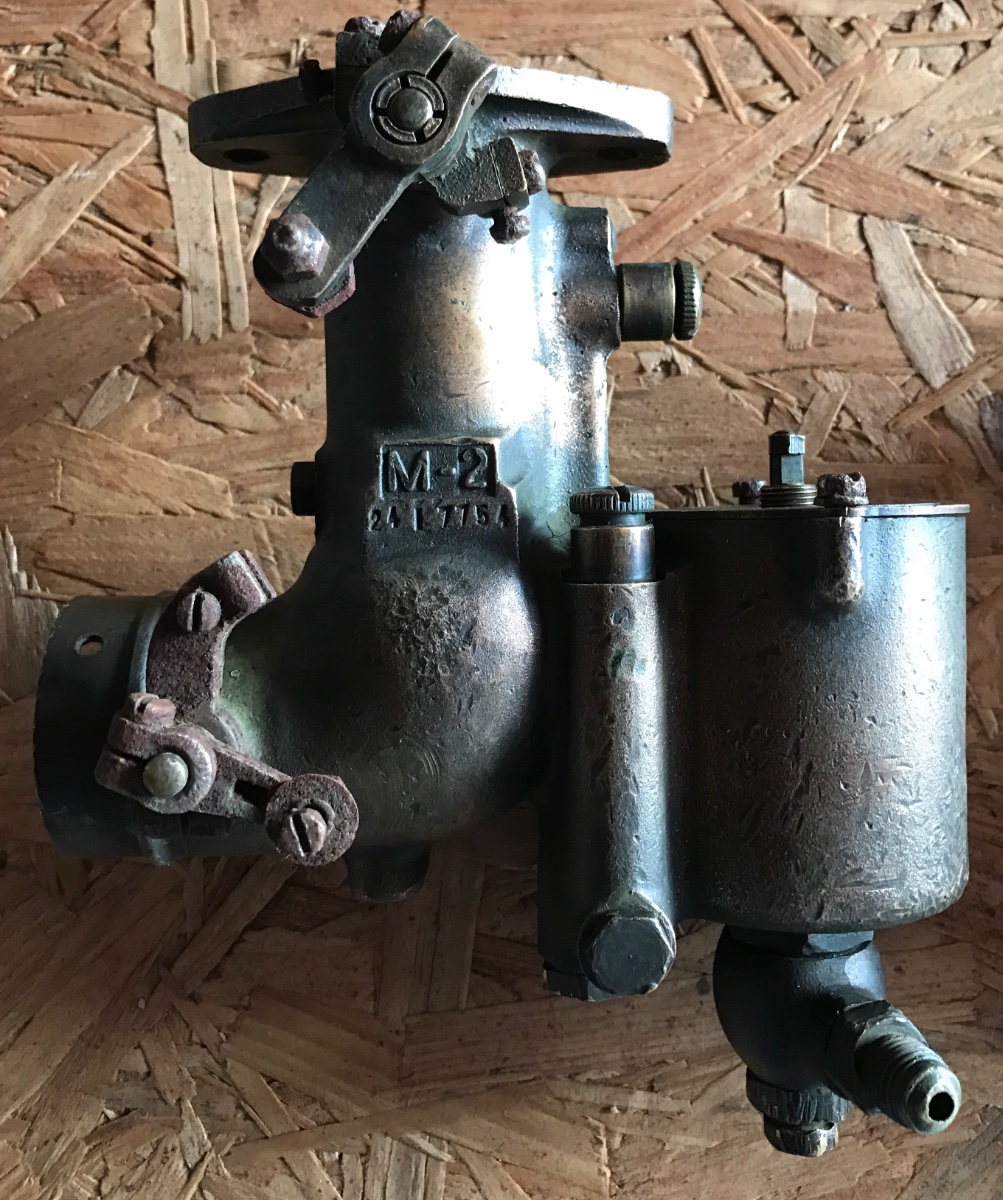

Looking for input on what is being used for the cleaning solution for carburetors in an ultrasonic cleaner? Brass, Iron or Aluminum carbs.
