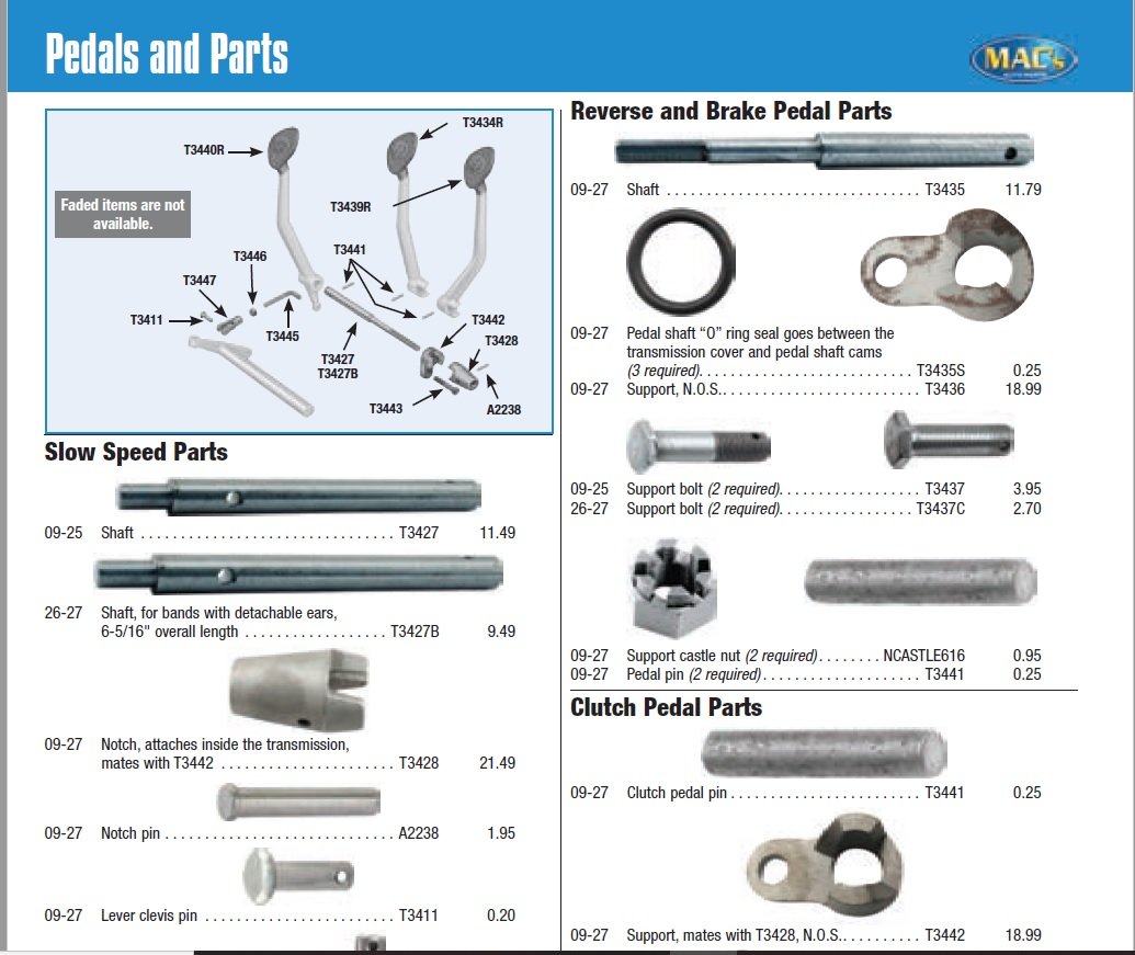

From Mac's Catalogue- Just for reference. There are also support cams for the brake and reverse pedals

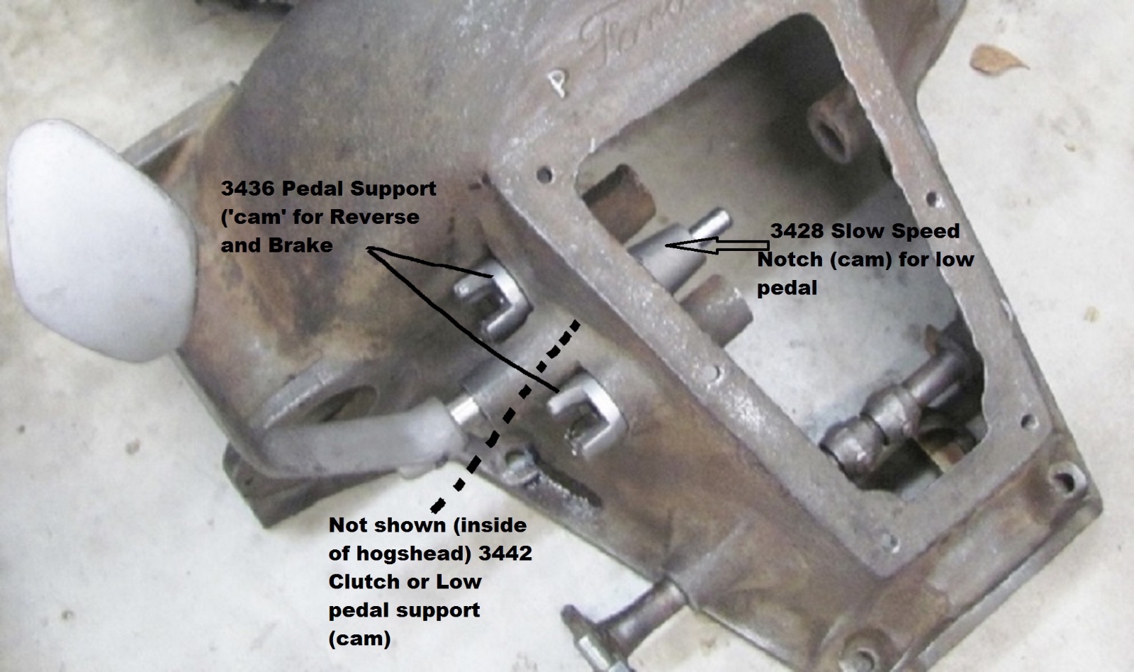

Only the Improved Car hogshead, '26-'27 can fit the wide brake drum correctly as designed.
This hogshead has the wider spacing of the pedal shafts to accommodate the wide brake drum. The key visual feature are the two lug holes that allow this hogshead to be bolted to the back of a '26-'27 block, that is unique with the two bosses to receive these bolts.

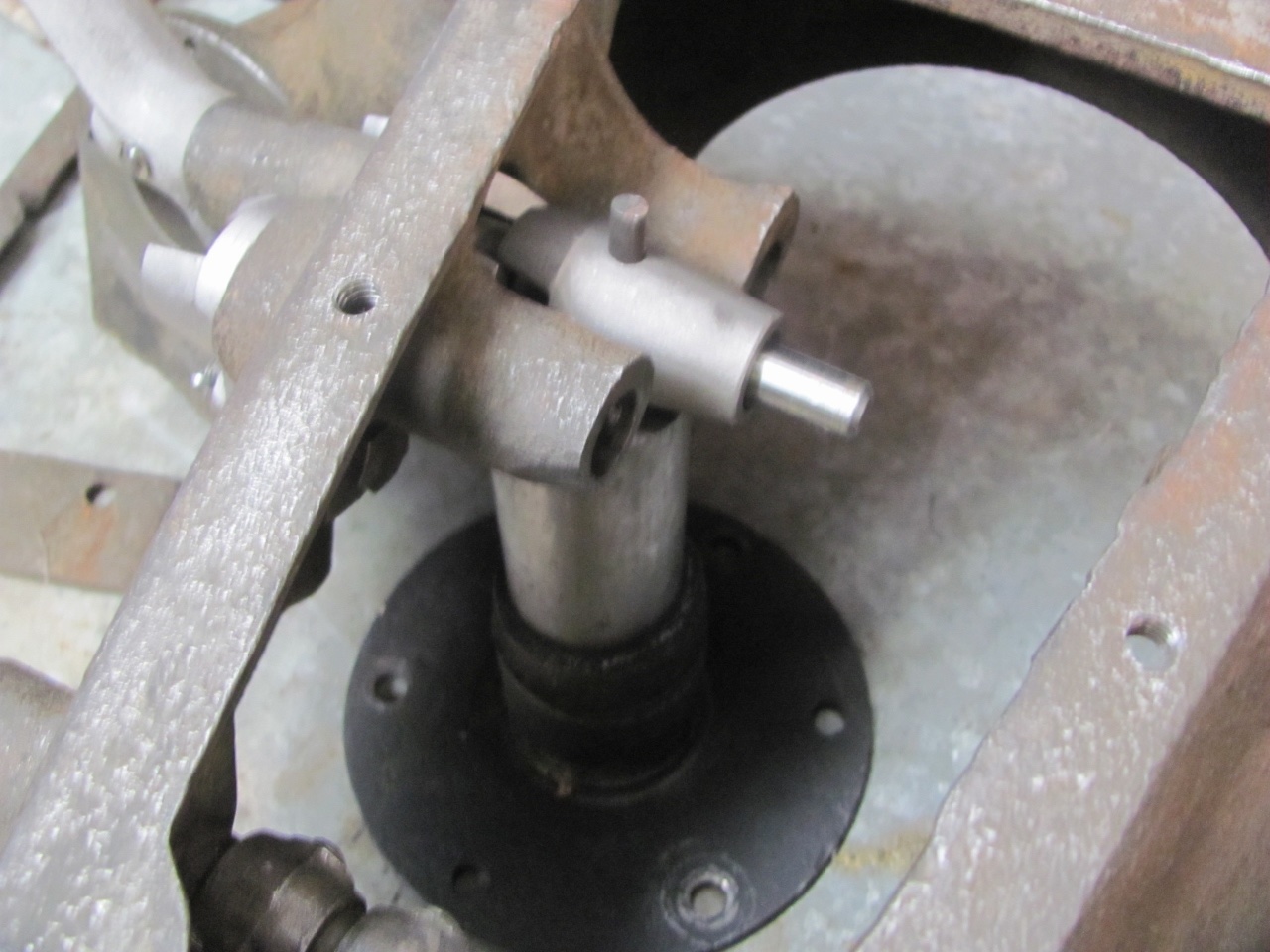

For complete rebuild of the hogshead, these parts are needed, and you should also change out the pedal shafts if any have wear. That work requires the pedal shafts to be cut off, and rivets removed from the pedals, and new shafts riveted back in place. Plus the low pedal shaft is riveted to the low speed notch, that has to be done with care, supporting the hogshead up to keep from damage to the pedal boss of the cast iron hogshead.

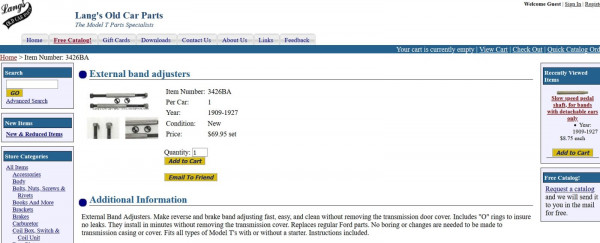

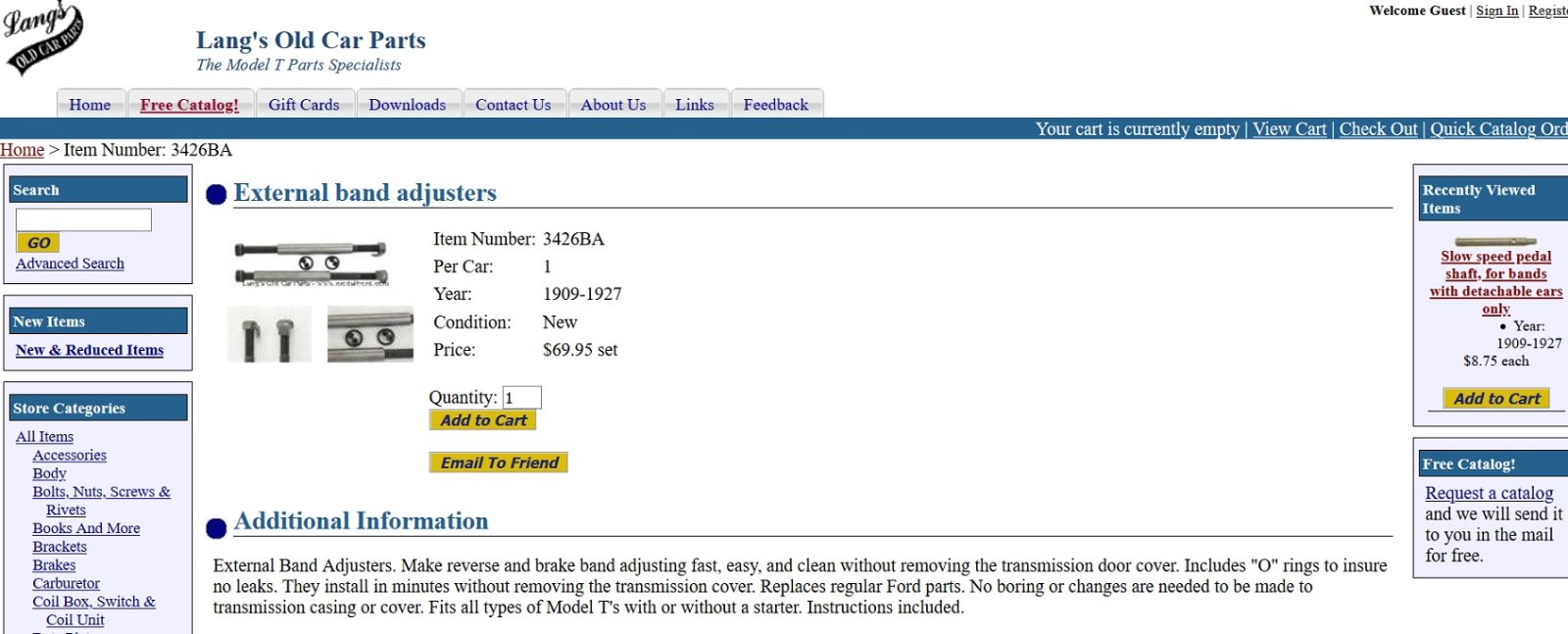

Re: Hogshead difference between the years?
