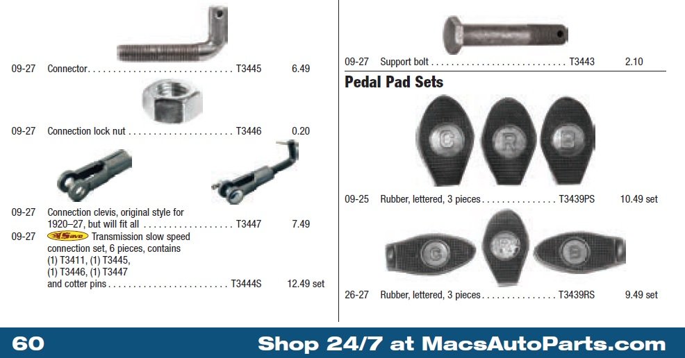

From Mac's Catalogue- Just for reference. There are also support cams for the brake and reverse pedals
I would expect that pictures of the hogsheads that you have would help others identify what you need

MAC's isn't the only source for the parts you may need - they just had the best diagram. Prices vary by supplier (Mac's, Langs, Snyders, Bob's, S&J, Chaffins, etc). Good '26 Slow Speed & Reverse pedals may be difficult to find if needed, Brake pedals are more common as some are replaced with ones needed for outside brake systems like Rocky Mountain. The support face on the pedal needs to be in good condition to mate with its cam. There is an accessory to replace the Brake & Reverse pedal shafts. Lastly, you may need the adjustable shaft, 3427B, if you have bands with detachable ears and don't already have one.
