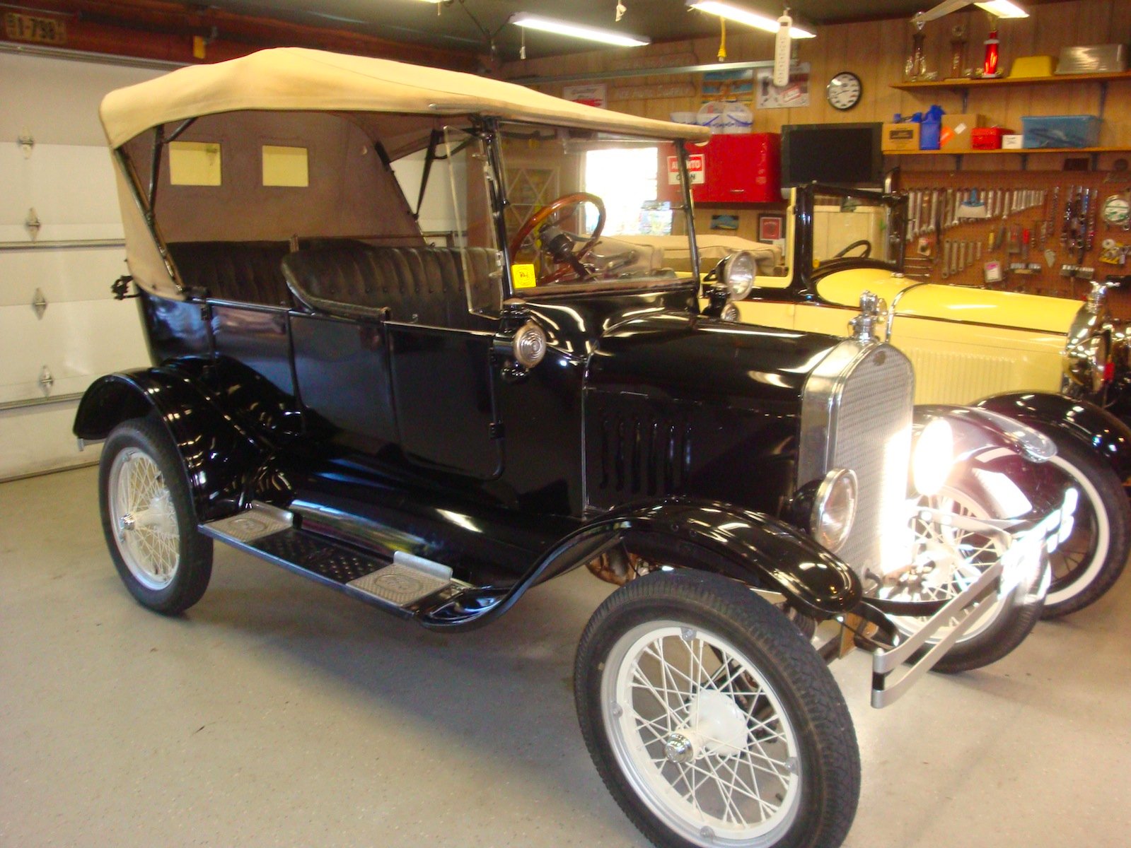

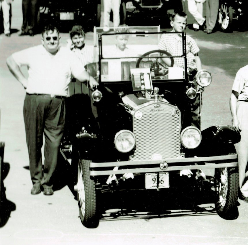

The late Louis Seekon of Minneapolis, MN had a 1924 touring that he dolled-up with a number of accessories including a radiator stone guard.
He was a talented fellow.
Instead of being a period accessory, he may have fabricated the stone guard himself in the 1950s using off the shelf materials. The main part of the stone guard was flattened expanded metal sheet/lattice that you can still purchase today. I can't remember if the trim around the perimeter was flat metal or a split tube.
If I recall correctly, it had a three-point mounting - one tab each for the left and right radiator/radiator shell mounting studs and nuts and collar that went around the base of the radiator neck.
The first photo below was taken in 1959. The second photo is of the car that I took in 2016 when it was still in Minnesota - sorry about the poor quality.
You can ask Jeff Perkins if he can provide close-up photos of the stone guard.

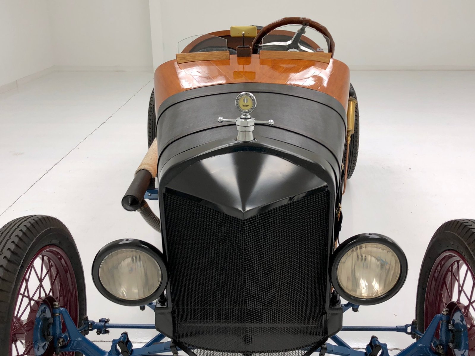

I saw this - for a speedster - not the transparency of the mesh at the bottom of the photo. Several suppliers for metal cloth to mesh grade on-line https://www.mscdirect.com/browse/tn/?na ... d=12101790 <- even in brass
