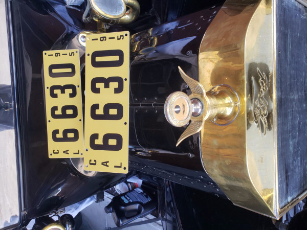

Reproduced my 1915 California license plates. What do you think? ...Picture.
NorthSouth
Posts: 640
Last Name: California
Location: West Coast
Post by NorthSouth » Thu Aug 06, 2020 12:00 am
rbishop26
Posts: 77
Joined: Sun Jan 06, 2019 5:24 pm
First Name: Bob
Last Name: Bishop
Location: San Diego, CA
Re: Restored my 1915 California license plates. What do you think? ...Picture.
Post by rbishop26 » Thu Aug 06, 2020 2:40 am
WOW! Are those porcelain like the 1914's or metal? Either way, unbelievable job.
Are you for hire? :lol:

NorthSouth
Posts: 640
Re: Reproduced my 1915 California license plates. What do you think? ...Picture.
Post by NorthSouth » Thu Aug 06, 2020 5:27 am
Bob,
These are metal. The originals are porcelain.
Posts: 5575
Last Name: Gregush
Location: Portland Or
Post by Mark Gregush » Thu Aug 06, 2020 11:31 am
The 1915 plates were metal with porcelain coating. Did you mean painted?
Post by 1194668jc » Thu Aug 06, 2020 1:21 pm
Wow, those look great! Did you do them or did someone make them for you?
Post by HPetrino » Thu Aug 06, 2020 3:21 pm
Nice work!!
Every time I see old CA plates it makes me think of the two red 1914 plates my grandfather used in the 1940's, '50's and early '60's to scrape apricots off the drying trays. They each had a piece of wood screwed to the upper holes so you could use them without cutting your hands. Being made of heavy meatal with porcelain on both sides they worked well. When he retired and sold the place in '63 sadly they were discarded as just more old junk. :(
Post by Susanne » Thu Aug 06, 2020 4:04 pm
The depth of field threw me off - I thought one was smaller than the other! Beautiful work!

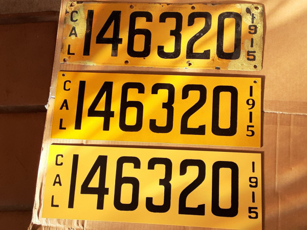

Here is the plate for my car I made about a year ago. The top is the original, the middle is printed on paper then glued on steel testing to see if it would look correct. The 5 wasn't quite correct. The last one is ink on steel. These are not street legal, but they do look nice. I also made a 1915 brass registration dash tag using the license plate number. With such good luck on the dash tag, I'm trying to make the center discs of the 1915 high F hub caps then I will attempt to solder them into repro hub caps.
Post by Susanne » Thu Aug 06, 2020 5:55 pm
The fonts are wrong on the center one but the bottom one looks good!
Post by Vrayfoster » Thu Aug 06, 2020 10:18 pm
Good eye spotting the wrong fonts. I took a best guess at the fonts when I made the center plate. It took several printings on paper to get the background yellow correct. I found a 15 plate and saw the font differences and corrected them before printing them on steel. The fonts on the lower plate are exactly what was on 15 plates. Using photoshop I manipulated the fonts to get them lined up correctly then off to the sign shop to print a set of plates. Ing-Rich is the Ingram-Richardson manufacturing co. in Pennsylvania The 14 plates were thicker than the 15 plates and I've found them in excellent condition.
