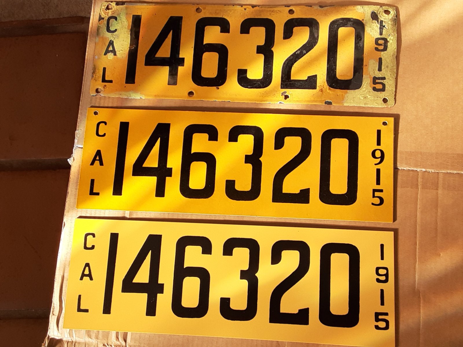

Here is the plate for my car I made about a year ago. The top is the original, the middle is printed on paper then glued on steel testing to see if it would look correct. The 5 wasn't quite correct. The last one is ink on steel. These are not street legal, but they do look nice. I also made a 1915 brass registration dash tag using the license plate number. With such good luck on the dash tag, I'm trying to make the center discs of the 1915 high F hub caps then I will attempt to solder them into repro hub caps.

The fonts are wrong on the center one but the bottom one looks good!

Good eye spotting the wrong fonts. I took a best guess at the fonts when I made the center plate. It took several printings on paper to get the background yellow correct. I found a 15 plate and saw the font differences and corrected them before printing them on steel. The fonts on the lower plate are exactly what was on 15 plates. Using photoshop I manipulated the fonts to get them lined up correctly then off to the sign shop to print a set of plates. Ing-Rich is the Ingram-Richardson manufacturing co. in Pennsylvania The 14 plates were thicker than the 15 plates and I've found them in excellent condition.
