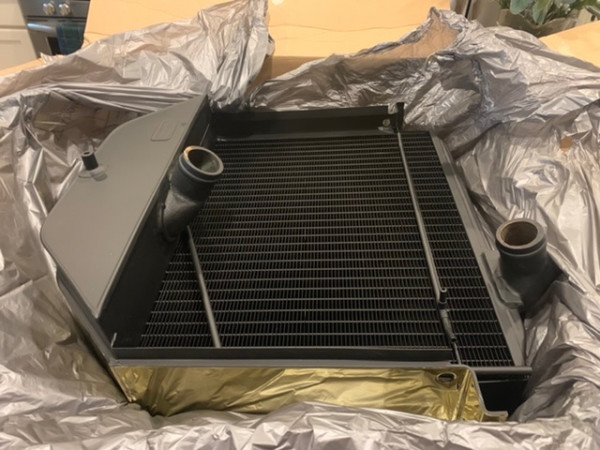

The 13T’s new radiator came in from Brassworks today. I’m thankful for their knowledge and experience to produce such a beautiful part of the T.

Those new brass rads sure look nice don't they Darin.
Piece of advice/suggestion...the area of brass from the gas pipe downward, being the narrow flat front trim piece and even the horizontal flat section where it bolts onto the frame...I learned to mask that section from the rest, and spray them with gloss lacquer. It does a great job of protecting it, especially the horizontal flat bracket section, which is all but impossible to really keep polished 'cause it's just plain hard to get at, plus the bolt/cotter pin gets in the way and likes to grab ur skin. The lower front trim piece takes a beating from the road grime also, and this really keeps it looking good. Do what you want, just a suggestion.

It sure is perty. I love mine. Did you notice the tag on the under side of the top tank?

Keith - I did not notice that Brassworks tag/serial number until you pointed it out. Thank you.
This radiator is an exciting part to get in. It is a center piece of a brass era Model T and will, hopefully, be the last major part needed on this restore to get it initially back on the road. I know there’s a lot of parts in the future to keep the old girl on the road... but one step at a time!

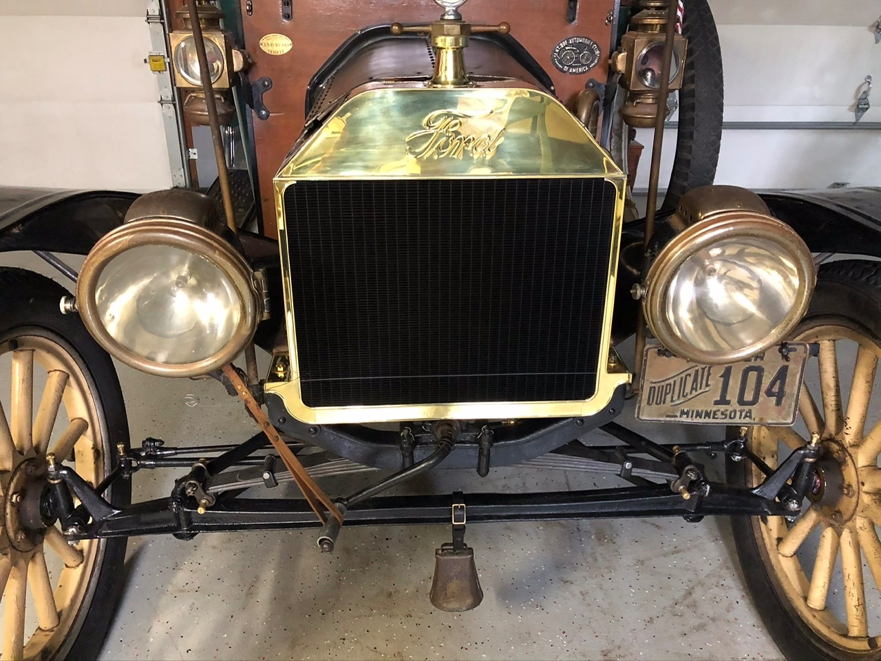

New radiator for my 1913 was purchased last spring. Thank You Brassworks! I do not plan on polishing it so eventually it will match the patina on the rest of the brass lights on the car.

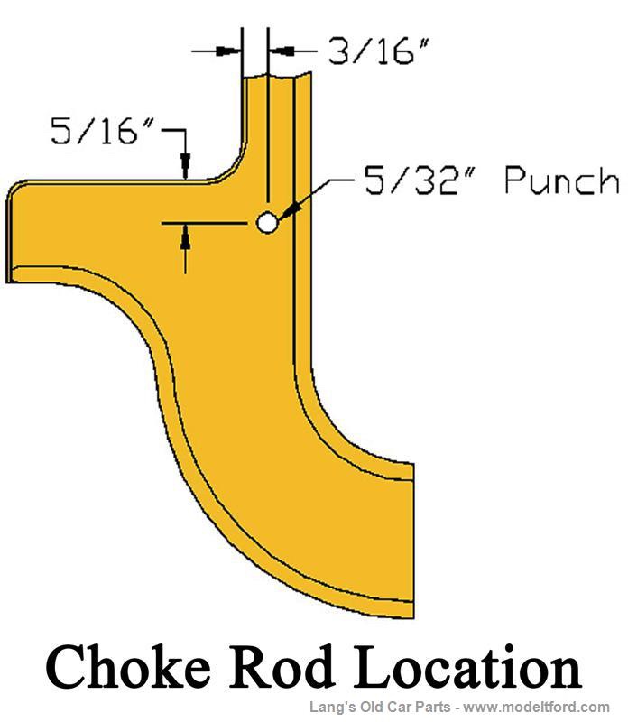

The radiator didn’t come with a hole for the choke. Would y’all suggest drilling a hole in the correct place, which I can use the old radiator as a reference? Or fishing it through the radiator fins like I’ve seen some others?

NO!!! Do NOT put the choke rod through the core (fins and tubes) Drill a hole in the apron. Use your old radiator to see where to drill the hole. Also the GREAT folks at Brassworks can give you almost any patina you want on a brand new radiator . They did my 1915 touring and it matched the rest of my 105 year old brass exactly. bobt
- Posts: 7411
Re: 13T - New Brassworks Radiator
Why not? I don't always agree with Larry, but I'm sure with him on this. It's the main reason I had my 1915 radiator recored instead of buying a new one. Of course, saving several hundred dollars didn't hurt.
I suppose the difference between 1920 and 2020 makes today's less sturdy radiator construction described by Larry adequate for most people. A hundred years ago a Model T in most cases was the owner's only car, a daily driver, and in many cases it was driven on roads that gave everything a good shaking. Today most Model T's are driven much less, and mostly on smooth roads, so the flimsier radiators survive in them. I suspect this is why I haven't seen more forum complaints about new radiators coming apart.

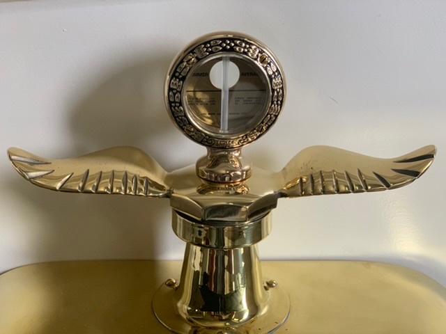

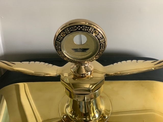

Boyce Motometer Jr and gull wings came in and have found their new home

Darin, I would not use the wings on the motometer. I had the experience with wings on a new brassworks radiator that I believe caused the solder joints to crack on the filler neck twice. After the second repair, I replaced the wings with a dogbone and have not had a problem in 7-8 years. "Experts" on the forum strongly disagreed with me but I can only state the facts from experience and not theory. I think the wings cause excessive wind pressure on what I believe weaker is brass used in the top tank, not necessarily thinner brass. I think others have had the same problem but did not zero in on the wings effect. Best wishes, Dick.
