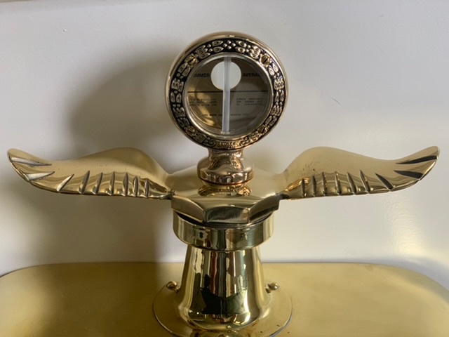

Boyce Motometer Jr and gull wings came in and have found their new home

Darin, I would not use the wings on the motometer. I had the experience with wings on a new brassworks radiator that I believe caused the solder joints to crack on the filler neck twice. After the second repair, I replaced the wings with a dogbone and have not had a problem in 7-8 years. "Experts" on the forum strongly disagreed with me but I can only state the facts from experience and not theory. I think the wings cause excessive wind pressure on what I believe weaker is brass used in the top tank, not necessarily thinner brass. I think others have had the same problem but did not zero in on the wings effect. Best wishes, Dick.
