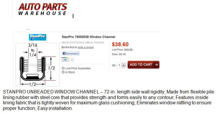

Several years ago i replaced the window channels in my 27 Tudor doors. I found the channel sold by the vendors was too narrow to fit the existing safety glass. Also my car did not have the rubber at the top but the same window channel as the sides. With some online searching I found Stanpro window channel. They make it in many sizes and found some that was an exact fit to my doors and glass. I removed the hooks from the original channel and reused. Hope this helps.
