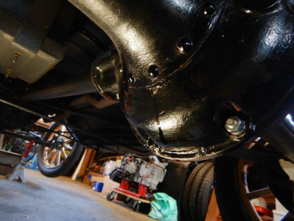

Hi all,
I wonder if you can give me some advice for the repair of the oil leak on this 1912 rear axle?
Is there an easy way to do this or need the rear axle been taken apart?
What is the best way to do it?
Andre

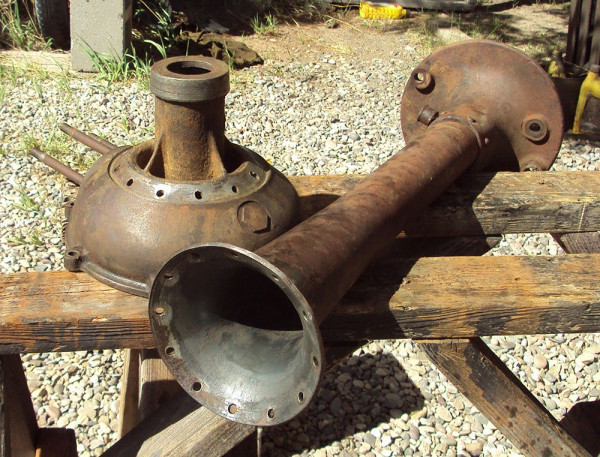

On my '14's rear axle, I soaked the housings for several days in mineral spirits. To do it, I made a temporary tank by nailing four 2 x 12s together and lining the resulting rim with a sheet of 6 mil plastic. I put a piece of scrap OSB in the bottom so that any sharp edges on the housings wouldn't cause a leak. After removing the housings and letting the drain for a few days I blew them out good with compressed air and let them air dry several more days in the hot summer sun. Then I disassembled the "tank" (nothing to store!) and set the wood and plastic aside for another use.
Once I was satisfied that the housings were hospital clean and dry, I mig'd over the heads of the rivets on the inside to strengthen and seal them. Then I ran some Permatex around the inside of the seam where the tubes joined the halves of the punkins. Finally, making an applicator from a 14" long piece of strap steel with the last inch of one end bent at a 90 degree angle, I reached into and sealed the tube/bearing housing joints with fresh JB Weld. Upon final assembly I installed two paper housing gaskets with more Permatex. No leaks, not a speck, for almost 20 years.
Now I'm getting a few drops from the housing center joint but I think that's caused by the lower housing bolts' stretching. I'm going to replace the LH axle this winter because it's gotten bent out at the end from driving the car on the lunar landscapes that NY calls roads, so when I do I'm going to make a new set of bolts and nuts from Grade 8 steel to help with the stretching issue, along with the added truss rod that I installed last summer.
