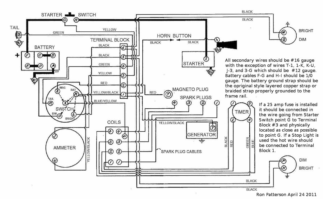

12 gage wire, can't answer the generator question. You should add an in line fuse near the starter switch to your power wire. If you had enough power draw to melt the wire it would have blown the fuse, may or may not have protected your generator.

"Best" wiring diagram for a later starter equipped car, showing where to put the fuse:
