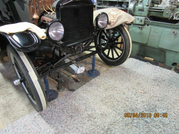

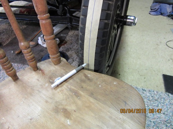

The way I do it is jack up the front wheels and spin, run a piece of chalk over the center of the tire as the wheel spins. Take a piece of wood with a nail in it, with the nail pointing upward toward the time and place it on the floor under the center of the tire, actually the nail should be enough above the bottom of the tire to allow you to scribe a mark in the chalk as you spin the tire. Then let the jack down and measure the distance between tires at front and at back. Most accurate would be to roll the car to turn the wheel one half turn and measure at the same place both in front and in back. You are limited as to where you can set the toe in because of the yoke at the end of the tie rod. I adjust to where both front and back are equal distance to zero toe in. Then turn the yoke to lengthen the rod till you get the location where you can install the bolt. I then tighten the bolt and jamb nut and install the cotter pin. It works for me. You can't get it any more accurate without bending something.

The car is to be jacked up to scribe the center with chalk, but it is on the ground when you actually do the measurement. An easier way without using the chalk and scribe would be to put a square on the wheel to the floor. Put masking tape at the point where the square touches the wheel in front and make a mark on the tape Then measure distance in front. Push the car to where the square meets the tape in the rear and measure. Same adjustment as above. The actual measurement is made with the car on the ground because you are measuring the toe in under actual condition in which it would be driven.

Some of you guys are getting a little carried away, and that's ok if you wish to do it that way. I too use a chalk line, but only put it on the tire on one place on each side. Then, I rotate the wheel 180 degrees and measure it again. No need to scribe the chalk line all the way around.

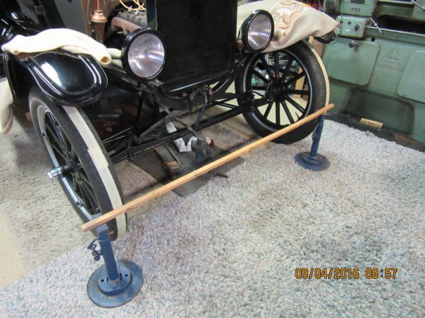

I have always used a piece of 3/8 pipe with a round steel rod that slips inside. Drilled a hole in the side of the pipe and welded a nut on the outside so I could lock the rod inside it when I expanded it between the front inside of the tires on the sidewall. Place it about 1/2 way up the tires, lock it in place and then place it inside the tires behind the axle about the same height. You can measure it with a ruler at this point if need be. Works great for one person. Remember when changing the gap subtract thew measurement you want to set it at from the measurement you have and adjust half of the the excess and check again. If you adjust out the whole excess you will have just put the excess on the opposite side. You may want to jack up the wheels before you start and see if they are running true. If they are not then while they are jacked up use a heavy marking pencil or the edge of a screw driver on a block of wood and spin the wheel and place a mark around the face of the tires . Set the tires back on the ground and get someone to help you and measure from line to line both front and rear and write down your measurements and add or subtract what you have and you have your gap and adjust if needed.
