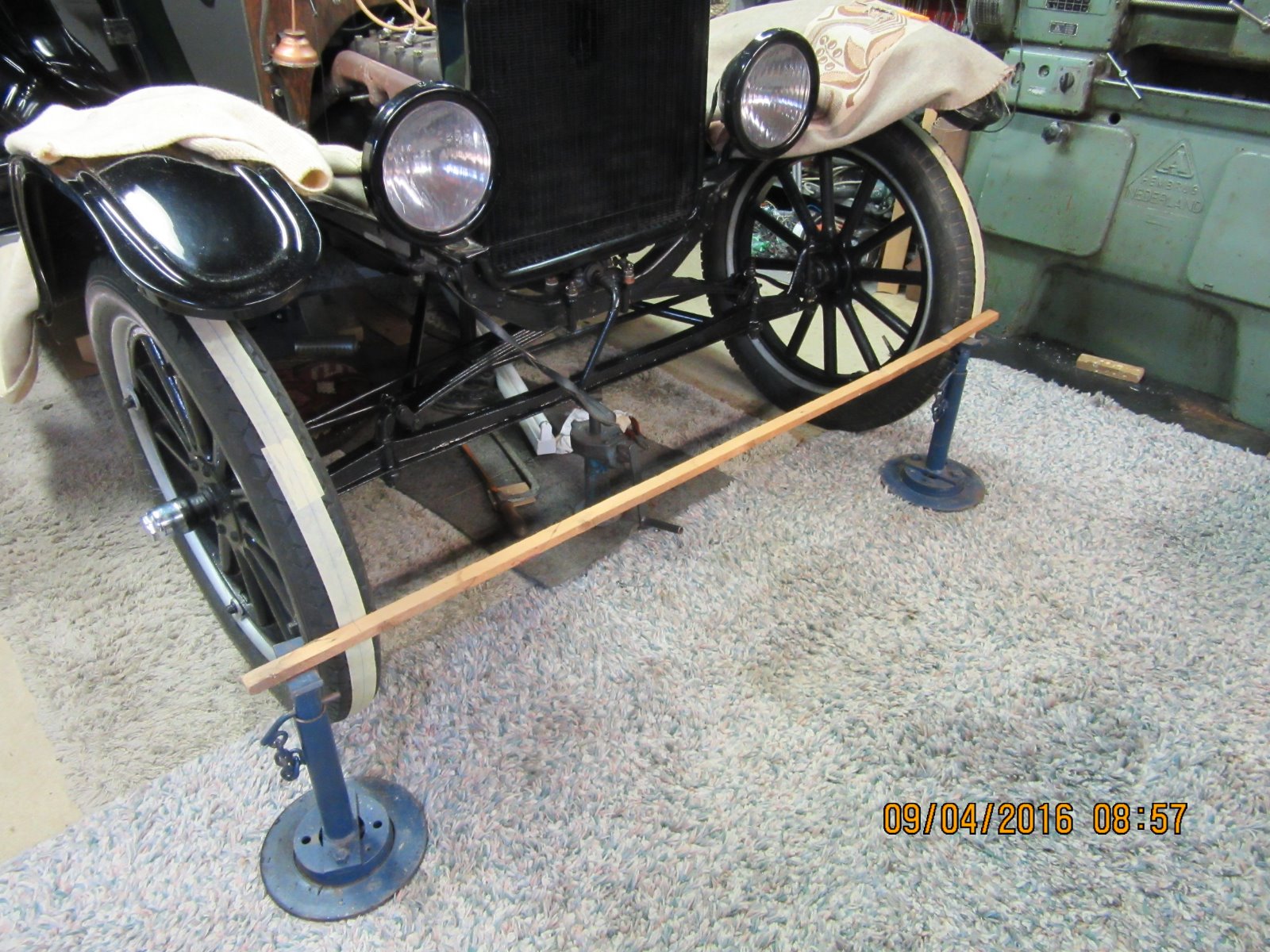

- First Name: Anthonie
- Last Name: Boer
- * REQUIRED* Type and Year of Model Ts owned: 1912 touring 1923 roadster 1925 pickup
- Location: Klaaswaal NL
Re: looking for easy way to check toe-in
I do it this way .
