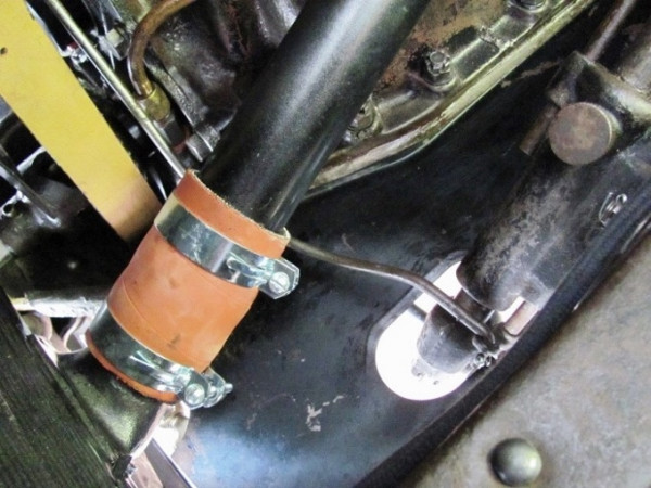

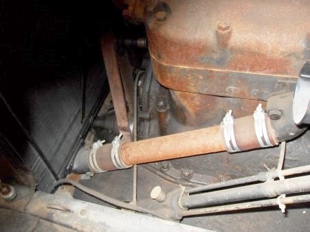

Post by cars47 » Sun Nov 15, 2020 8:56 pm
[image]
[/image]
Hard to see....my 1925 T

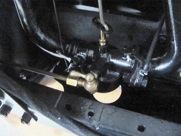

Post by DanTreace » Sun Nov 15, 2020 9:00 pm
Here are views from a '23
Carb side
Steering side
23 left side pan.jpg (76.46 KiB) Viewed 6885 times

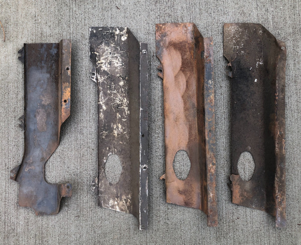

Post by Mark Osterman » Tue Nov 17, 2020 2:07 pm
Been trying to put together a pair of good original pans. Here is what I’ve found so far. Because i have a U&J carburetor I will need to modify the right side pan.

Post by dhosh » Tue Nov 17, 2020 7:49 pm
Mark... Wonder if the right side guards get pulled and cast asside more often, than the left, because of the carburators?

Post by Original Smith » Wed Nov 18, 2020 12:25 am
I think the style that Mark posted was used in 1924 too. My 1925 has a type that is similar, but has a round hold under the carburetor. Also, the back side of the pan is contoured, which is handy if running a speedometer. The one I use on my '25 was made by Tom Rootlieb several years ago, because all the originals I have are too beat up. The one Dan Treace pictured is what I use.
