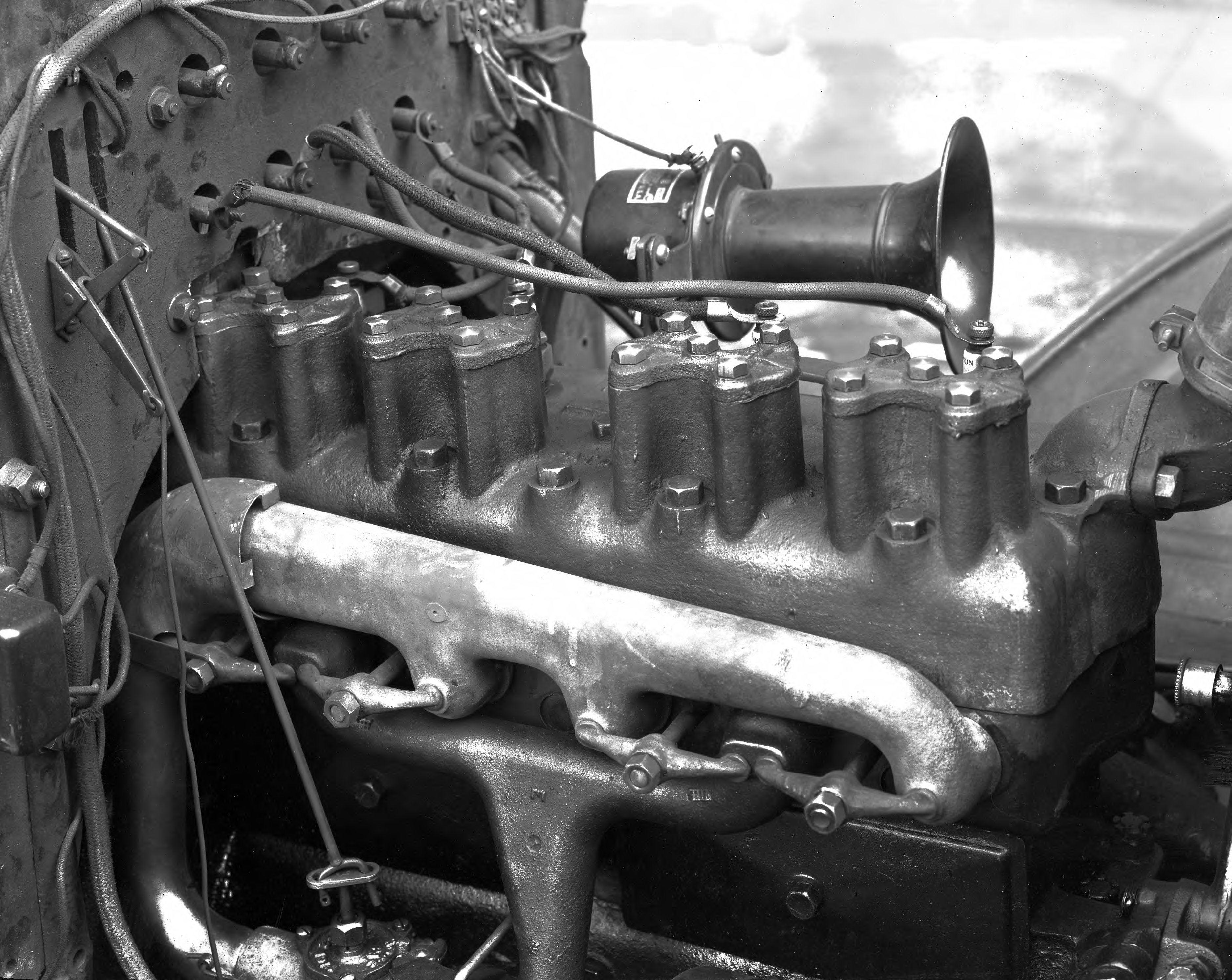

This photo shows a very early generator car. Its rectangular cutout is correctly mounted on the firewall. There is a hole in the firewall (just inboard of the carb adjustment rod) where the wire from the cutout passes through. I assume it is going to the ammeter.

Well, the "extra wire" isn't a ground...it is the generator wire contained within a later wiring loom and left unused. Hard to tell if the generator is a very early FA generator even after blowing up the picture, but I'd love to see which ammeter is on the dash, as early ones are beautifully made and the light switch is a cast and not stamped item.
Mark Nunn: who cares about where the cutout is mounted...look at that head!!! What's going on there??

Sleeve valve conversion?

I was wondering too. The intake valves appear to be spring-loaded and not connected to the cam. Downward piston movement (pressure differential) would open valves. My understanding is that some period motorcycle engines had valves like these.

"Automatic" or "atmospheric" intake valves were in wide use on low speed stationary engines and some very early cars. They quickly fell out of favor for automotive use due to their limited speed range and throttling effect and limitations on valve size/weight and valve timing options. The atmospheric intake valve had to have a very light spring in order to function, and that would not allow for engine speeds much beyond 400 RPM, if that. Volumetric efficiency was also limited. The ability to time the intake valve opening and closing points was very limited. I can't think of a reason to convert a T engine to such a system, especially if it involved significant expense. A stock T engine would run within a limited speed range if you removed the intake valve lifters and put low pressure intake valve springs in it. But if you increased RPM very much above slow idle, the intake valves would begin to bounce and float, and valve timing would be come erratic.

I'd like to know more about that cylinder head.
