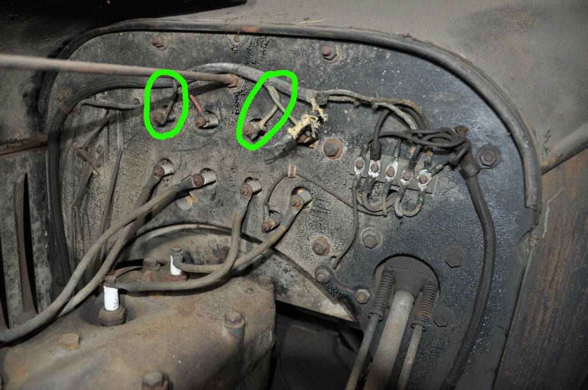

			I have what I believe is an original condition 1921 Touring. There is an extra wire in the right side wire loom which is not connected at the generator or the 5 terminal firewall block, as it has a single wire running from the single terminal on the generator cutout to the ammeter, through it's own hole in the firewall, parallel to the right side loom. Is this original?

Doesn't look like a correct cut-out (aftermarket?) and the extra wire on the generator is a ground. I see a pulley can't tell if is from the outlet water neck or a water pump on the side of the engine.

Correct early style rectangular cutout, you can faintly see the Ford script stamped into the cover in the posted photo by Sarvert's.
Please correct me if I am wrong, but I do believe that the single wire going from the cutout to the ammeter is correct, for the early F.A. electrical system (rectangular cutout, firewall or generator mounted). The wiring harness is later with the wire for the cutout in the loom and going to the terminal block. Could this be a case of a faulty generator that was replaced with an earlier "working" one at some point? A 1921 should have the round cutout and utilize the wire in the harness.

Thanks for the assistance. Here is a photo of the other side. Where would the loose yellow wire from the cutout, tie into the 5 terminal block?

You say it is a 1921, I think it is earlier and wired correctly. The wiring harness with the loose/unconnected wire is a "later" style harness (more than likely a replacement) with the wire for the cutout to terminal block woven into the loom. The loose wire was not "used" because it was not needed. The loose wire should go from the cutout to the number 1 terminal on the block, but with that being said, leave it as it is. The single wire from the cutout to the ammeter (which is where I believe it goes to after it passes through the firewall), was eliminated sometime in 1920. Here is a wiring diagram with the early rectangular cutout:

While unlikely it was replaced, my September 1921 had the 5 terminal block on the firewall. I don't recall now if the wire from the generator was part of the loom or separate wire that bypassed the terminal block and went to the meter.

This photo shows a very early generator car.  Its rectangular cutout is correctly mounted on the firewall.  There is a hole in the firewall (just inboard of the carb adjustment rod) where the wire from the cutout passes through.  I assume it is going to the ammeter.

Well, the "extra wire" isn't a ground...it is the generator wire contained within a later wiring loom and left unused. Hard to tell if the generator is a very early FA generator even after blowing up the picture, but I'd love to see which ammeter is on the dash, as early ones are beautifully made and the light switch is a cast and not stamped item.
