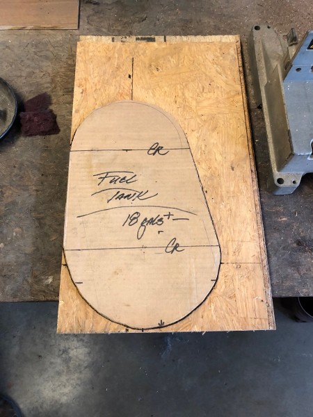

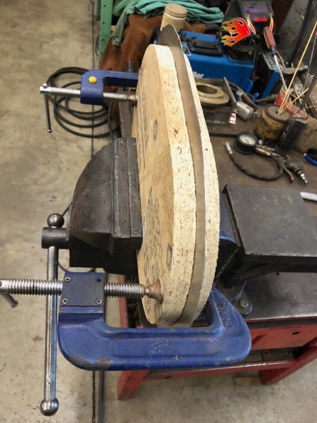

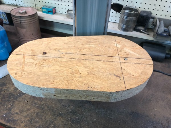

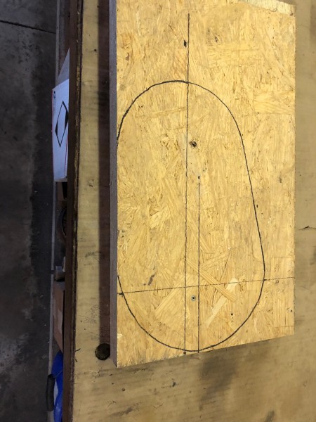

This is the pattern we decided to fit the custom Speedster.

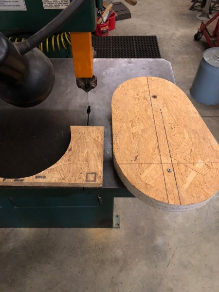

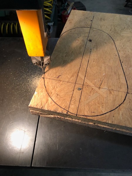

A double lay out and cut using 3/4" Advantech flooring works great.
Cutting as twins and sanding as they are screwed together.[
attachment=1]IMG_1012.jpg[/attachment]

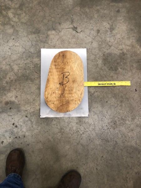

Ready to cut the sheetmetal. More coming!

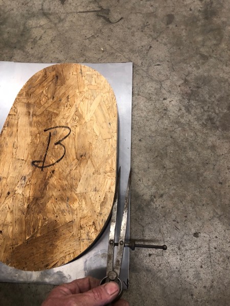

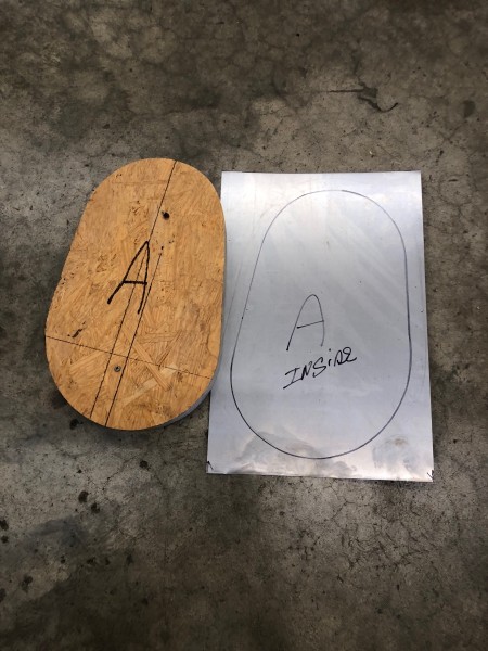

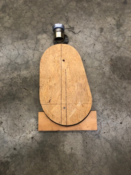

Now after 2 cups of coffee we are ready to get serious.
A general mock up of what we are producing.
Tin lay out with a one inch lip.
Double check and cut.
Mark ends as there are an A and B side.
And more coming.

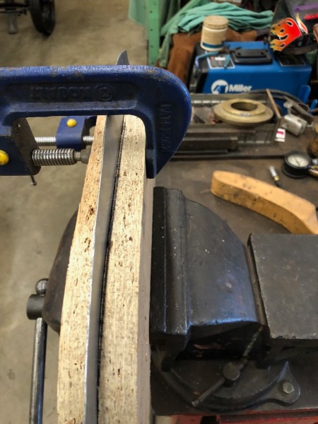

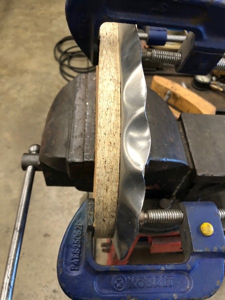

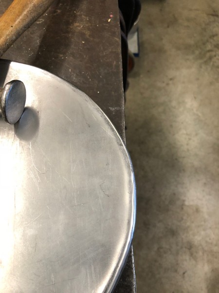

Now comes the slapping or forming, this is done with light strikes combing the metal outward. Slow moment equally around is of the greatest importance in metal forming. If you don't, you will over stretch the metal which it is harder to shrink than to stretch.
A good panishing hammer is a must, maple slap hammers are your friend too.
Still more to come.
Still more to come.

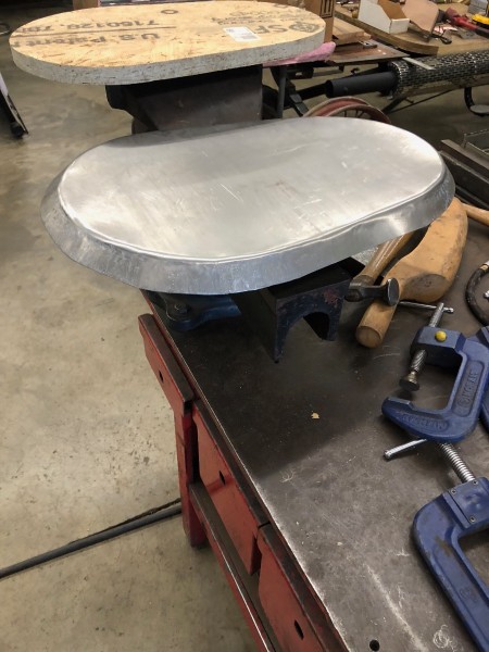

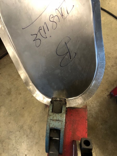

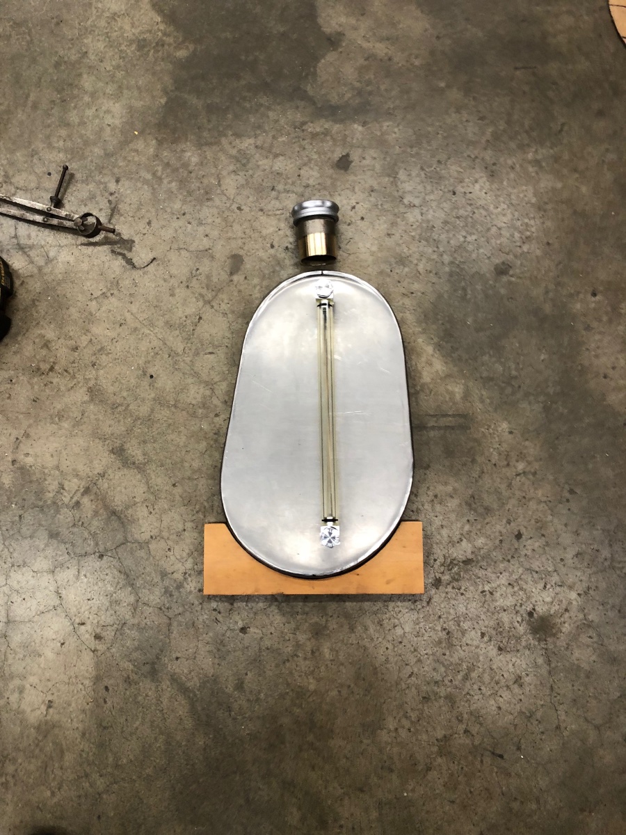

Now we are getting at the end of the day for me. My hands give out in the cold very quick, but progress is progress.
Slapping and removing at times to put into the jaws of a shrinker, if you don't have one you can notch and fold.
Yes, I cheat!
Making a good 90 degree fold over, smoothing comes later.
This will have an outside gas gauge, no sticks required. I use old larger radiator caps/necks for the gas fill area. A lot of reproduction necks/caps are a little to bulky.
Hope You All Enjoy, More to follow as time permits!
