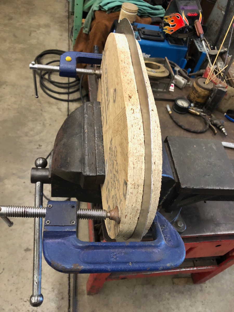

Thought you folks would enjoy seeing how sheetmetal is formed and yes, you folks have the talent, just apply yourselves.
This is the pattern we decided to fit the custom Speedster.
A double lay out and cut using 3/4" Advantech flooring works great.
Cutting as twins and sanding as they are screwed together.[
attachment=1]IMG_1012.jpg[/attachment]
Ready to cut the sheetmetal. More coming!

Now comes the slapping or forming, this is done with light strikes combing the metal outward. Slow moment equally around is of the greatest importance in metal forming. If you don't, you will over stretch the metal which it is harder to shrink than to stretch.
A good panishing hammer is a must, maple slap hammers are your friend too.
Still more to come.
Still more to come.

Slapping and removing at times to put into the jaws of a shrinker, if you don't have one you can notch and fold.Yes, I cheat!

Good work Henry. I use MDF which doesn't have the voids like the chip board that can collapse on you, especially on successive steel parts. I'll be starting my tank for the mercury next month. Since it is inside the car the shape is more to fit the space than aesthetic. It will probably be aluminum.

I use a “bead roller “. A very useful tool. I also have a “shrinker/stretcher”, which is really handy for some of what you are doing. These tools were not very expensive and really speed up the process Next time I do something like this I need to take some pictures.

Sorry for not mentioning before, 20 gauge. Will also be showing how to seal the inside as it progresses.
