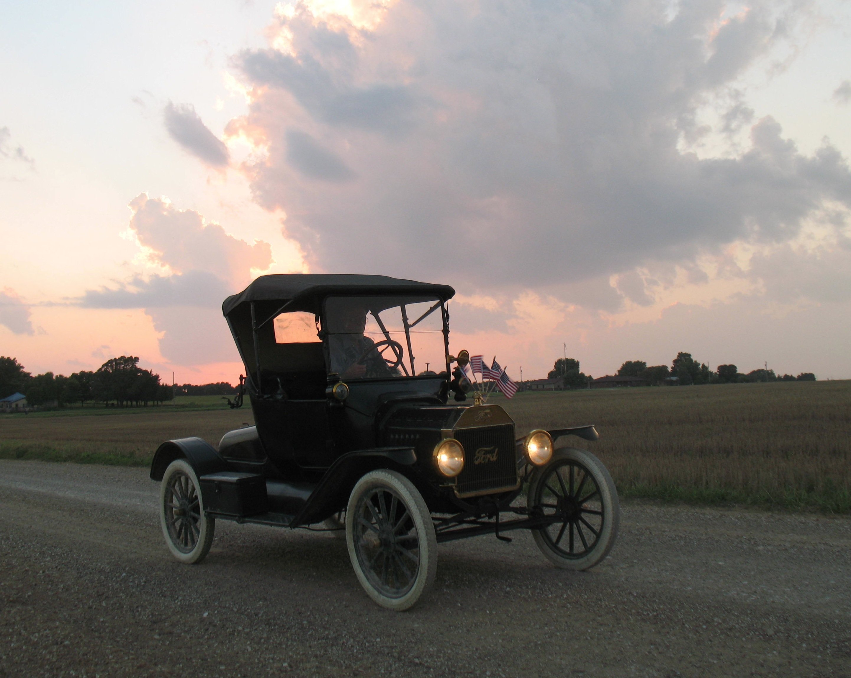

Given my experience with magneto lights, which are barely adequate under the best of circumstances, I cannot imagine them being any good at all with a dimmer. If I had one of the cars which came with a dimmer I would probably leave it in place for the "correct" appearance but bypass it. I would rather replace a bulb every few hundred miles than drive essentially blind. Of course, I could be wrong. It happened once before.
Maybe somebody who has actually driven by magneto light with a dimmer can testify on how good or bad it is.
Not terribly bright, even without a dimmer.
