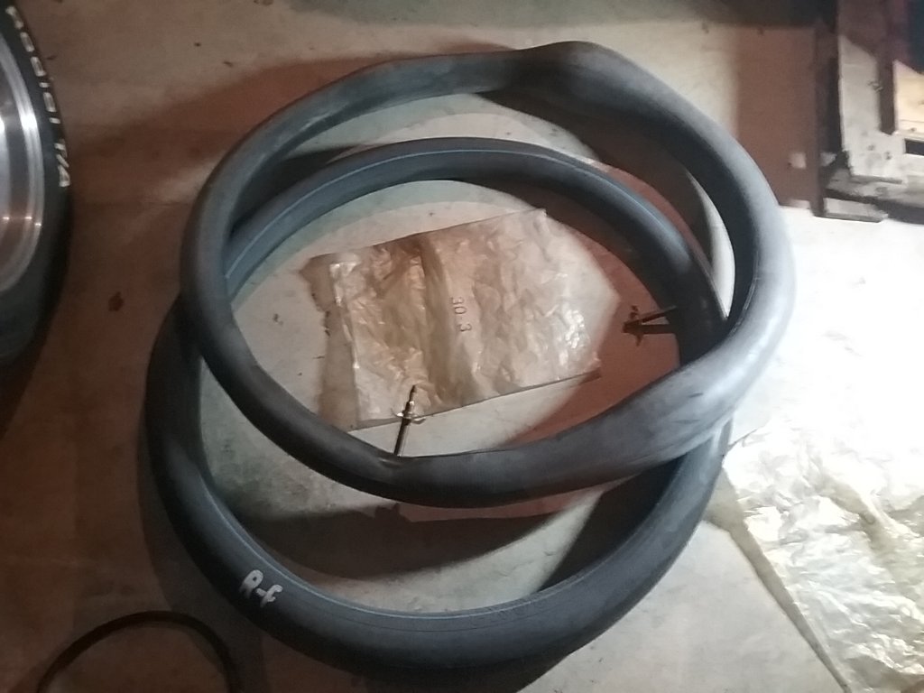

Could this end up to be a problem ????
Post by JohnnyBuick » Thu Jan 21, 2021 12:02 am
Just got these new metal stem tubes in the mail ...
Like a bad Camel they Went from 2 humps to one hump overnite..
Will these conform to the tire evenly once fitted ?
Universal seem to say they will.. your thoughts ??

Looks like a snake that swallowed a big egg. :)
Do they have a brand name? If they're not Custom Classic I would try them. If they are, I would return them.

EEC type from Universals....

The bulge indicates thin spots in the tubes. All tubes will do the same. The real concern to my eyes is these tubes are doing so at minimal pressure. They are still very skinny for the most. The older butyl tubes with which I am familiar will expand to be larger than the tyres will ever allow before there is any swelling at any one point. Is this another indication of inferior rubber supplied by the usual suspect suppliers?

I would expect that to happen after the rest of the tube has expanded beyond the tire size, not before, but of course once in a tire it is constrained. I would try it and see what happens.

Jeff is correct. An inter tube, esp. small bicycle tubes size , with thin wall the T uses, can’t take any pressure outside the tire casing. Result is the tube will expand like that several times it’s diameter.

If you go looking for problems, you are very likely to find something you don’t like. Even though the pressure is very low to almost non-existent, what you have there are tubes that have been expanded far beyond the size they would ever be inside a tire. Does that fatigue the rubber or make it porous? Maybe, maybe not...
Did the tubes come in boxes with the “Hartford” brand on them? I’ve installed at least 40 Hartford Tubes with absolutely zero issues. All those tires had flaps and I don’t add anything besides the tube, tire, and flap (no lubricant, talc, starch, soap, powder, plastic bags, or any other crutch). The new flaps come from the manufacturer with a small amount of lubricant already on them and it is exactly the right amount exactly where it is needed.

The metal stem tubes u see here came in opaque cellophane type bag and are the EEC brand..
The Hartford ones come only as rubber stem not metal stem that i know of

Some people assume that all products from China are trash, but my experience has been the same as Adam's — no problems with Hartford. I cut off the rubber stems and install metal. I have one EEC tube, but haven't used it yet.

It looks like an annurism. :lol: Only way to tell would be to use inside the tire. I don't think it will expand that far when inside. I would install them and let all the air out, then pump up again to correct pressure and do not use them on the road for a few weeks. Then take the car out and slowly drive around. Even take them on a gravel road (if such a thing is clear of ice or snow) and drive around for a while. Once you are satisfied they will hold up, then drive as you usually do. But that's only my opinion, since I have not had any tubes like that.

As Jeff said, once the tire is mounted and constrainned within the confines of the tire and inflated to the correct pressure it will be fine. I would not worry. Jim Patrick
