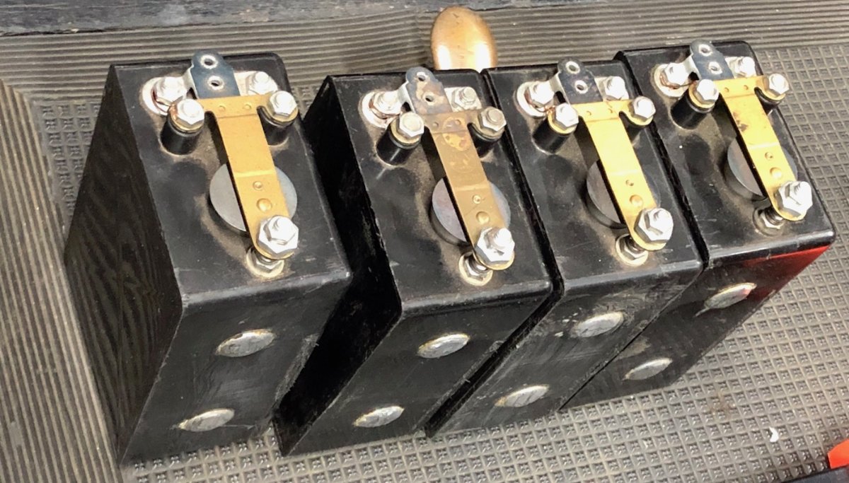

I removed the coil box on the '14 for inspection & cleaning and found a set of 4 plastic box coils. The car seems to run fine with its E-Timer and these plastic coils. I cleaned up all the contacts and put everything back together and gave it a test run, all seems well.
Are these plastic coils good reliable units or should I be looking for wooden cased ones to replace them?

Thanks for the opinions. I have no problem with the idea of getting a set of wooden cased coils eventually. These plastic ones work now and will make good spares.
The timer is an E-Timer and the points have little jump wires but not the little green fuses that the E-Timer on my '23 has. I'm not sure why the difference. The picture shows the wires but they are hard to make out.

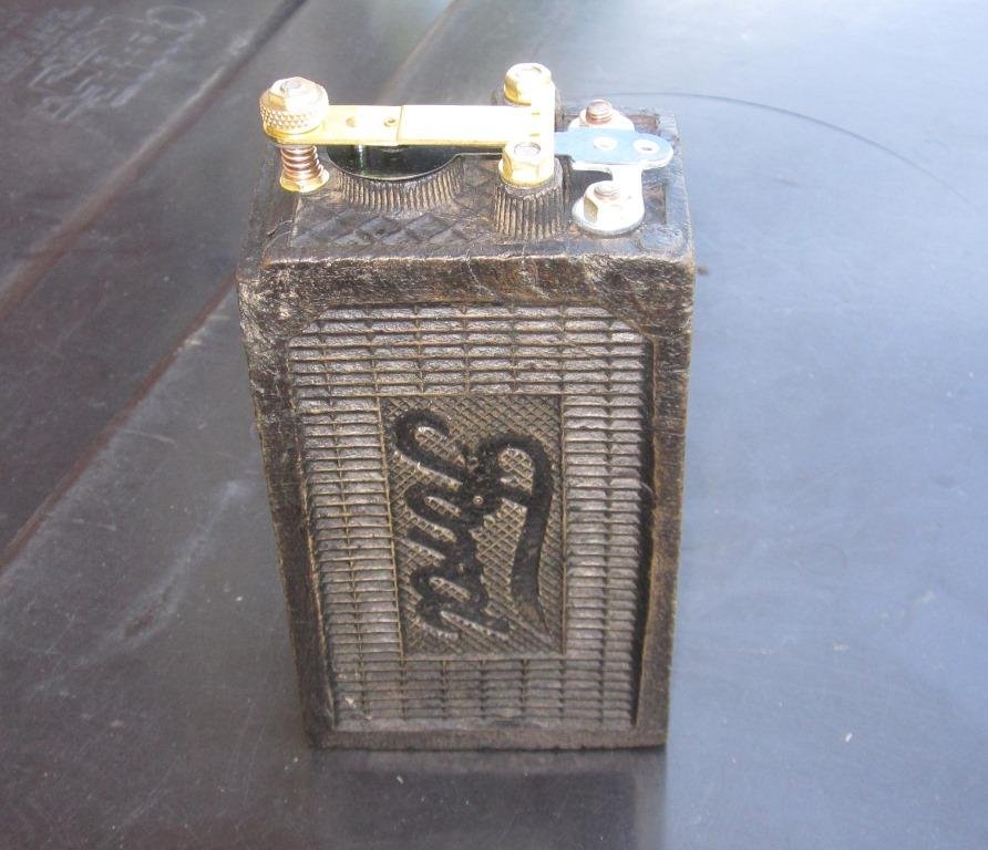

Ron Patterson
Re: Plastic Coils?
It depends upon which preproduction black plastic coils you have.
Those coils were made for various applications and many do not work in a Model T.
They were used for ignition in WWII flame throwers, jet engine test stands, oil fired home heating plants and Champion spark plug testers to name a few. Many of these will not operate correctly on the Model T magneto at slow engine speeds.
In late 1916 Ford introduced a Ford script coil (see attached photo) with the case cast from a mixture of Wheat gluten using and Asbestos as a binder. It was soon discovered that these cases were dimensionally unstable and were soon discontinued in early 1918.
If found in good condition (intact case and NOT chewed upon by rats of mice) they can be easily restored just like a wood cased Ford coil. I have several sets of these coils in like new condition.
Ron Patterson

The coil points should be shunted with the little green fuses when using the E-Timer NOT jumper wires. The reason is for safety. The fuse jumpers provide a level of protection If a timer wire were to break off and contact engine ground. The fuse jumper would blow allowing the coil to function as normal; and would buzz constantly alerting you something is wrong. That does not happen with jumper wires. High current could flow through the coil in the event of such a fault, causing the coil to melt and possibly catch fire. Do NOT use jumper wires to bypass the coil points!The timer is an E-Timer and the points have little jump wires but not the little green fuses that the E-Timer
