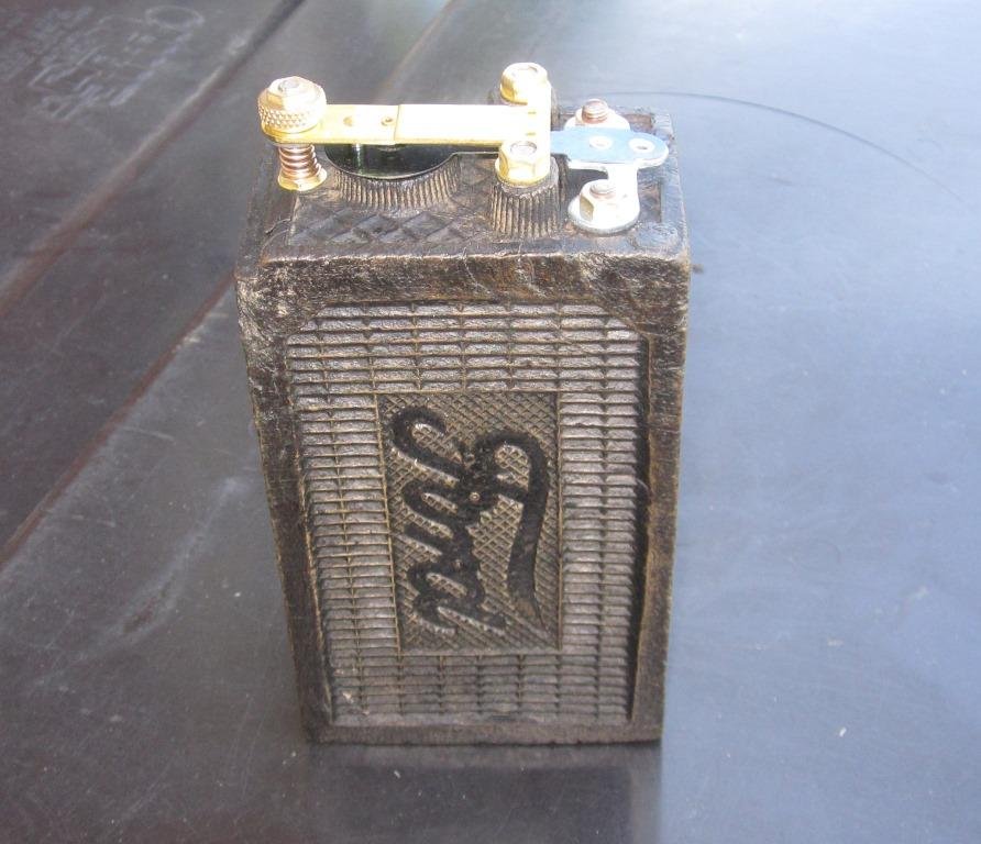

Ron Patterson
Re: Plastic Coils?
Post by Ron Patterson » Wed Jan 27, 2021 2:03 pm
It depends upon which preproduction black plastic coils you have.
Those coils were made for various applications and many do not work in a Model T.
They were used for ignition in WWII flame throwers, jet engine test stands, oil fired home heating plants and Champion spark plug testers to name a few. Many of these will not operate correctly on the Model T magneto at slow engine speeds.
In late 1916 Ford introduced a Ford script coil (see attached photo) with the case cast from a mixture of Wheat gluten using and Asbestos as a binder. It was soon discovered that these cases were dimensionally unstable and were soon discontinued in early 1918.
If found in good condition (intact case and NOT chewed upon by rats of mice) they can be easily restored just like a wood cased Ford coil. I have several sets of these coils in like new condition.
Ron Patterson
