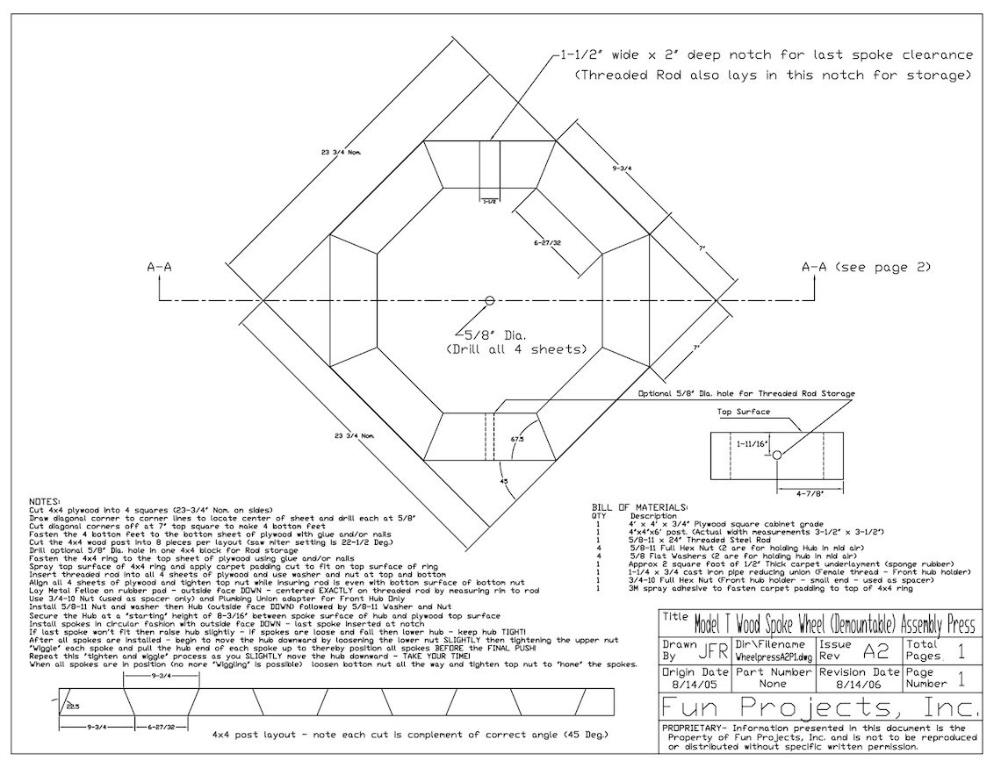

I've read a ton of posts about the Reagan press and the links to the plans all went to fun projects website which is no more. Does anyone have the plans handy? I could post it in the Photo Album section so the next victim has access...

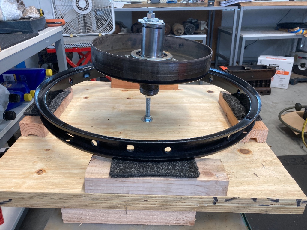

Short of that, today after a quick trip to the hardware store, I mimicked as best I could the functionality as best as I could tell from the videos and pictures. I think it'll work just fine.

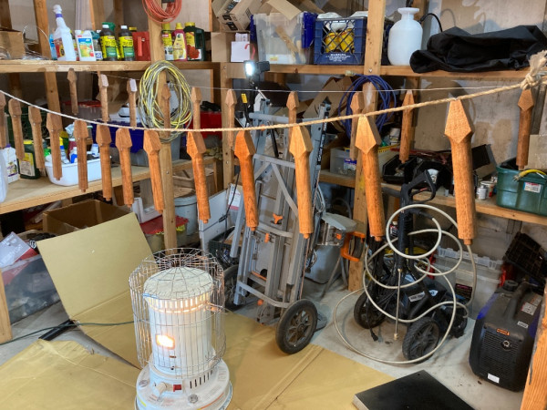

The spokes are stained and varnished and drying tonight, and I should be able to press them in on Sunday with any luck. This really is a big job. Lots of prep work to get to the goal. As an experienced woodworker, I will say I'm quite impressed by the quality of the Hickory spokes I got from Langs. A little sanding and they were good to go.

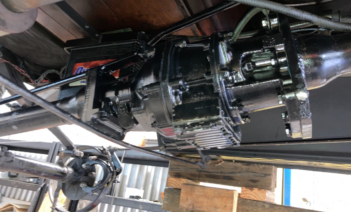

It's been a busy winter. I even got the Laycock overdrive installed. The 12v inverter works great to power the solenoid, and I get a cellphone charger for the wife as a bonus.

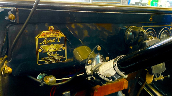

. Thanks to steve Tomaso for the 100 year plaque!

This? Jim Patrick

I made this press when I responded my wheels. It worked great on the rear hubs but the hun is longer and would not seat on the 4x4 blocks. I had to put 2x4 on top to get the height .

I looked on the Texas T (Birdhaven) website. They do have a link to free downloads, but they haven't yet migrated John Regan's old download files to the site. I sure hope that John's files aren't lost!
John, how about talking to Birdhaven about migrating your old files over, it would sure be appreciated!

What George said. You will need more space for a front wheel. See my photos here: viewtopic.php?f=2&t=18850.
