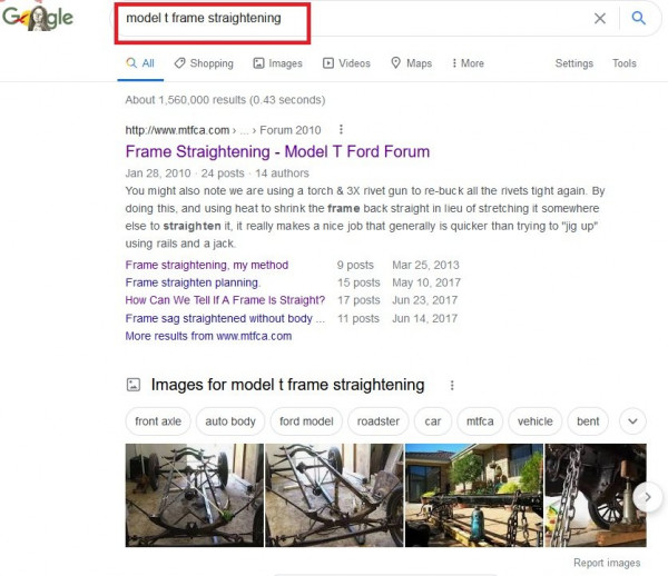

Posts: 6599
Re: Straightened my frame yesterday.
Post by TRDxB2 » Mon Feb 22, 2021 8:11 pm
