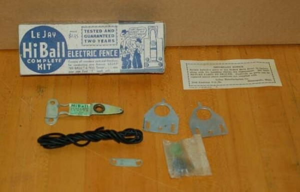

LeJay made a kit to convert an ignition coil into a fence charger.

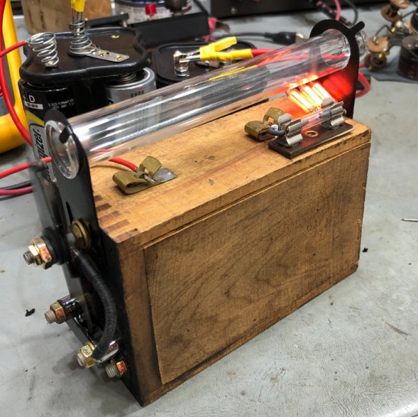

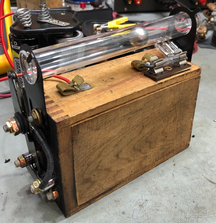

I found it in my box-o-coils and restored it.
The thing that looks like a fuse is a glass tube (from a fuse) that I put a spark gap in.
The three neon bulbs flash when it fires.

And the glass tube is from an old fuse?

The large glass tube is a laboratory test tube.
The small one is from a old blown fuse.
