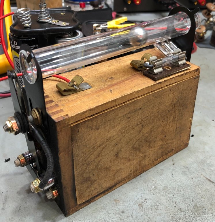

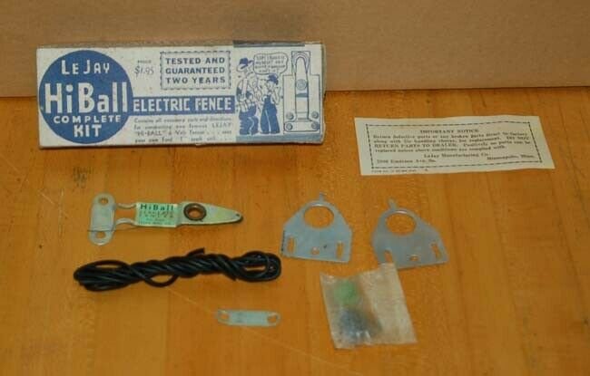

Back in the day the Model T coil was used as an inexpensive electric fence charger.
LeJay made a kit to convert an ignition coil into a fence charger.
I posted a short video of it in operation on Facebook.
https://www.facebook.com/10001288207742 ... 5556766836
I found it in my box-o-coils and restored it.

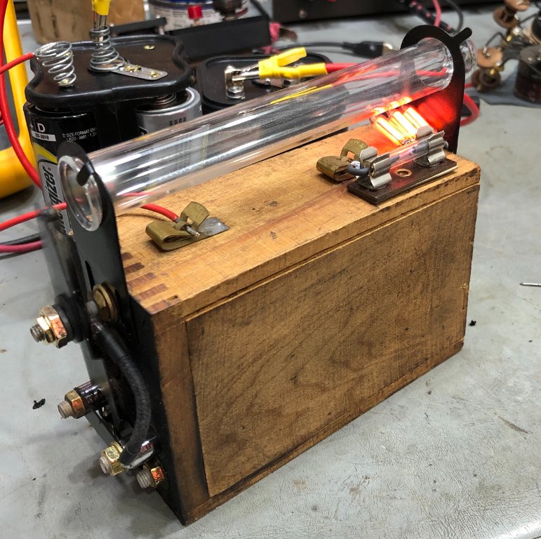

The thing that looks like a fuse is a glass tube (from a fuse) that I put a spark gap in.
The three neon bulbs flash when it fires.

And the glass tube is from an old fuse?

The large glass tube is a laboratory test tube.
The small one is from a old blown fuse.

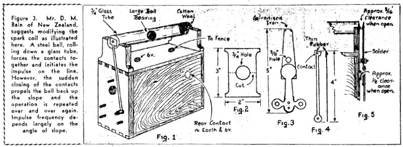

Here is a previous discussion about fence chargers with instructions.
http://www.mtfca.com/discus/messages/50 ... 1440780666
