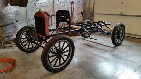

I did the frame below with a brush and rustoluem satin black...

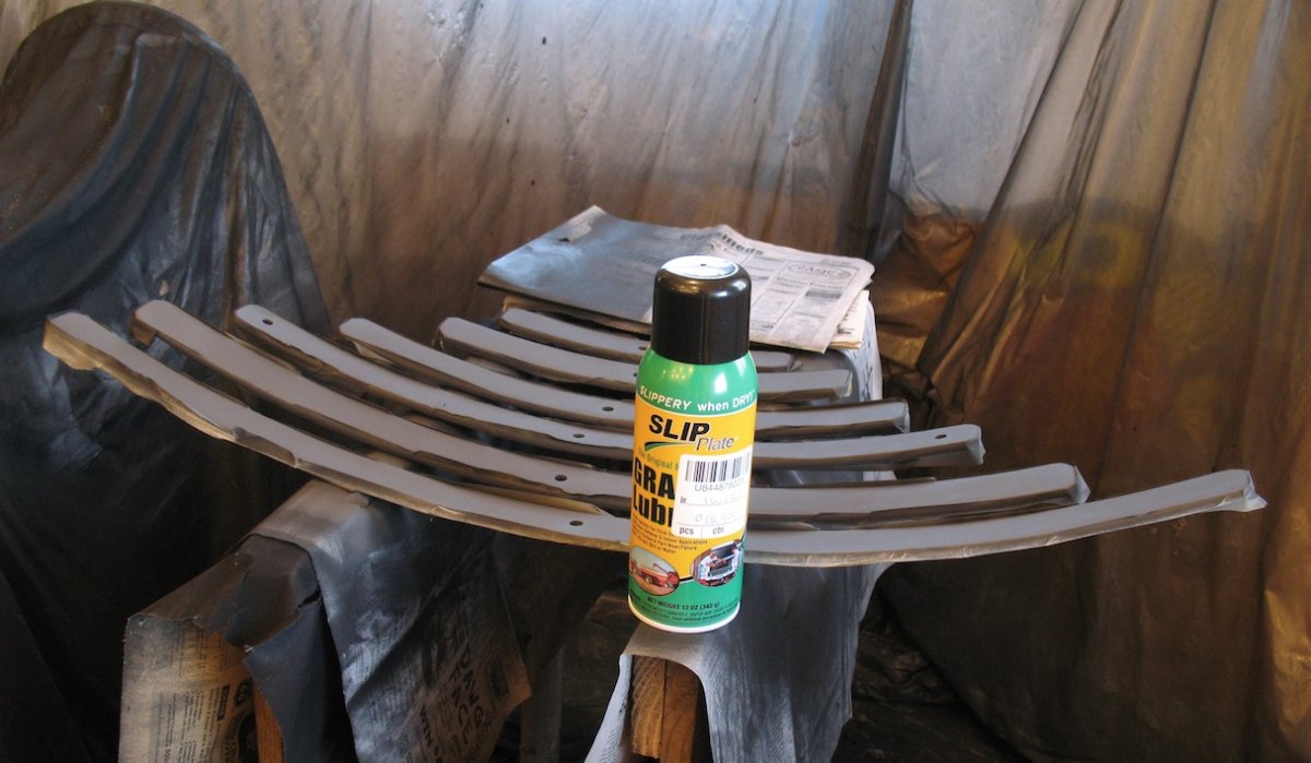

Leaf Springs Google powder coat springs MTFCA
I question the expense vs benefit .
Minimal exposed area, thicker surface/spring clamp fit,are slippery but if applying slip paint then why needed.
There was one caution on heat treating but that was dismissed just check it out with the painter http://www.mtfca.com/discus/messages/80 ... 1250956867

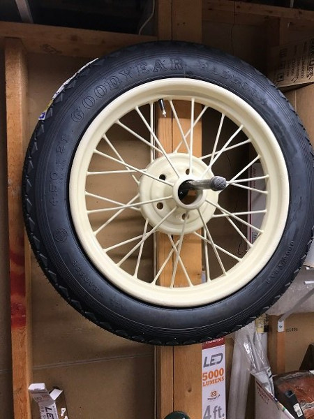

I painted these with Rustoleum Farm & Implement International Harvester White Enamel Paint - It has cured very hard and looks good and I enjoyed doing it - this is the extra spare tire. I am not wanting my project car to have an over-the-top finish, just one that looks like it might have been.

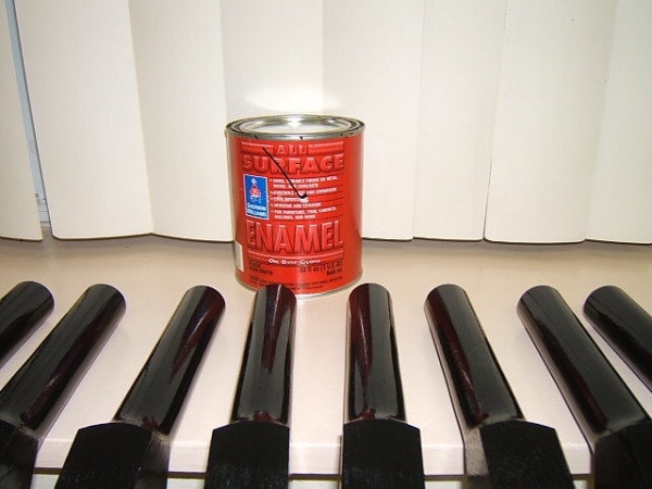

I never sandblast, because it alters the original smooth steel surface to a very rough, grainy surface. If the paint that is on there is still good, with no rust present, you can clean off the old grease and dirt with mineral spirits, sand the paint down to a new layer and brush paint with gloss black enamel. You can paint enamel over lacquer, but you cannot paint lacquer over enamel. If the old paint is too far gone, and it needs to be removed, it is best to strip off the old paint with Jasco gel type paint remover with a wash of lacquer thinner. If there is any rust under the paint, clean with several applications of Muriatic acid and once all the rust is off, neutralize and flush well with a mixture of baking soda in water until it stops bubbling. Make sure to allow the baking soda solution to seep in under the riveted joints to neutralize the acid between the joints then rinse with clean water. To prevent flash rust from forming after rust removal, dry with a towel and quick dry using the high setting of a heat gun. About 1,200 degrees F.
Best to apply primer and paint by brush in order to dab the coatings into hard to reach places under riveted parts. Spray coating these hard to reach areas may leave bare spots. Brush Prime with a good quality Red oxide primer such as Porter Paints red oxide primer and brush on a good gloss black enamel. I like Sherwin Williams gloss black enamel as it levels out very smoothly when brushed on. Gloss is best because it is very smooth and slick which sheds dirt, road grime and oil film more easily. Jim Patrick
PS. In the below photo, the spokes were brushed with the gloss black enamel and you can see how well the enamel leveled out to a smooth shiny surface without brush marks.

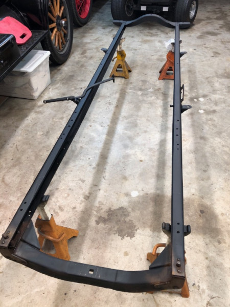

I've always painted chassis parts with satin black Rustoleum from a rattle can. (I think glossy paint on a chassis looks ridiculous.) I use two coats with no primer, and it's fine. I think sandblasting chassis parts is OK. In fact, I believe if you sandblasted one rear axle housing and used paint remover and rust remover on the other, after they were painted you couldn't tell the difference.
Some people paint the springs as a unit. I take them apart, paint the individual leaves, and apply Slip Plate on the bottom of each leaf above the bottom one.
