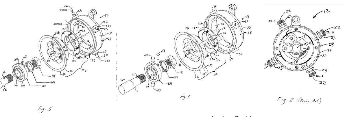

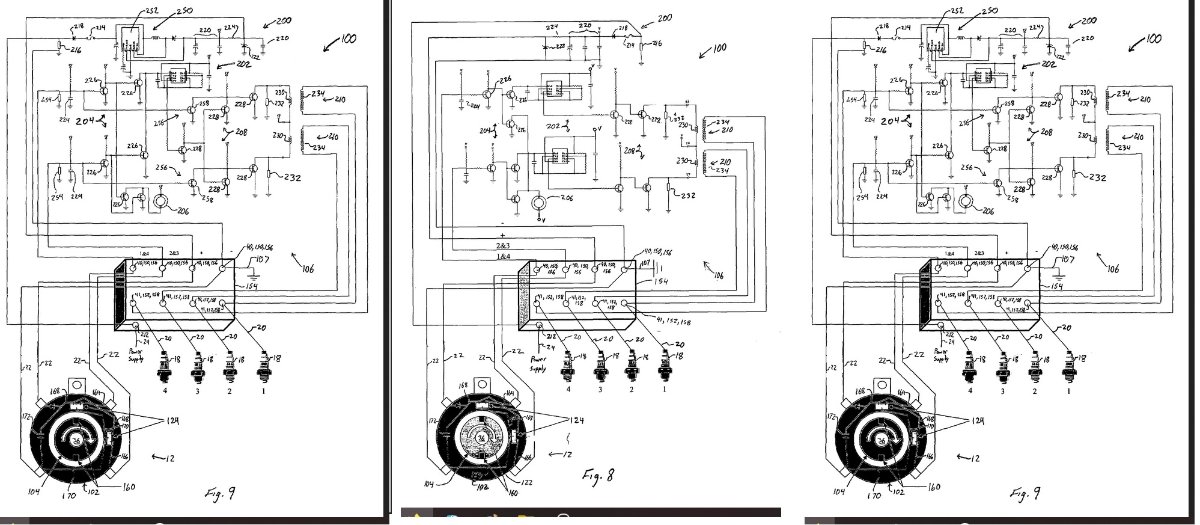

You might have missed this link that was in one of the past forum posts mentioned above https://patents.google.com/patent/US6976482walber wrote: ↑Fri Mar 26, 2021 1:38 pmMark,
Just checked back with my friend, turns out the rotor is lost. By chance do you have a spare?
I've been in touch with Jim Golden, a wealth of information about the system. He sent me a variety of documents about the system and I have forwarded them to my friend.
Walt
It has the patent diagrams of the timer etc

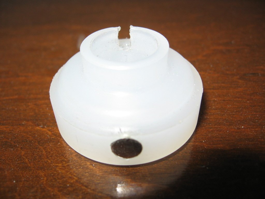

Jim, if you still have those dimensions, could you publish them here? Somebody with a 3D printer could probably do a run of them.
I measure my rotor as 1 3/8 inches in diameter and 13/16 inches in height. It has two small cylindrical neodymium magnets embedded in the periphery, 180 degrees apart. One of the magnets is lined up with the slot in the nose of the rotor that the timing pin fits into. Each magnet is about 1/4 inch in diameter and 1/4 inch tall. They are pressed into the plastic so that they are flush with the surface.

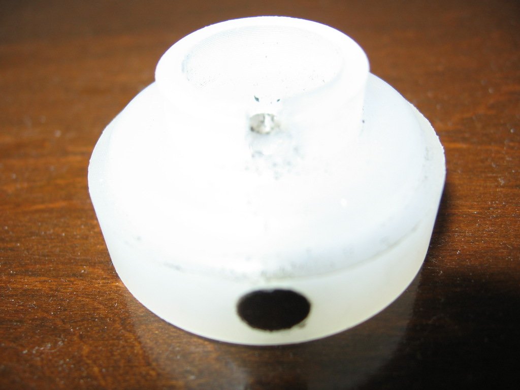

With the info you all posted here, I am able to fabricate the only missing piece : the lost white plastic rotor with 2 magnet parts piece. The rest of my True fire can work again. I had removed it when I got my T, it was working. But it rolled away !
In reverting to wood coils I found spark gaps at about .045, rod lengths were wierd, etc etc. And my T would not hardly move in low gear.
Here is the information I got from you all here I needed :
A closeup picture of the white plastic, a reference dimension, notch and pin hole relative positions to magnets and rotor shaft, number of magnets, rough sizes, that they are rare earth neodymium, flush, and type of NS polarity pointing outwards to a needle compass ! I can now Make it !
Yayyyy Thank you forum please, I have not been able to post there. I thought a T had reverse, Lo Hi, 3 speed transmission, so I could not join.
Sincerely, a Very grateful, less demoralized new T owner...
Bill Jensen

Glad you were able to post! If you make one for yourself, how about making a run of five or so? Just from the OP and other folks that have posted in this thread I think you would sell them pretty fast.

I could use two or three of those too, as I have two systems that did a melt down from excessive heat.
I didn't keep the measurements for that part and I forgot who was going to try to make some of them.
He had already purchased the magnets, so they are available.
I have a test set that can test a new rotor.
Moving that notch slightly could eliminate the problem of trying to stretch the spark rod.

You need two rotor magnets, as the TrueFire only has two Ford Waste Spark coils.
The engine ties two spark plugs together in series, 1 and 4, or 2 and 3, for each spark delivered.
So whenever 1 gets a spark, it is shared with 4 and vice versa.
Only one cylinder is coming up with a gas load waiting to fire just before the time it hits top dead center.
At the same time, the other cylinder is pushing the burnt gas out with the exhaust valve open.
That is considered the "waste spark" cylinder, as nothing happens there, unless the spark is late, and the cylinder has started down, with the intake valve open.

"The engine ties two spark plugs together in series, 1 and 4, or 2 and 3, for each spark delivered.
So whenever 1 gets a spark, it is shared with 4 and vice versa."
I think it's actually two plugs in Parallel, small detail except in Parallel one fouled plug does not compromise spark in the other as would be the case in a series circuit. Best, jb
**4/30**
Jim: My bad, thanks for the respectful correction, plugs fire in series as you stated. Best, jb
**4/30**

As Mark mentioned above, I've been working on making some replacement rotors. With a couple prototypes made and tested, I will be able to make a few more if there is any interest. I'll add a post on the Classifieds - Parts section of the Forum. In the mean time, if you have an interest you could contact me at wberdan at comcast dot net.

James, they are in series and connected together by the engine frame, look at the patent.
That makes the spark gaps have to be equal to equally share the spark.
The Ford Coil supplies about 9,000 AC Volts that is equally divided.
