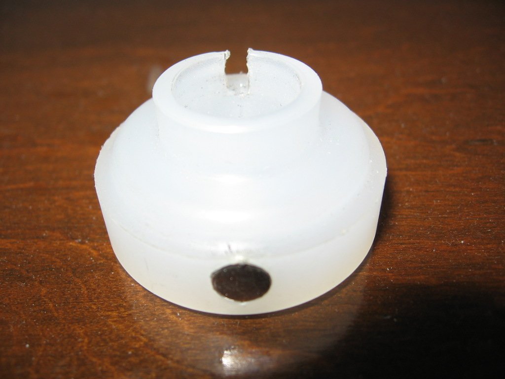

Jim, if you still have those dimensions, could you publish them here?  Somebody with a 3D printer could probably do a run of them.
I measure my rotor as 1 3/8 inches in diameter and 13/16 inches in height. It has two small cylindrical neodymium magnets embedded in the periphery, 180 degrees apart. One of the magnets is lined up with the slot in the nose of the rotor that the timing pin fits into. Each magnet is about 1/4 inch in diameter and 1/4 inch tall. They are pressed into the plastic so that they are flush with the surface.

Bill Jensen here, friend of Walt Berdan near me...
With the info you all posted here, I am able to fabricate the only missing piece : the lost white plastic rotor with 2 magnet parts piece. The rest of my True fire can work again. I had removed it when I got my T, it was working. But it rolled away !
In reverting to wood coils I found spark gaps at about .045, rod lengths were wierd, etc etc. And my T would not hardly move in low gear.
Here is the information I got from you all here I needed :
A closeup picture of the white plastic, a reference dimension, notch and pin hole relative positions to magnets and rotor shaft, number of magnets, rough sizes, that they are rare earth neodymium, flush, and type of NS polarity pointing outwards to a needle compass ! I can now Make it !
Yayyyy Thank you forum please, I have not been able to post there. I thought a T had reverse, Lo Hi, 3 speed transmission, so I could not join.
Sincerely, a Very grateful, less demoralized new T owner...
Bill Jensen

I could use two or three of those too, as I have two systems that did a melt down from excessive heat.
I didn't keep the measurements for that part and I forgot who was going to try to make some of them.
He had already purchased the magnets, so they are available.
I have a test set that can test a new rotor.
Moving that notch slightly could eliminate the problem of trying to stretch the spark rod.

Walt Berdan is making good progress on a home made run of replacement rotors, I expect an announcement from him soon.

I do not have the rotor size figures either, but I could measure my last new one again and get them.
My TrueFire test set still has a new rotor for comparison with others I test.

As Mark mentioned above, I've been working on making some replacement rotors.  With a couple prototypes made and tested, I will be able to make a few more if there is any interest.  I'll add a post on the Classifieds - Parts section of the Forum.  In the mean time, if you have an interest you could contact me at wberdan at comcast dot net.
