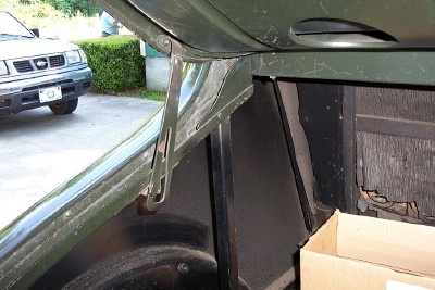

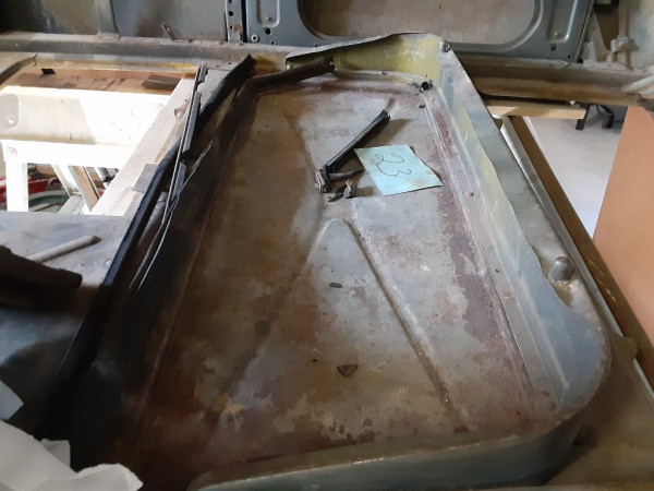

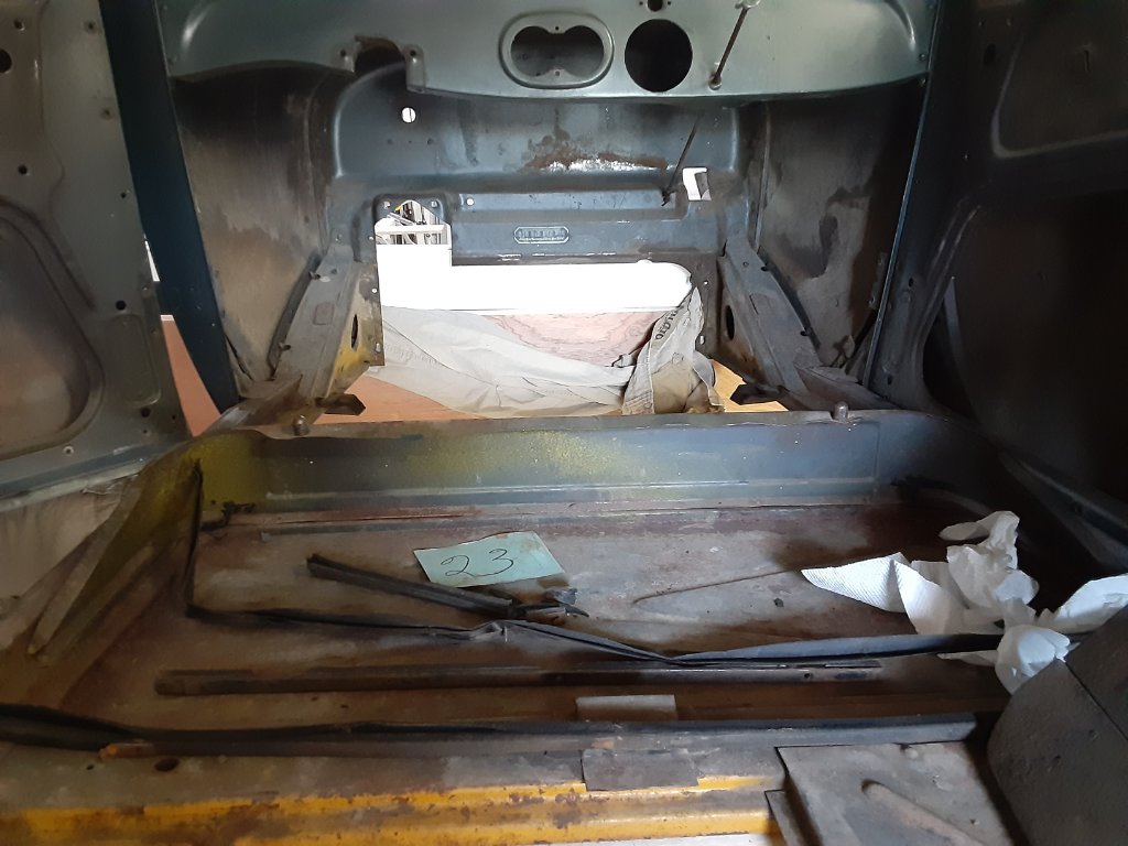

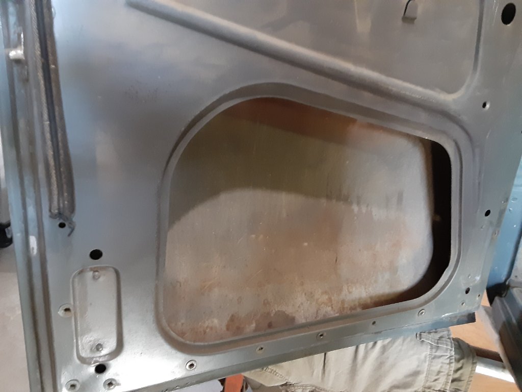

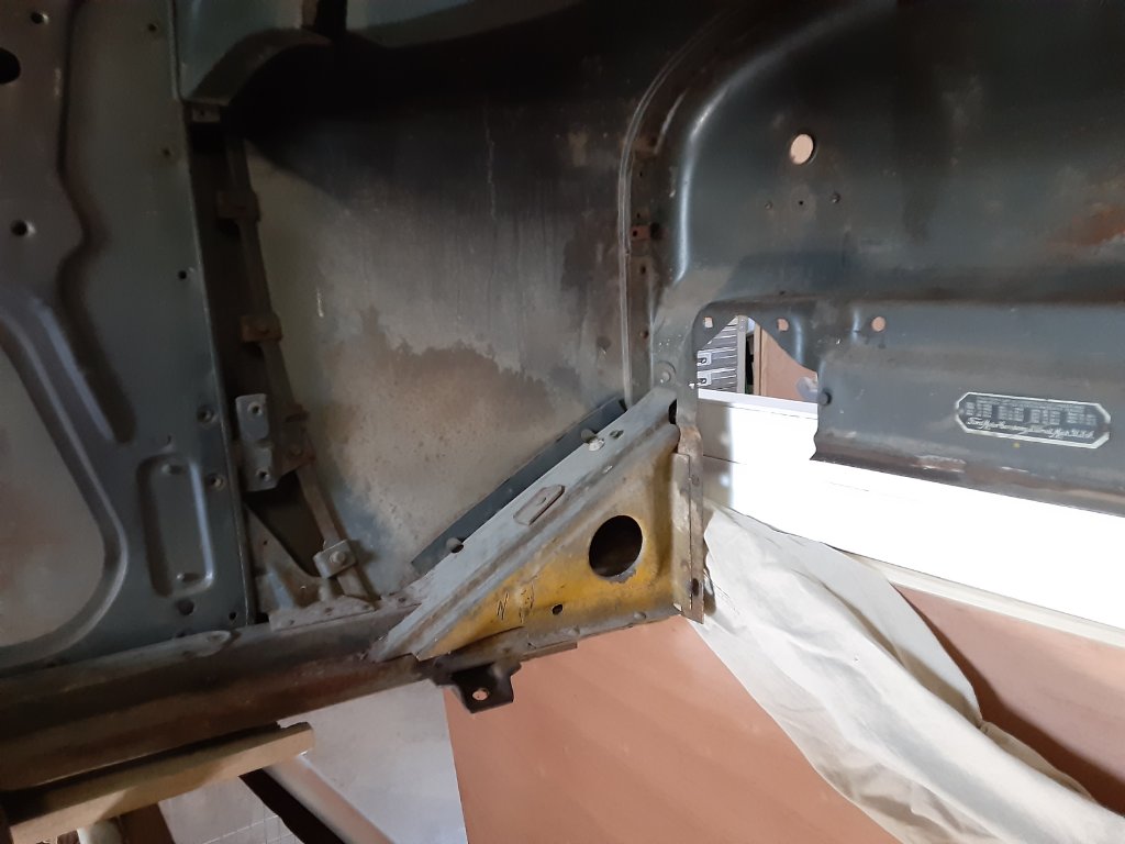

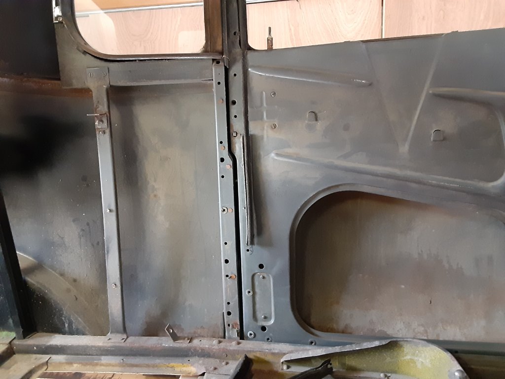

I am trying to decided how to paint the inside of my coupe. The attached photos show the condition of the inside. I would appreciate comments about preparation/types of paint etc. I am not familiar with POR-15 or such paints, so any comments about them would be helpful. Was the inside the same color as the body paint?

Opps! I posed one twice! Here is the other one.

Be careful. From what I see, you may have the only totally original 1927 factory painted Channel Green Model T coupe in existence. I thought it when I first saw it and I think it even more now that I have seen the inside. If you paint over it, you may be destroying the only true samples of original Channel green in existence. Anyway, I would not touch the body, much less paint over the paint you have there. If you have not done anything to the exterior, please consider not painting it. That paint and body is in great original condition. Jim Patrick

We have an October 1926 coupe which is totally destroyed, unlike yours, and is going green on the outside and black on the inside. But I respect Jim Patrick, having seen his posts over the years that have helped me. Not only do I agree with his suggestion, but I think that your car is beautiful.

That body is in remarkable condition. I'd clean the interior surfaces very thoroughly, paying particular attention to the places where dirt accumulates and rust starts. If needed, I'd spot-treat those areas and leave the rest as-is. Most rust prone areas are interior spaces and joints around the lower part of the body.

I would do what I am doing to restore my very rusty '26 coupe. Since I don't have convenient access to sandblasting services I'm wire wheeling and sanding loose rust and using Rustoleum rusty metal primer and a brush. I thin the primer for the seams and encourage it to flow into the joints. I will brush paint the interior areas that don't show with rustoleum black and have the visible areas and body exterior sprayed Channel Green, if I live that long. I'm building a driver, but given the superb condition of your car, you may have show car in mind and in that case, brush painting anything would be wrong.
Don Booth used to post a lot of information on the improved cars he restored over the years, including a couple of coupes. He used a primer called Rust Bullet which may be sprayed or brushed. I ordered some but have yet to try it. He mentioned thinning it a bit and brushing on liberally and with low pressure air jet 'encouraging' the primer to weep into seams and channels in the body to protect places normal spray painting couldn't reach. His posts are worth looking at in this regard.
I have no association with any products mentioned, all the best, jb

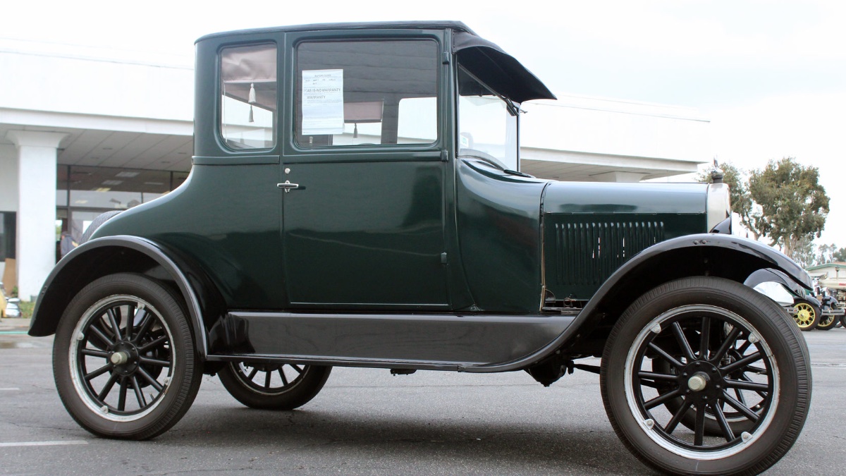

Jim, Would the last photo be what is thought to be "Channel Green'?

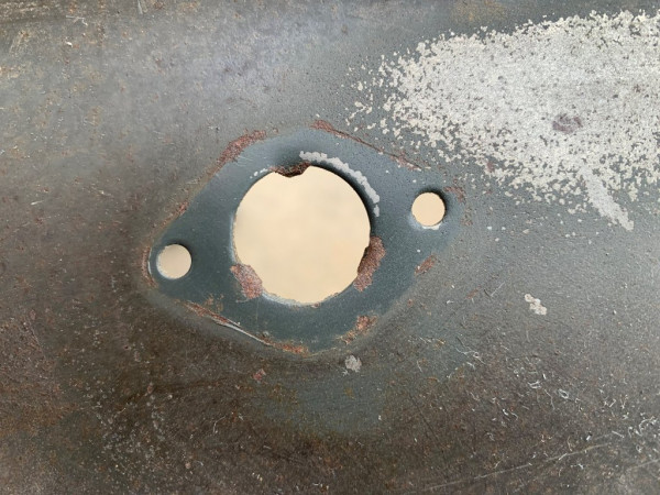

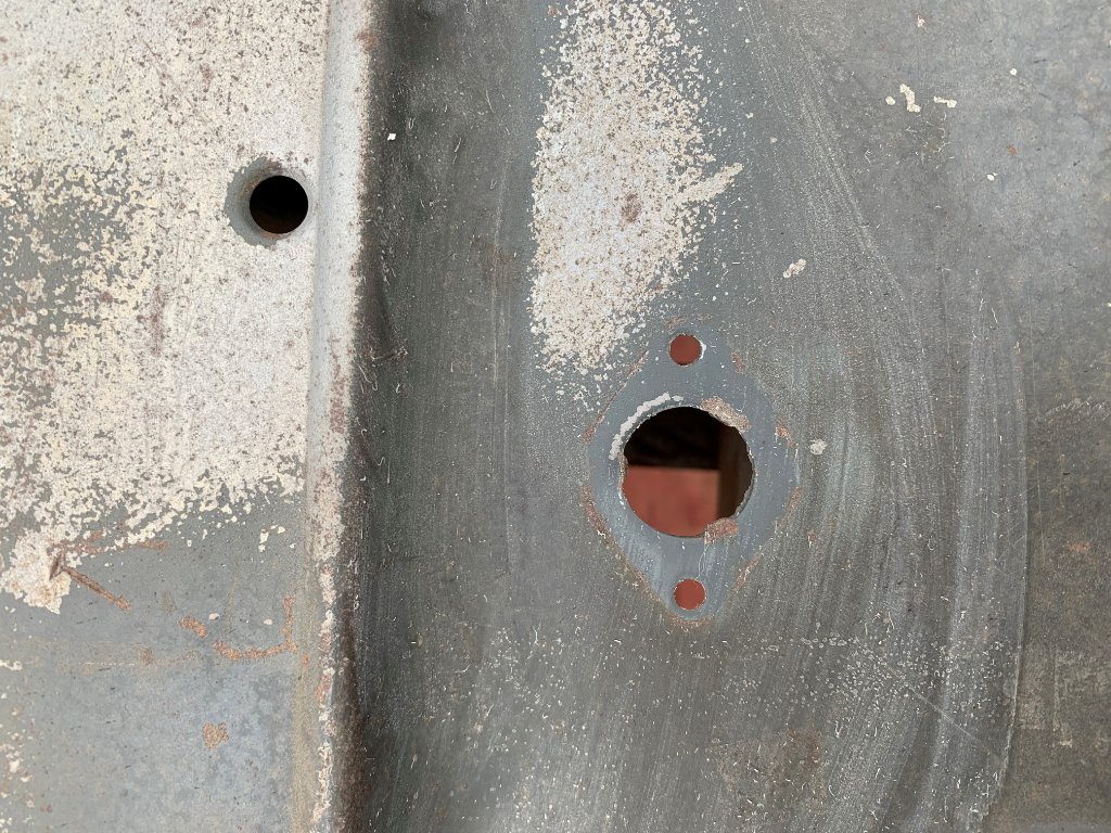

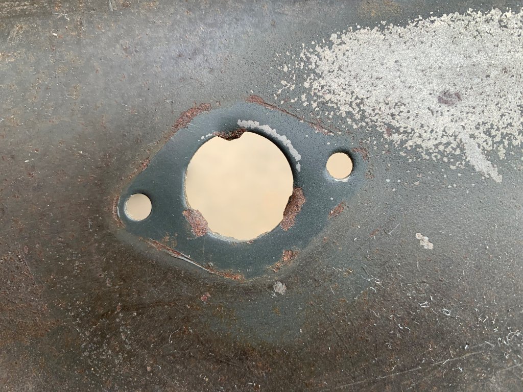

Could you post measurements of the position of data plate.

Yes. But that is only my opinion based on the fact that, to me, the color of the coupe in the last photo very closely matches the Channel Green color of the cars represented in the artist rendering in the four 1926-‘27 Ford ads, which are the most accurate depiction of Channel Green. Unfortunately, I do not know the brand or number of the paint applied to the coupe in the photo. Jim Patrick

John-The data plate location on my unrestored '26 coupe (Bruce's 3rd photo) is centered side to side on the lower firewall and the two rivet holes are 2.25 " above the lower edge of the firewall. The rivets are split end brass, about 1/4" long. jb

If you have a 1926 or ‘27 coupe, the holes should be there. When I bought my ‘26 coupe, the plate was missing, but the holes were there. Perhaps they are covered with old grease and dirt and can be found by probing with an ice pick. Jim Patrick

When looking at the photo's of the provided it appears to be a much lighter color green than what others have referred to as "Channel Green". So I am just asking if there is some agreement to the shade (light or dark) of "Channel Green" NOT the actual color. Next Photo http://www.mtfca.com/discus/messages/29 ... 1201310982 Next photo

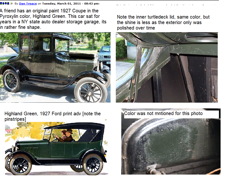

My coupe seems to be lighter than those shown but 90 years of Montana weather may have made a lot of difference. I took a couple photos of the door jams last night but the don't show the color all that well.
There is green in the trunk but also what looks like maybe blue primer??????

For 94 years it has needed nothing done to the interior. I don't see any reason to intervene now. If it were mine, I'd be very happy with how it is and do nothing but clean it up a bit. (Maybe paint the bottom of the under-seat compartment Rust-O-Leum flat black, but that's all!)

Original Highland Green from a 1927 coupe
This lacquer paint in Highland Green, was Ford M-633. The earlier enamel was Channel Green, Ford M-392.
There was a lacquer in Channel Green color, but was known as Drake Green, Ford M-637
Also a lacquer in Commercial Green, Ford M-608
Based on the available lacquers in these colors, one would assume enamel paint colors were gone by 1927. Except of course black enamel oven dry, that was on chassis and sheetmetal.
