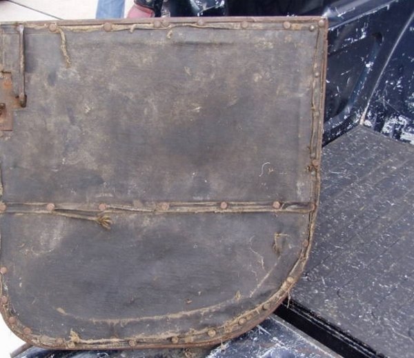

Does anyone have any good detailed photos of either original or correctly reproduced 1915 roadster door and kick panel? I am considering redoing mine and would like to be as accurate as possible. I found this photo online of what looks like an original, but would like a little more detail if anyone can provide it. I am looking particularly at the hole that the latch handle comes through and the edging trim. Thank you.

Chris,
Your image looks like an excellent guide.
Most "inaccurate" upholstery mistakes are trim "tacks" (they are actually called nails) that are too close together, upholstery that is not pulled tight enough, or upholstery that is overstuffed.
On my 1915 I Have a small arc shaped opening where the handle comes through. I can't take a picture right now. I hope someone else can.

Thanks for the responses. The photos in the link Mark posted have good detail on the tacks and trim. The 1915 door latch is a little different than the later one shown in the pictures Mark posted. The movement of the handle I think is less on the 1915 and so I am wondering if the hole is a different shape. I am guessing the trim around the hole is similar, but if someone has a picture of the hole with a 1915 door latch that would be great. Also does anyone have any more detail on the horizontal tack strip running halfway down the door? I am assuming the driver side mimics the passenger side with the false door.

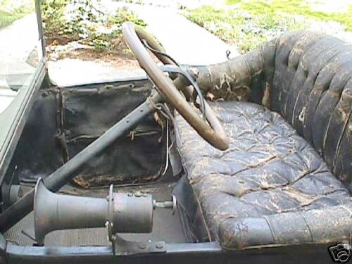

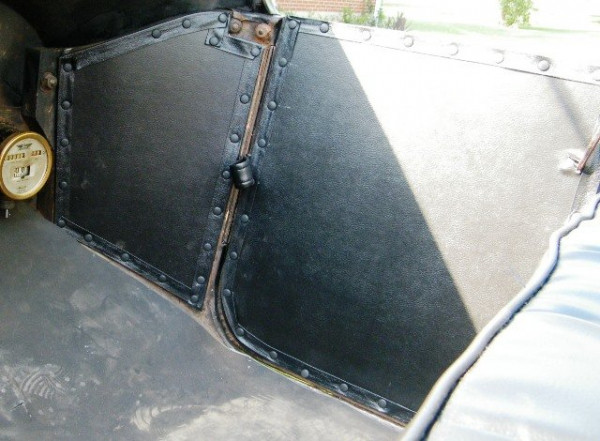

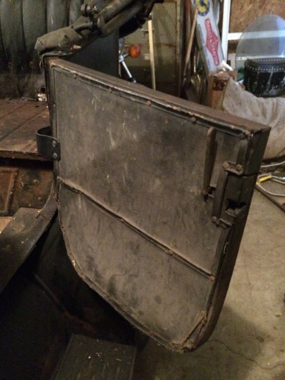

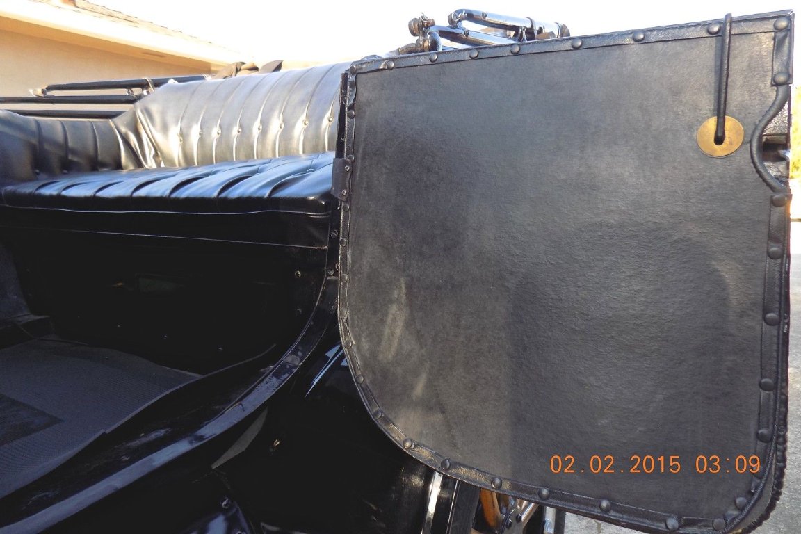

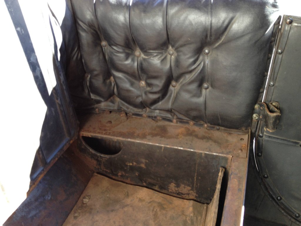

I collected these photos off of the forum to use as a guide when I installed my kick panels. 1915 may be a transition year for the door latch mechanism, so the handle detail may vary depending on the latch mechanism you have.

Thanks Wayne, those photos answered my questions.
