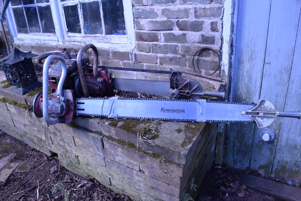

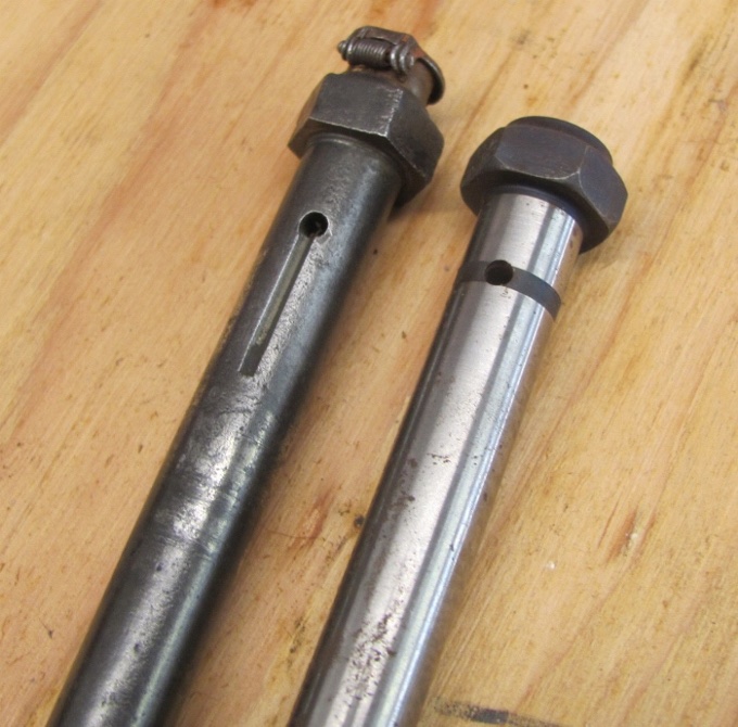

IMO, stay with oil. The king pin design is for an oil groove to drip oil to the upper and down to the lower bushing. Grease will harden and pack the oil hole.
And the repro modern king pins have little groove around the circumference, unlike the Ford vertical groove that really seeps oil down the shaft.
Grease won't do the job. Some get around that by drilling and adding a grease zerk fitting to the spindle body, that may help, but oil is still best.
IMO, chain saw bar oil is good to use, clings and drips ok, with less running than typical engine oil in the oil can.[/b]

To use grease the bushes must have grooves or channels on both surfaces to encourage the spread of lubricant to all surfaces. Oil, on the other hand, will form a film on pins and bushes with a smooth surface. I think many nipples are used with a heavier or stickier oil rather than grease.

FWIW, bar oil or way oil is perhaps heavier than automotive motor oil, but is not heavy per-se. It is tacky due to modifiers which are intended to keep it from running out of or off of whatever it's put on. I believe that it is ideal for this use on a Model T in this manner and is my lube of choice.

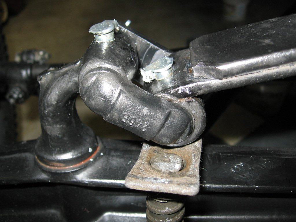

I use chain saw bar oil in the oilers for my spindles, but I pump grease into the oilers for the shackles until I see grease squeezing out both ends. I use a large grease needle with a rubber tip that seals against the opening of the oiler. I use the factory jack to raise each shackle enough for the grease needle to reach both oilers.

The clearances for the spindles do not lend themselves to grease. Oil is the best thing to use for spindles. A few drops every time you drive is what is needed.

The only place on my car that I’ve retrofitted grease fittings is inside the dope cups
