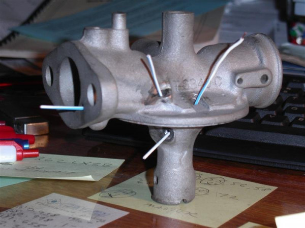

Here is a shot of a NH T Body at the Idle Circuit.. Plug you drill out is on the Flange, the Holes you get the Crud out of are in the Throat.. DO NOT MAKE THEM BIGGER.
You can also see the Bushing I installed in the T Shaft Hole.. One is a Through Hole, and one is a Blind hole.

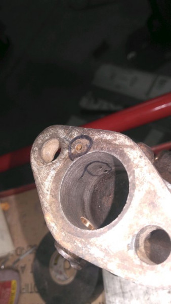

Revisiting the Picture I posted..
It's not the Passageway that plugged up, it's the Throttle Body Ports that caused my Idle Issues.. as the First time I went into the Car, I only did the Bushings, Shafts, and Float Level.. Better but not good.. Then I Drilled out the Plugs and Rodded the Passages.. I was leary of Messing with the Idle Ports.. Put it back together and the Performance was the same..
The Third time I went into it, I 'Reamed' the Idle Ports to get the Rust off the Holes.. That was the Cure for THIS Carb..
