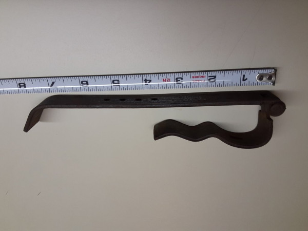

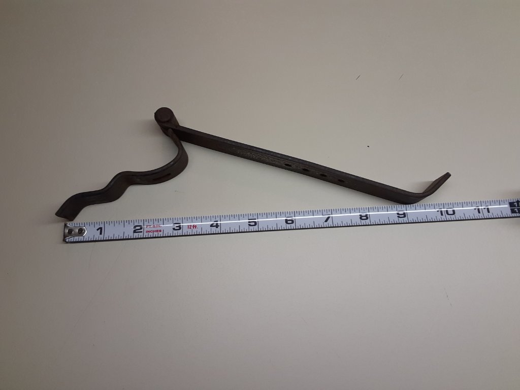

Anyone know what these Apco brackets are for ?

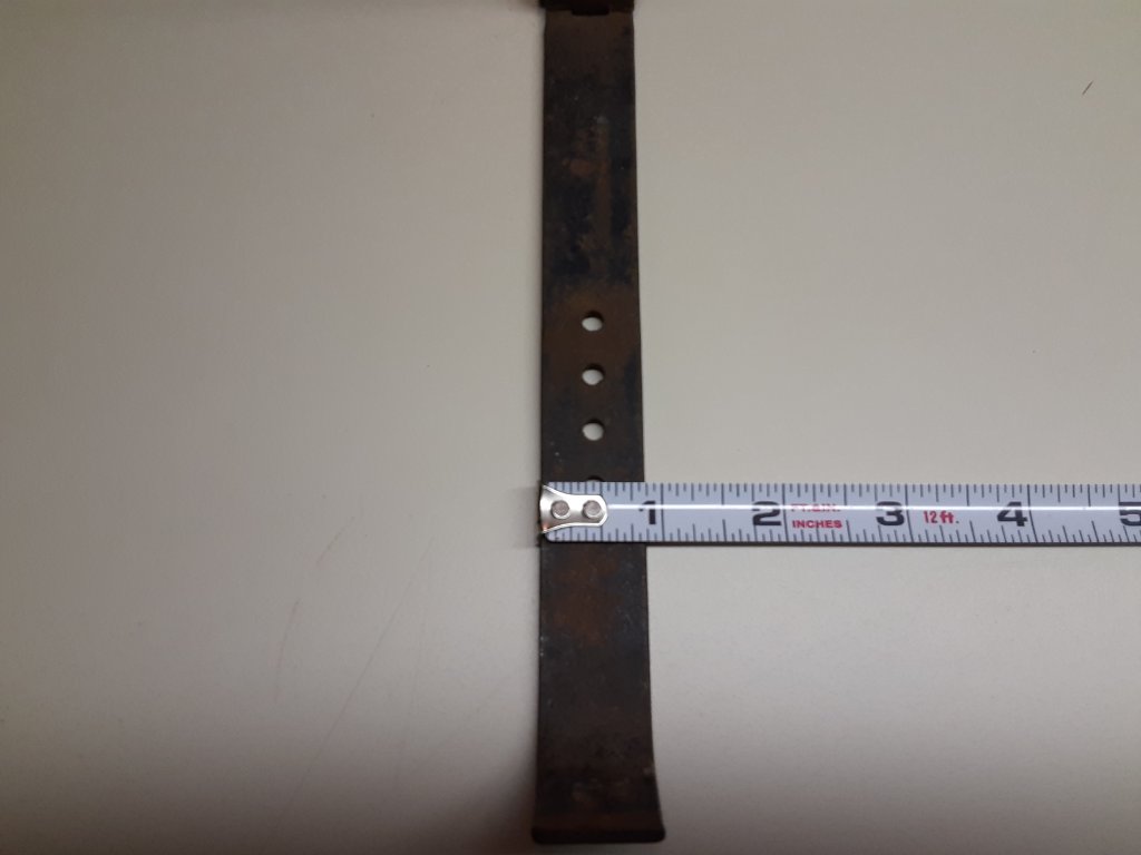

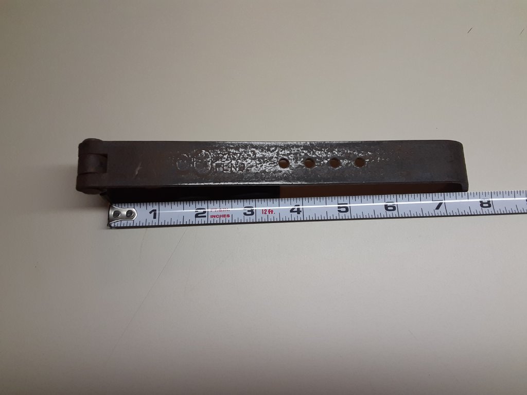

Where are they stamped APCO and what are the dimensions?

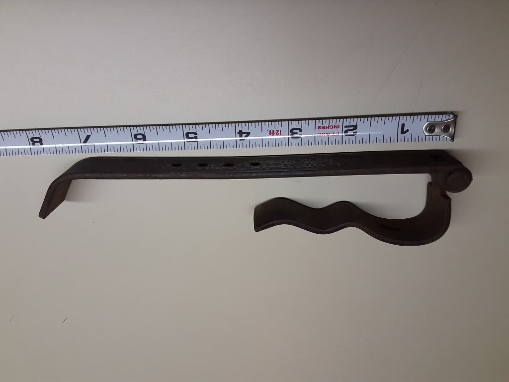

Trying to vision how it might function - it appears to be hinged, can it open all the way back or just part way.

Apco stamp

This is as far as it opens up.

More dimensions.

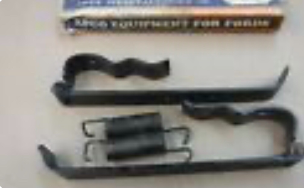

Those are the bracket pieces for a set of APCO Shimmy Stops. Fit around the drag link and tie rods with coil springs for assist.
Photo is poor, but shows portion of box of a set of NOS ones.

NO MORE CALLS PLEASE, WE HAVE OUR WINNER !
