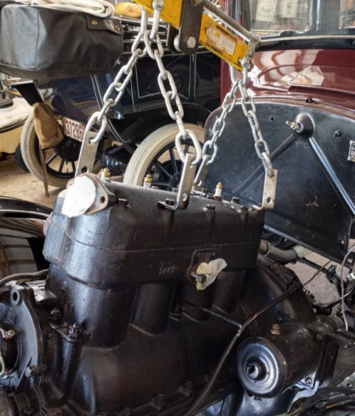

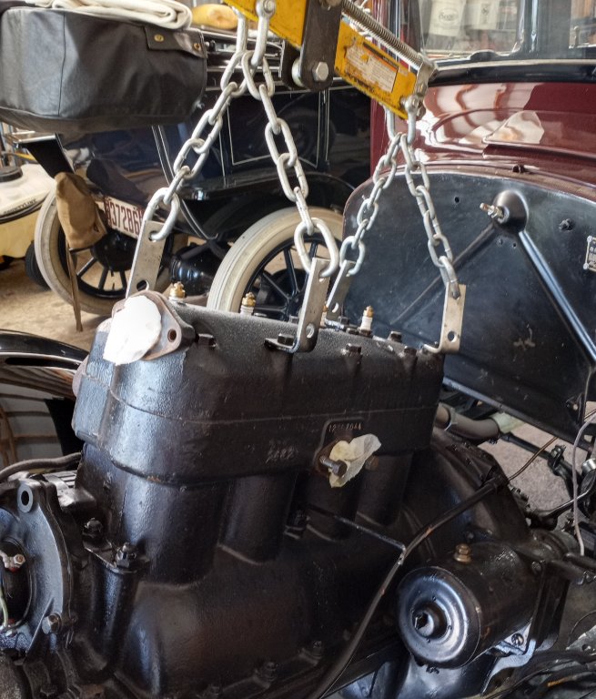

Re: 26 engine replacement
Yes, I have done it. You need to tip the engine going in. Loosening the pedals so they can be rotated backwards helped clear the firewall. Use a lifting chain bolted to the water intake bolt hole and the other end on the rear manifold clamp stud hole using grade 8 bolts and washers, that should give you a good center of gravity that will allow you to tip the engine to get it under the firewall.

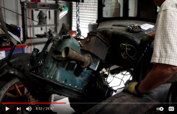

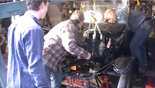

- Posts: 6581

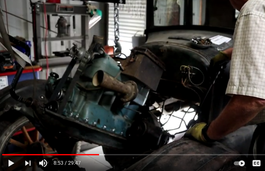

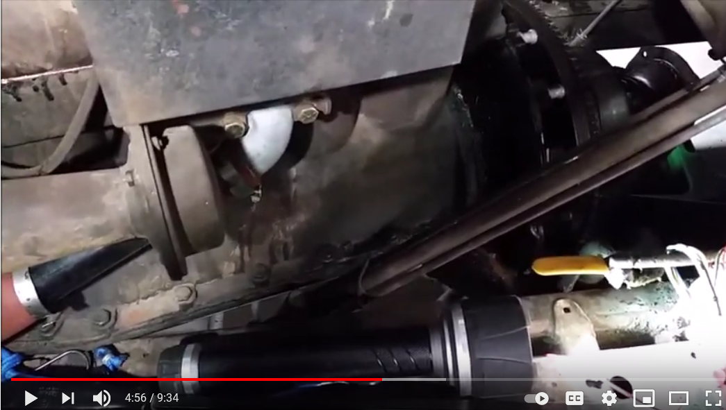

Here are some video's look at them all just takes a few minutes to get the idea
One man job notice catch pans for oil
Removal part 1 https://www.youtube.com/watch?v=8pn0-duuG1Q
Removal part 2 https://www.youtube.com/watch?v=vBK0c8QrGvk Install part 1 https://www.youtube.com/watch?v=_ntnXVj3gMo Install part 2 https://www.youtube.com/watch?v=Aju9TYlicr0
This is a removal with hogs head in place and shows the tilt to clear the firewall https://www.youtube.com/watch?v=dXzq8FI4PA8 2 men & a kid -(possible hernia) but good https://www.youtube.com/watch?v=2mEa5Fz2HaQ

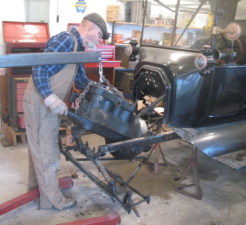

Yes. Remove the steering column @ frame, steering arm & firewall. Leave off the coil box. Motor needs a lot of angle. Line up motor & pull the nose toward the driver side to get the low pedal behind the firewall. Go in & straighten.Tom VanMeeteren wrote: ↑Tue Jul 27, 2021 5:16 amIs is possible to put a 26 engine back into the car with the transmission cover and pedals all attached? A guy brought me a 26 engine all assembled and wants it back in the car but has the trans cover and all attached. Body is a coupe body.
Something not mentioned yet is the wish bone. Have a long bar or 2x4 handy to pull it down to clear the bottom of the pan during installation or removal. The first video series makes it look harder than it actually is. The second video series (pre 26 T) with a lower firewall goes pretty smoothly. (removal with hogs head in place).
I personally remove the headlights, radiator diaper & hood shelves to prevent damage.

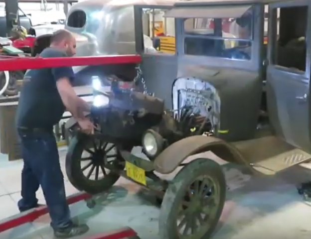

I just did the engine in my 26 Coupe. I did not remove the hogshead, pedals, or the steering. I had the cylinder head off when I removed it, but on when I installed it. It went in easier then it came out. So, leave the head on and pick it up from the #3 spark plug hole and slide it forward out of the mounts Then move to the #2 spark plug hole and lift and twist it to get it out. I did it by myself with out any issues. The hardest part was getting the u-joint lined up when putting it back in.
