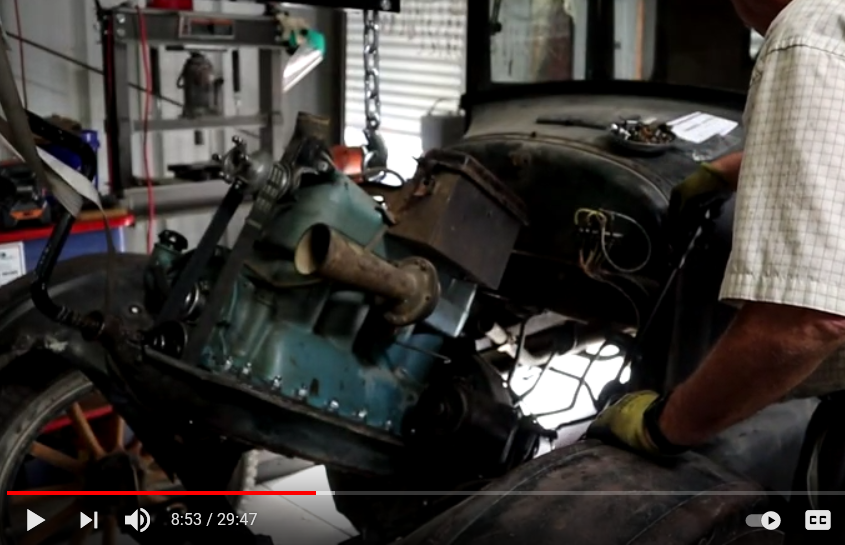

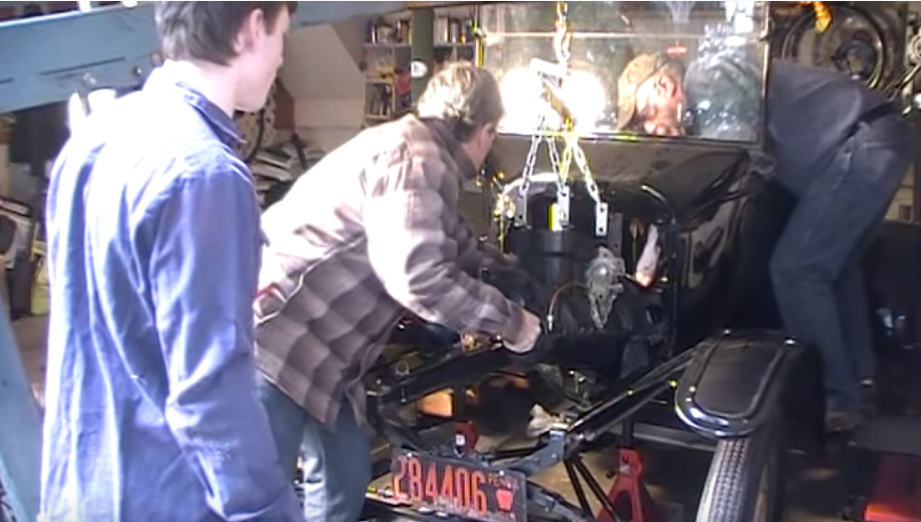

Here are some video's look at them all just takes a few minutes to get the idea
One man job notice catch pans for oil
Removal part 1 https://www.youtube.com/watch?v=8pn0-duuG1Q
Removal part 2 https://www.youtube.com/watch?v=vBK0c8QrGvk
Install part 1 https://www.youtube.com/watch?v=_ntnXVj3gMo
Install part 2 https://www.youtube.com/watch?v=Aju9TYlicr0
This is a removal with hogs head in place and shows the tilt to clear the firewall https://www.youtube.com/watch?v=dXzq8FI4PA8
2 men & a kid -(possible hernia) but good https://www.youtube.com/watch?v=2mEa5Fz2HaQ
