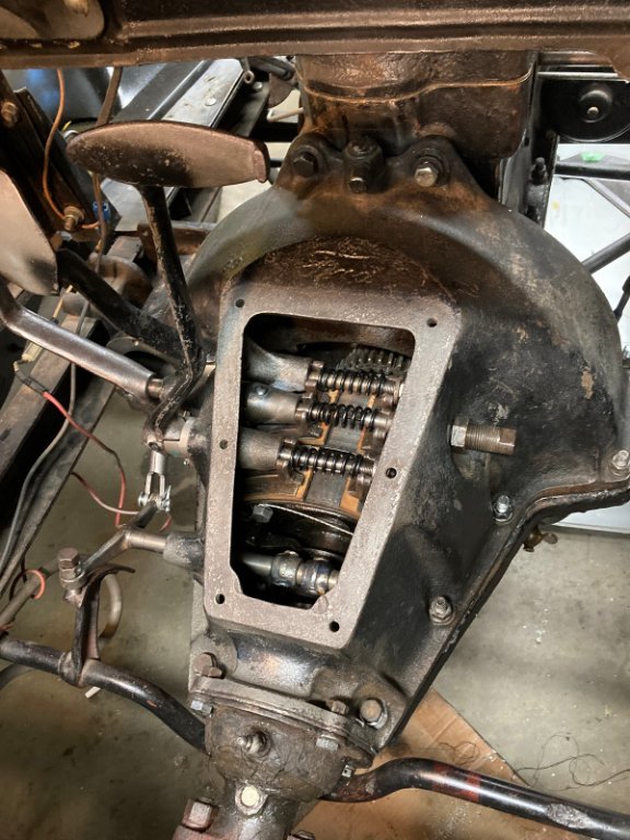

If you conclude it is truly excessively noisy, pull the inspection cover. Check each tripple gear with a large screwdriver for excessive slop.(worn tripple gear bushings) Its an easy way to ease your mind.

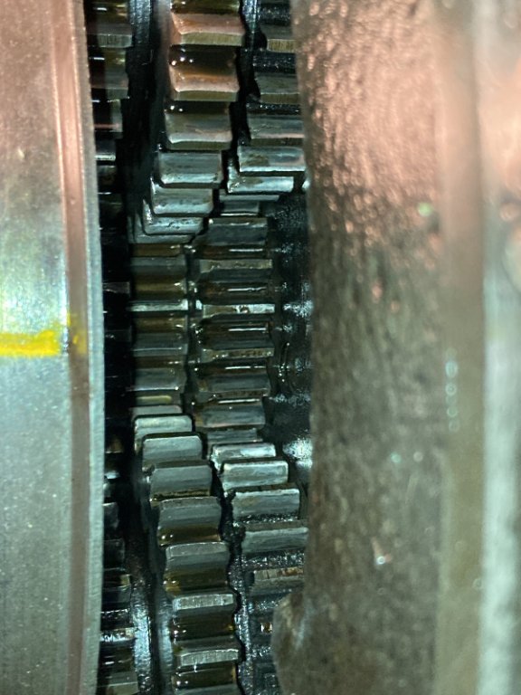

I think these are the triple gears, there is no noticeable rotary motion but I can push them back to front a little, is this normal, see the video.

Rotary(excessive bushing wear) would be a problem. In & out is expected. Check all 3.

All 3 have little to no rotary play at least nothing I can see with my eye, just the little bit of end play as seen in the video

Well I'm convinced there is something wrong with my transmission so I found a mechanic close to me and was going to trailer my car over there to have him give it a test drive and give me me his thoughts on the noise. I drove the car around last Sunday for a few blocks but felt it was mighty slow getting up it speed in first gear, maybe, maybe not, it was my first time driving a T, anyway today when I tried to load this on the trailer I could barely get the front wheels up the ramp and when the back wheels hit the ramp it just didn't have enough to get up on the trailer. Had the hand brake straight up as much throttle as I dared give it and the pedal to the floor, noticed the pedal would get stuck when I pushed on it that hard. I gave up after two attempts and when putting the car back in garage first gear seems to be about nothing, with the hand brake straight up it will creep forward and that's how I got it back in the garage.
I'm going to attempt to go through the service manual tomorrow and see if I can adjust the parking brake and bands.
- Posts: 5340
Re: 1927 Touring, tranny is loud
You need to adjust low band tighter - that T ought to crawl up on that trailer.

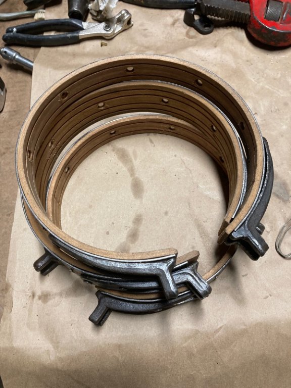

If you need new bands(very likely) T1 manual! Use cotton or scandia. NO KEVLAR. Kevlar is unforgiving & ONLY for the advanced operator. Much destruction can take place with a little mistake. You will go thru your new bands fairly quickly as you learn to drive. The second set will last much longer.

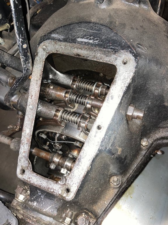

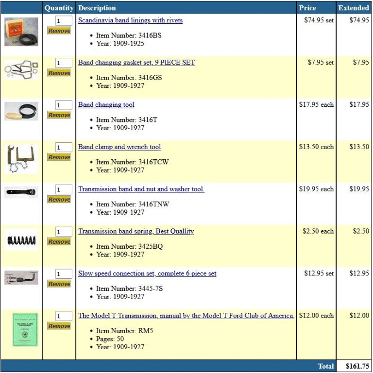

The mechanic I found is an antique auto mechanic, I found him after watching some YouTube videos of him rebuilding a Model T transmission, is it against the rules to name them?
FYI, the clutch pedal was getting stuck on the floor board.
The band adjusting bolt on my transmission only show about 1/4" thread so I guess I get to learn how to reline the bands, I believe my bands have the detachable ears so I am going to attempt to change them through the inspection cover. What is the difference between cotton and Scandinavia band linings is one better than the other? Is here anything else I should do while I'm in there, replace the clutch spring? If I took the hogs head off is there anything I could inspect to try and narrow down why the transmission is so loud, if in fact it actually is loud.
What tools do I need for this job?
I appreciate the help immensely,

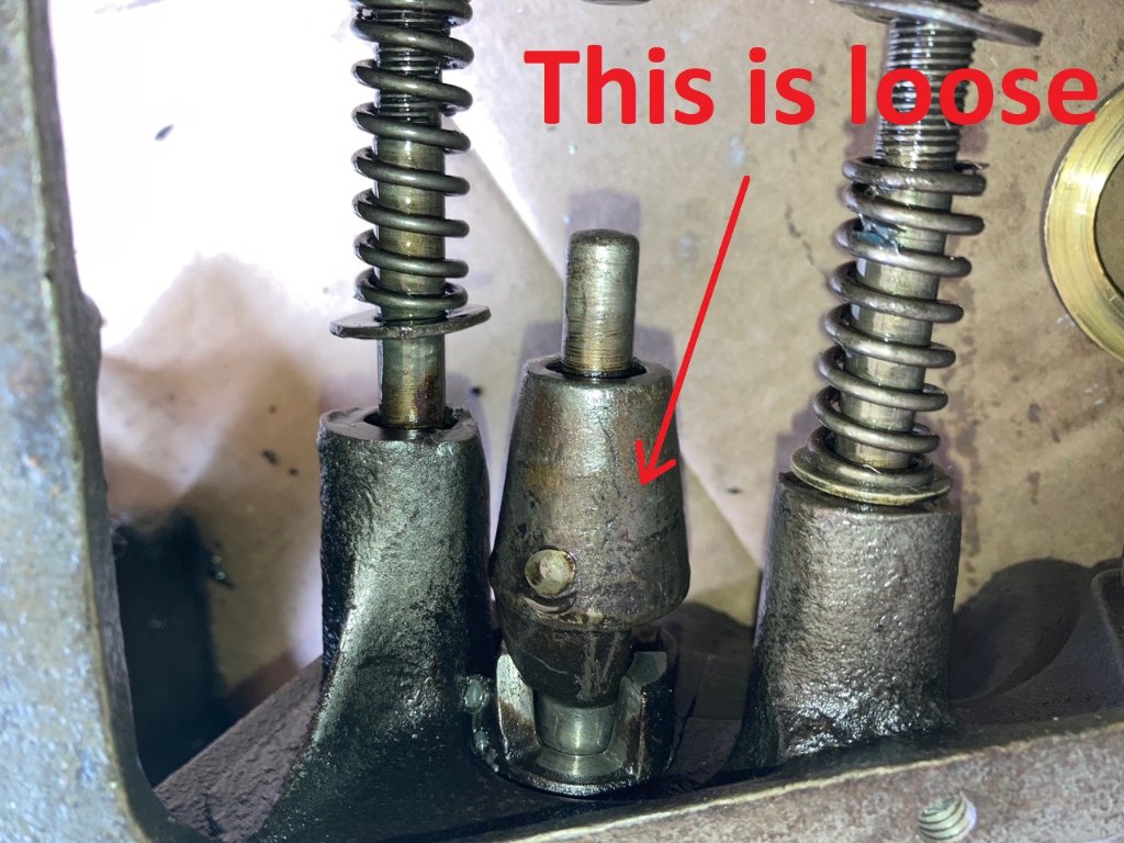

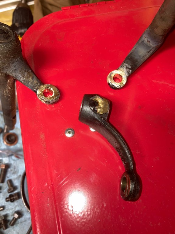

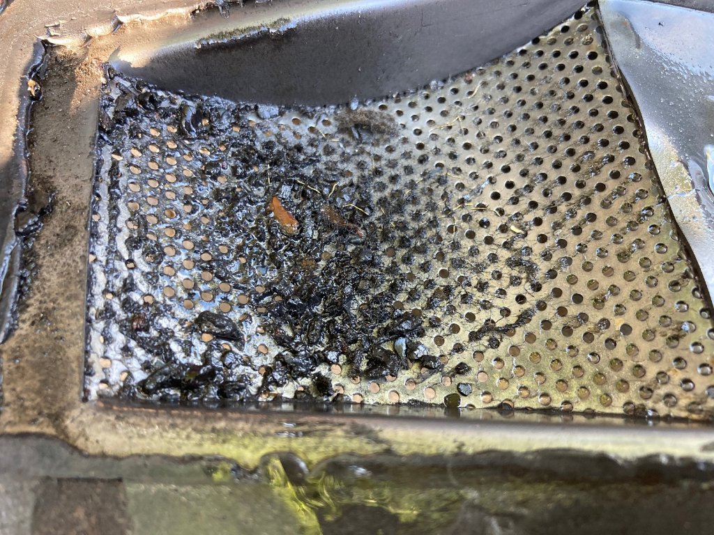

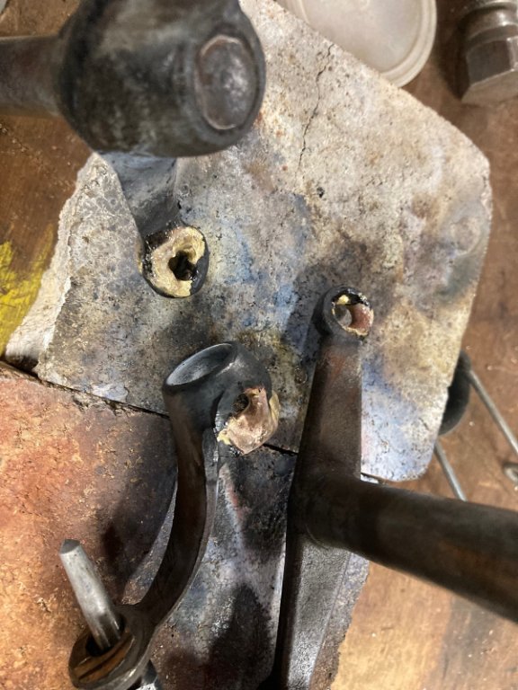

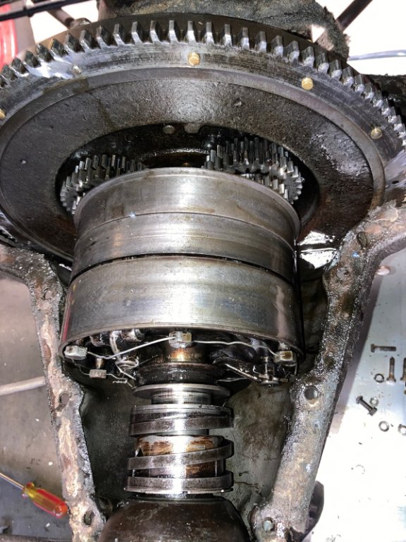

Well - just looking at your posted photos, I see several issues that were clearly of "shade tree" workmanship - hate to be a Debbie Downer but the bands are pretty much used up, the clutch throw-out fork has been bolted on & the slo-speed linkage is on backwards - for starters !
you need the '26-27 bands, not the earlier ones
I've never needed the band installation tool, myself, but I've never changed bands through the transmission door (always take hog's head off)
band clamp with wrench is a cruel hoax. It cannot be used with the hog's head installed, and if used with the hog's head off, the hog's head will be held off by the clamp and the clamp will be hopelessly trapped (use zip ties or wire)
I don't think you've yet found evidence that the clevis needs to be replaced...
the nut/washer tool is clever but I find it to be kind of clumsy and it scares me as much as just using fingers and dentil floss
pay attention to Steve Tomasso's comments. You have some work to do, but it's part of the T experience. You're finding out that when someone says: "he!!, any blacksmith could work on 'em", that pretty much every blacksmith in America has likely worked on your car already, in a desperate attempt to find where the horseshoe goes.

Where do I find band lining for a 1927, I can't seem to find them, what about wood bands?
Things I need to do, rivet on the clutch arms, Low pedal to clutch arm hole is very worn, braze and re-drill, replace worn clevis and L bolt, new O rings, new band return springs, tighten low speed notch thingy.
Can you tell from the pictures whats right and more importantly what wrong and needs attention.

Ouch
yep, that's gonna be loud
unfortunately that much slop pretty much coincides with the level of workmanship and choices made by the previous mechanic as displayed in the immediately preceding photos.
You have your work cut out for you, and you're going to get to know this car much sooner and to a more intimate level than you ever planned, I'm sure.
Given the evidence you've provided to date, it is clear to me that any specific, actionable advice prior to a teardown would be premature prior to total discovery and analysis of the individual parts
The good news is that next time you tell the forum that something is noisy, it will make the hair on everyone's neck stand up in horror and not be dismissive of the comment (as I was).

So is the slop in the drums as seen in the video not normal
- Posts: 4960
Look for the source of the slop. Look @ the driven gear. (See T1 manual) While you wiggle the drums. Is it loose? Is/are any of the riveted drum gears loose? Are drum gears excessively worn?

The driven gear and and triple gears are all worn.
Will I hurt anything if I put new band linings on, fix what I can without taking the engine out and drive this until winter, I'll rebuild this in the winter with new drums and gears and Id like to put the missing magneto back in so I can run this off coils. Its running off a distributor now so I am missing everything at the moment to run this off a magneto.
- Posts: 6596
That seems a reasonable plan if you drive low easily and avoid very hard braking. Understand that the gears are likely worn beyond the hardened zone and wear will continue, and with the loss of cross section on the teeth, there is a somewhat elevated tooth-breakage risk.
While the hog's head is off, you'll want to do three things:
1. weld up and ream open the super-worn hole on the low pedal linkage extension
2. Remove the low speed notch pin, ream the pedal shaft to clean up the hole as necessary and do the same to the notch and rerivet it all together with a custom pin for a solid and certain action when stepping on the pedal. While it's apart, you should evaluate the notch and ramp for minimal necessary dead-band so that the high clutch will disengage properly and still start the ramp to low band with minimal pedal travel after high speed is released. Often times there is excessive rotational input to the pedal before any sideways "squeezing" takes place, leading the owner to run the low band far too tight out of necessity. In my opinion, failure to do this critical repair prior to installing Kevlar bands is a leading cause of drum breakage (I know you're not going to kevlar, but the fact remains that this very important aspect of repairs is more often than not, ignored). Also take John's advice and put an o-ring under the ramp at reassembly to stem some of the leaks.
3. bands are massively distorted. Search MTFCA forum for "how to install band material" to see how/why bands need to be ROUND and untwisted. Finally, install them without distorting them. This means, do not just push them over the drum like a C-clip and bend them up. Snake them around the pan down at the brake drum and spring open gently and only enough to rotate over the brake drum and then slide forward (installing reverse first, low second, and brake last)
the rest can wait for winter
the condition of the drums will mean a curtailed life for the bands, so your plan for remediation soon is a good one. Install a transmission screen and hope to catch the bulk of the fuzz that will come off the bands, and when you DO finally service this thing, plan on a roto-rooter job on the internal oil line as it for certain has some cotton in it, limiting oil flow to the front

An observation: The severe wear I see is on the reverse drum gear. Undoubtedly From the previous owner using reverse as a brake. Contrary to the myth, Using reverse as a brake is a really bad practice. All that braking force goes thru the planetary system instead of a brake drum.

The whole transmission looks like it needs to be rebuilt. You might also look at swap meets for a good 26-27 transmission which you could swap for this one. Otherwise you need a lot of work and possibly an experienced machinist to do at least some of the work. I would suggest you purchase (if you don't already have) the book published by the club, "Transmission" which gives step by step instructions for inspecting and rebuilding the transmission. Good Luck,

Well I'm starting to put this back together, I did installed wood band linings.
I have a question though about the clutch finger adjustment, I've read there should be a clearance of 13/16” between your clutch shift and the drive plate shaft flange, I measured it at the 3 fingers and come up with .850, .885, .890, should I set this back to 13/16" (.8125) or leave it about where its at and even out the numbers?
- Posts: 5340
In the neighborhood of 13/16" seems to be sufficient for a starting point - as long as all three fingers have equal pressure & distance.
- Posts: 5435
The 13/16 is ballpark because you only have one slot to work with. That measurement is to the face of the drive plate, not the rivet head. Once you get that base set, and drive the car, then if you need to adjust because of slippage, turn each one in to increase pressure, the same amount. 1/2 turn, full turn, etc. You may never get an exact same reading between all 3, but you want them all close.
- Posts: 4960
Something I commonly do is add a second slot in each set screw & 90 degrees. Allows for a more even pressure adjustment @ 90 V/S 180 degrees.Mark Gregush wrote: ↑Sat Jul 31, 2021 11:40 amThe 13/16 is ballpark because you only have one slot to work with. That measurement is to the face of the drive plate, not the rivet head. Once you get that base set, and drive the car, then if you need to adjust because of slippage, turn each one in to increase pressure, the same amount. 1/2 turn, full turn, etc. You may never get an exact same reading between all 3, but you want them all close.

Just thought I'd post some pictures so you guys can correct me if I'm doing something wrong.
This was my first ever attempt at brazing.
- Posts: 6596
You're committed to braze now, but I wire weld this sort of stuff.
In any event, you're going to be happy you got all of this stuff corrected before the inevitable on-the-road failure occurred. Be darn sure those bands are round and are completely free on the drums when released 5/16" or so. Looks like you're going to run wood, so I have revised/removed my band caution.
Your workmanship looks nicely neat and orderly...that's nice

little bit of progress today
Is there a way to see if the clutch pedal and hand brake lever are working right without running the engine?
- Posts: 4960
You assembled & set the brake cam & pedal connection according to the T! MANUAL. With the parking brake lever back, you should be able to wiggle the 3 clutch fingers.

Okay I got this thing back together and drove out of the garage and back in, will take her for a run tomorrow.
So this thread started because I thought my transmission was loud, I have been able to here a few Model T's running and and my transmission was defiantly loud, mine sounded like the others I heard just much louder, after putting on wood bands, new springs and some other misc stuff my transmission is still loud but not nearly as loud as it was, I can defiantly hear a lot of gear noise now when I put it in first gear, that noise must have been muffled before, I'm putting in new drums and gears this winter.
Question, I've read if the transmission slips, tighten the clutch and/or adjust the bands, I've driven this car maybe a few hundred yards and never learned to drive a stick, how do I know if it is slipping?
- Posts: 4960
Clutch : When you go from low to high. If you throttle & the engine speeds up, but you are not moving faster.. Correctly adjusted stock T clutch has a little bit of "controlled slip" intended for a smooth transition from low to hi. If , when in high, you can speed up the engine(snap the throttle) & not feel the acceleration the slipping should be obvious.bmklawt wrote: ↑Fri Aug 13, 2021 7:55 pmOkay I got this thing back together and drove out of the garage and back in, will take her for a run tomorrow.
Low band: You have your foot hard down on low pedal & dont feel a solid lockup.
You might want to review the manual. It describes these conditions & solutions.

Is the screen and magnet a new addition? Or have they been there the whole time?
- Posts: 4960
What is that stuff? Carbon, old gasket goo? If this the fist time this motor has seen a screen, I would expect this collection of decades of stuff that floats around a motor. Dont panic yet. The metal shavings are more concerning. Clean the magnet & go again.

Bruce, the loud gear noise may be down to a number of things. Your transmission drums are 26-7 model types, as indicated by the wide brake drum. A 26-7 transmission typically has one piece triple gears, which gave a gap between each gear, resulting in narrower teeth on the gears. When these wear, they wear a corresponding register on the drum gears.
On your transmission, the narrow toothed one piece triple gears have been replaced with earlier wide tooth three piece gears. This will mean meshing problems and likely a deal of noise until the gears get to know each other. You will have the wide teeth engaging on the high spots where the narrow gears did not run.
Gearheads with more experience than me indicate that the earlier three piece gears are much harder than the later one piece items. That said, it is unusual to see such extensive wear on these gears as your show. It may be the case that the rivets holding the gears together are loose and that allows mis-timing of the gears. All this will be revealed when you tear it down, but the damage may well be extensive.
- Posts: 4960
Looking back @ the straight down shot of the tripple gears, I see the later 1 piece gears. There is a gap between gears. The early gears have no gap at all. Might want to take another look.Allan wrote: ↑Mon Aug 16, 2021 6:37 amBruce, the loud gear noise may be down to a number of things. Your transmission drums are 26-7 model types, as indicated by the wide brake drum. A 26-7 transmission typically has one piece triple gears, which gave a gap between each gear, resulting in narrower teeth on the gears. When these wear, they wear a corresponding register on the drum gears.
- Posts: 6915
You are correct John. My apologies for misleading anyone The early photo looking down on the flywheel clearly shows one piece gears. The wear on these is typical for such gears. That is one reason I prefer to use the riveted three piece gears.
