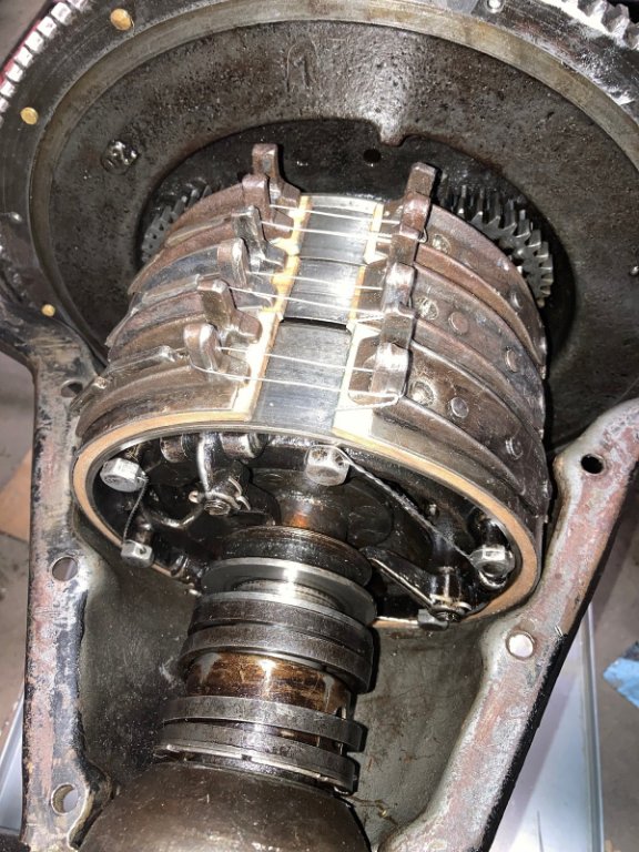

I think these are the triple gears, there is no noticeable rotary motion but I can push them back to front a little, is this normal, see the video.

Rotary(excessive bushing wear) would be a problem. In & out is expected. Check all 3.

All 3 have little to no rotary play at least nothing I can see with my eye, just the little bit of end play as seen in the video

Have a seasoned T guy look & hear her. They are by nature noisy.

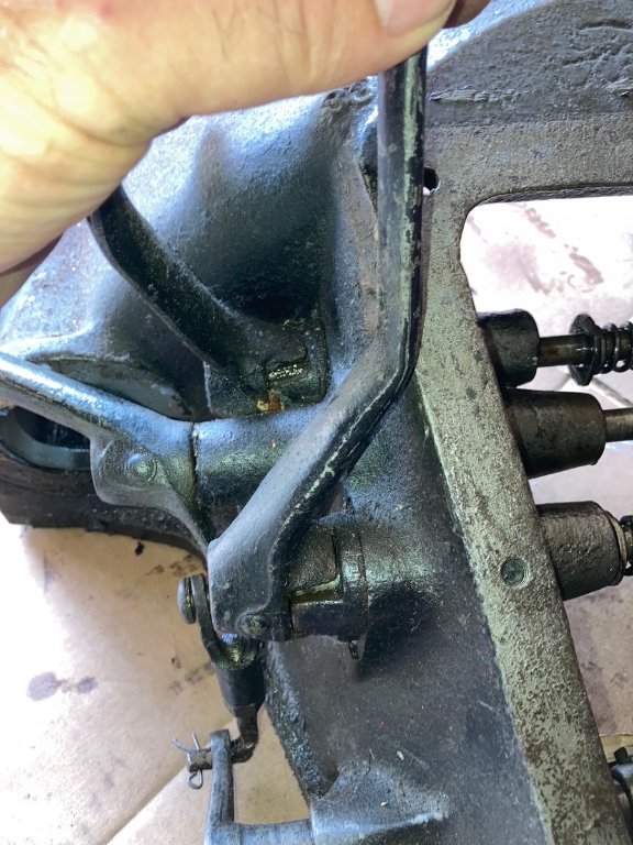

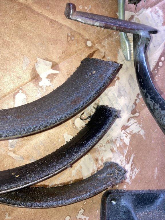

The mechanic I found is an antique auto mechanic, I found him after watching some YouTube videos of him rebuilding a Model T transmission, is it against the rules to name them?
FYI, the clutch pedal was getting stuck on the floor board.
The band adjusting bolt on my transmission only show about 1/4" thread so I guess I get to learn how to reline the bands, I believe my bands have the detachable ears so I am going to attempt to change them through the inspection cover. What is the difference between cotton and Scandinavia band linings is one better than the other? Is here anything else I should do while I'm in there, replace the clutch spring? If I took the hogs head off is there anything I could inspect to try and narrow down why the transmission is so loud, if in fact it actually is loud.
What tools do I need for this job?
I appreciate the help immensely,

Well - just looking at your posted photos, I see several issues that were clearly of "shade tree" workmanship - hate to be a Debbie Downer but the bands are pretty much used up, the clutch throw-out fork has been bolted on & the slo-speed linkage is on backwards - for starters !

you need the '26-27 bands, not the earlier ones
I've never needed the band installation tool, myself, but I've never changed bands through the transmission door (always take hog's head off)
band clamp with wrench is a cruel hoax. It cannot be used with the hog's head installed, and if used with the hog's head off, the hog's head will be held off by the clamp and the clamp will be hopelessly trapped (use zip ties or wire)
I don't think you've yet found evidence that the clevis needs to be replaced...
the nut/washer tool is clever but I find it to be kind of clumsy and it scares me as much as just using fingers and dentil floss
pay attention to Steve Tomasso's comments. You have some work to do, but it's part of the T experience. You're finding out that when someone says: "he!!, any blacksmith could work on 'em", that pretty much every blacksmith in America has likely worked on your car already, in a desperate attempt to find where the horseshoe goes.

Get a new set of 3 band return springs. They are typically shrunk from use. Washers are not stock. See manual. Low drum lining is gone to the metal band. It has scraped the drum. A little smoothing may be useful with emery cloth. Prevent the filings from getting into the trans. Output plate bolts wired in pairs. Not over the fingers.

Where do I find band lining for a 1927, I can't seem to find them, what about wood bands?
Things I need to do, rivet on the clutch arms, Low pedal to clutch arm hole is very worn, braze and re-drill, replace worn clevis and L bolt, new O rings, new band return springs, tighten low speed notch thingy.
Can you tell from the pictures whats right and more importantly what wrong and needs attention.

Ouch
yep, that's gonna be loud
unfortunately that much slop pretty much coincides with the level of workmanship and choices made by the previous mechanic as displayed in the immediately preceding photos.
You have your work cut out for you, and you're going to get to know this car much sooner and to a more intimate level than you ever planned, I'm sure.
Given the evidence you've provided to date, it is clear to me that any specific, actionable advice prior to a teardown would be premature prior to total discovery and analysis of the individual parts
The good news is that next time you tell the forum that something is noisy, it will make the hair on everyone's neck stand up in horror and not be dismissive of the comment (as I was).

The driven gear and and triple gears are all worn.
Will I hurt anything if I put new band linings on, fix what I can without taking the engine out and drive this until winter, I'll rebuild this in the winter with new drums and gears and Id like to put the missing magneto back in so I can run this off coils. Its running off a distributor now so I am missing everything at the moment to run this off a magneto.
Posts: 6601
Re: 1927 Touring, tranny is loud
Post by Scott_Conger » Thu Jul 22, 2021 12:45 pm
That seems a reasonable plan if you drive low easily and avoid very hard braking. Understand that the gears are likely worn beyond the hardened zone and wear will continue, and with the loss of cross section on the teeth, there is a somewhat elevated tooth-breakage risk.
While the hog's head is off, you'll want to do three things:
1. weld up and ream open the super-worn hole on the low pedal linkage extension
2. Remove the low speed notch pin, ream the pedal shaft to clean up the hole as necessary and do the same to the notch and rerivet it all together with a custom pin for a solid and certain action when stepping on the pedal. While it's apart, you should evaluate the notch and ramp for minimal necessary dead-band so that the high clutch will disengage properly and still start the ramp to low band with minimal pedal travel after high speed is released. Often times there is excessive rotational input to the pedal before any sideways "squeezing" takes place, leading the owner to run the low band far too tight out of necessity. In my opinion, failure to do this critical repair prior to installing Kevlar bands is a leading cause of drum breakage (I know you're not going to kevlar, but the fact remains that this very important aspect of repairs is more often than not, ignored). Also take John's advice and put an o-ring under the ramp at reassembly to stem some of the leaks.
3. bands are massively distorted. Search MTFCA forum for "how to install band material" to see how/why bands need to be ROUND and untwisted. Finally, install them without distorting them. This means, do not just push them over the drum like a C-clip and bend them up. Snake them around the pan down at the brake drum and spring open gently and only enough to rotate over the brake drum and then slide forward (installing reverse first, low second, and brake last)
the rest can wait for winter
the condition of the drums will mean a curtailed life for the bands, so your plan for remediation soon is a good one. Install a transmission screen and hope to catch the bulk of the fuzz that will come off the bands, and when you DO finally service this thing, plan on a roto-rooter job on the internal oil line as it for certain has some cotton in it, limiting oil flow to the front

I would do that. Fix the hogs head & pedal wear & rivet issues. Worn gears driven a little more wont hurt. If low pedal has a bunch of lost motion before cam engages, replace those cams. O ring under cam plates. 5/8 id x 7/8 od 1/8 cross. Counter bore with 7/8" end-mill. A large countersink can be used also.
Bands: Last set I got of cotton came from Bob's. That was when scandia was not available. You might talk to Dave @ Chaffins on options.
Wood bands: Some guys like them, I do not. I have removed more sets upon customer request than installed. My experience is they chatter & dont engage friendly. There may be a way to make them work, like adding some cut oil slots, I dont know. Nobody has convinced me the effort would be worth it.

An observation: The severe wear I see is on the reverse drum gear. Undoubtedly From the previous owner using reverse as a brake. Contrary to the myth, Using reverse as a brake is a really bad practice. All that braking force goes thru the planetary system instead of a brake drum.
