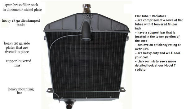

A new Bergs or Brassworks will run you about $900. I bought one for my car and, even with a freshly babbitted and tight engine, it still won't boil over. Definitely worth the expense if you plan to drive your car.Jonah D'Avella wrote: ↑Mon Aug 30, 2021 8:09 amIf it wont clear out, how much is a new radiator for a 26?

Re: Radiator problem found
The vinegar to use is cleaning vinegar no salad vinegar. But time is money and trying to get an old radiator "working" again just isn't worth the effort.
Berg's are best and built well http://www.bergsradiator.com/modelt.html

Jonah, I just talked to the owner of berg's Radiators, last week. I forgot the exact cost, but I know that he told me a new flat tube, high 24-27 radiator was over $900.00. Once your radiator problem is solved, do as others have recommended and flush your block until its squeaky clean, especially if you run, or have ever run an aluminum head or water pump on it. you'll know if it has, even if there hasn't been one on it since you bought it. If it has, and the inside of the block is dry, it willl have a white chalky goop in the water passages. If the inside is wet, the white goop will be more like white mud.Jonah D'Avella wrote: ↑Mon Aug 30, 2021 8:09 amIf it wont clear out, how much is a new radiator for a 26?

Jonah, Looks like there aren't any radiator repair shops in your area. Google shows Robert's - a reclamation (scrap yard) that may be able to boil it out for a fee but uncertain about their ability to repair. Not sure if I would have them do any more than that without knowing more about them (get references). In nay case before you have anything done get a written estimate - just to boil it out. I'd drive my T to this place and see what interest it causes, there may be some knowledgeable T person around to guide you, and who knows they may even have a "reclaimed" one.
Now if there is a compelling reason for you to keep what you have and/or be original; consider the costs of sending it any of the recommended repair shops: cost of packaging it + insured shipping costs both ways + boiling it out. If okay at this point you saved. If not then the cost to repair at this point your kinda of stuck with deciding not to and being out the costs so far or going ahead with an "estimated" repair.
The option of purchasing a BERG, lets you run around in your T until it arrives, then to sell your old one.
