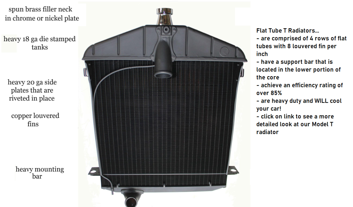

Posts: 6609
Re: Radiator problem found
Post by TRDxB2 » Mon Aug 30, 2021 10:07 am
The vinegar to use is cleaning vinegar no salad vinegar. But time is money and trying to get an old radiator "working" again just isn't worth the effort.
Berg's are best and built well http://www.bergsradiator.com/modelt.html

Post by TRDxB2 » Wed Sep 01, 2021 11:46 am
Jonah, Looks like there aren't any radiator repair shops in your area. Google shows Robert's - a reclamation (scrap yard) that may be able to boil it out for a fee but uncertain about their ability to repair. Not sure if I would have them do any more than that without knowing more about them (get references). In nay case before you have anything done get a written estimate - just to boil it out. I'd drive my T to this place and see what interest it causes, there may be some knowledgeable T person around to guide you, and who knows they may even have a "reclaimed" one.
Now if there is a compelling reason for you to keep what you have and/or be original; consider the costs of sending it any of the recommended repair shops: cost of packaging it + insured shipping costs both ways + boiling it out. If okay at this point you saved. If not then the cost to repair at this point your kinda of stuck with deciding not to and being out the costs so far or going ahead with an "estimated" repair.
The option of purchasing a BERG, lets you run around in your T until it arrives, then to sell your old one.
