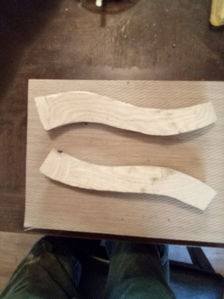

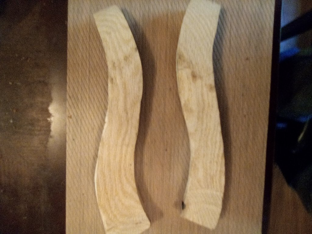

working on a 15 roadster body. I have made these strange tack strips but have no idea how they fasten in place.

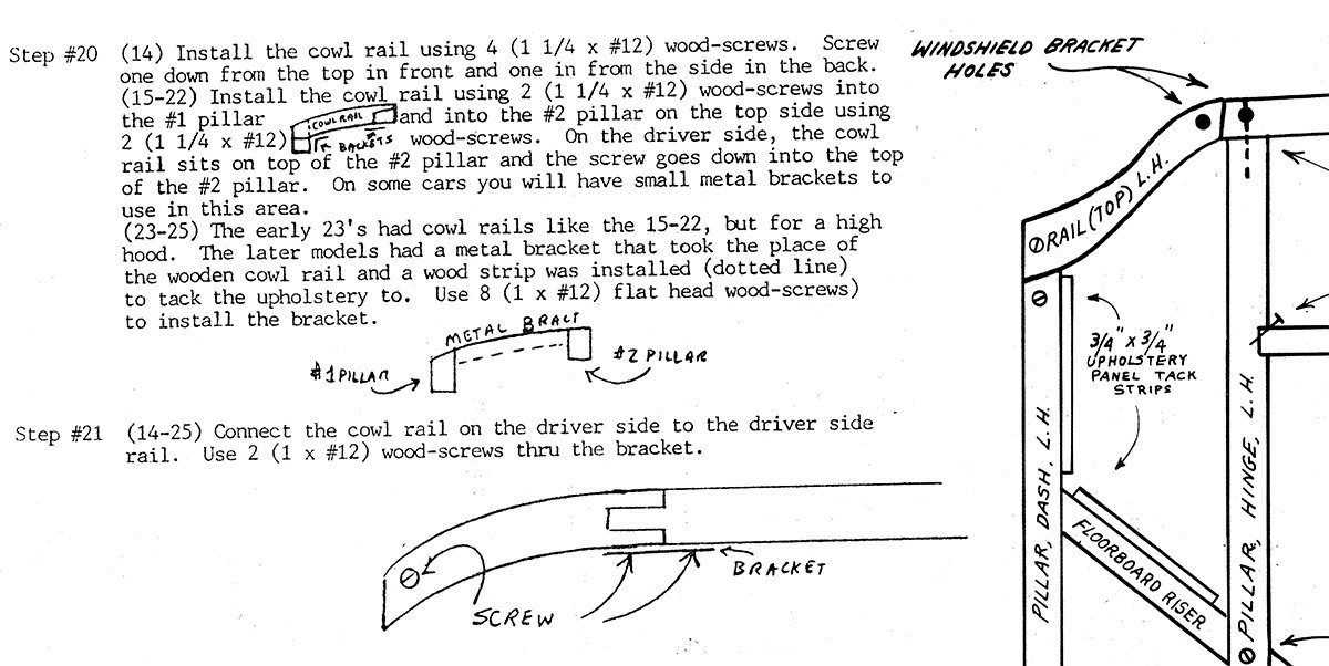

This may be a place to start. It does show them in place.
http://www.mtfca.com/discus/messages/506218/523488.html

Better yet these: At left are from the instructions that came with my '15 wood kit. At right a drawing from a set of '15-'22 plans. Both Roaster but same as touring.
Hope it makes enough sense to help.Rich
