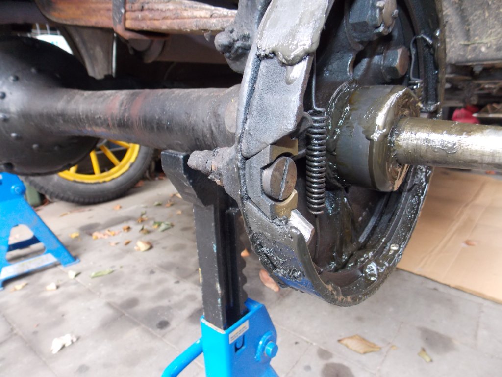

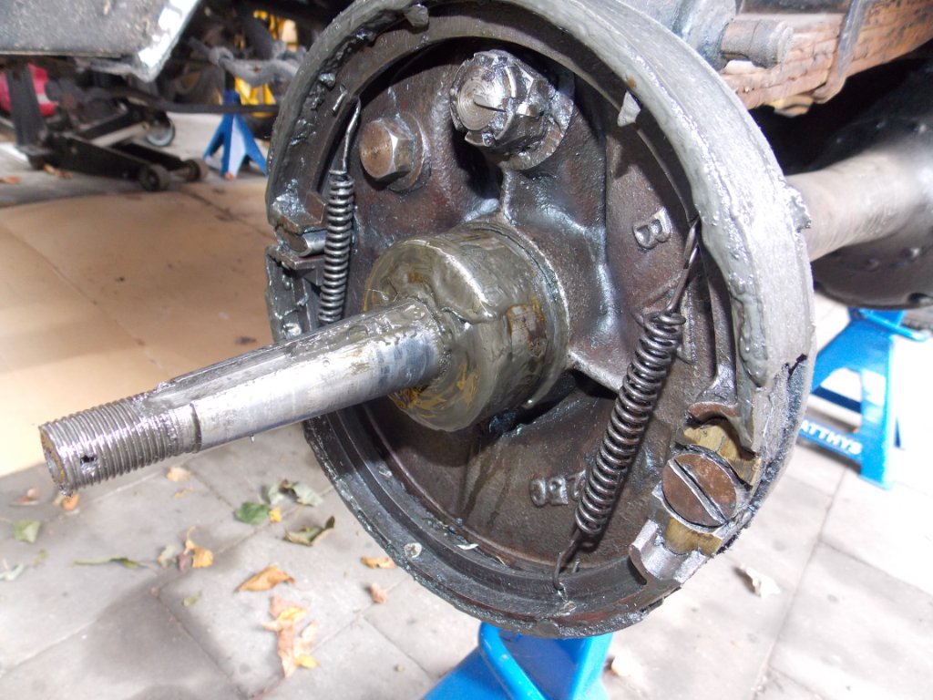

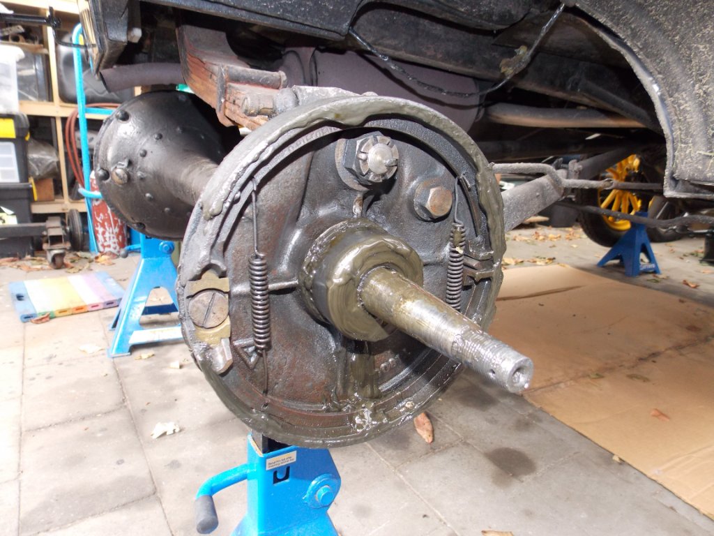

Just need to repair the emergency brakes on a 1912 right hand drive (English) Touring.
Here is what I found. Watch the setup. It is strange. Was it after market? Or did someone a special build for this car?
I think it will end with a total rear axle rebuild. I found also left - right play on the shafts.

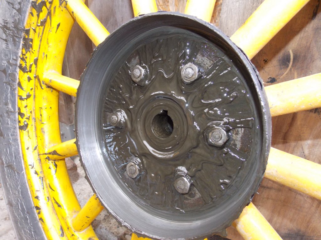

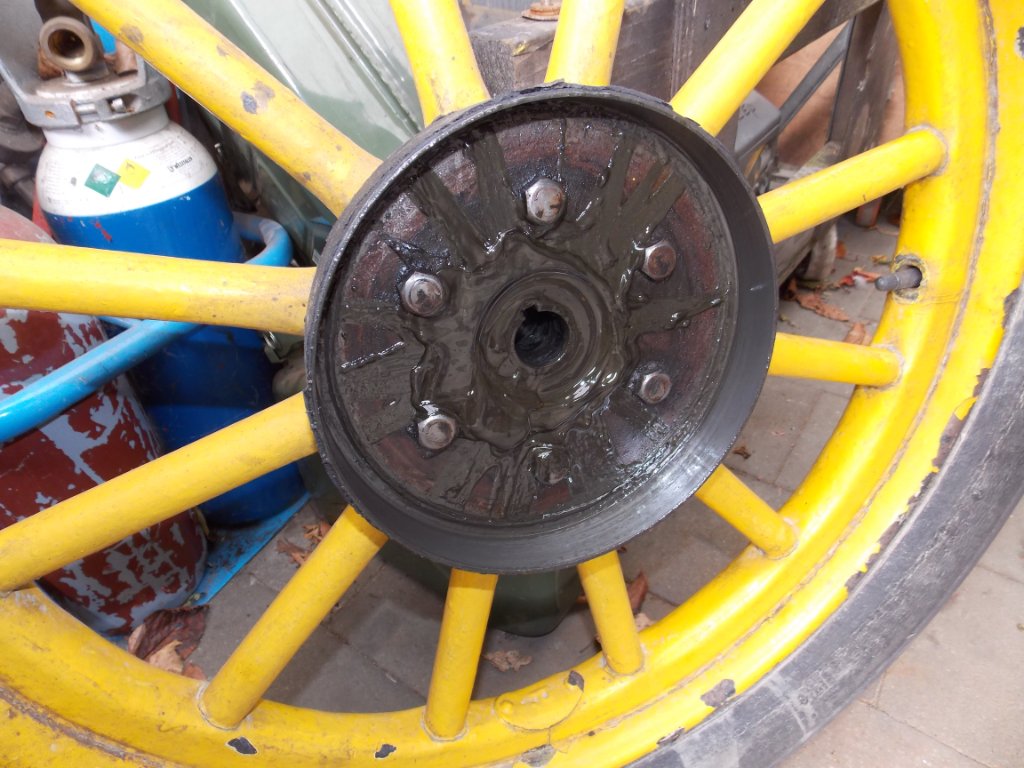

Andre.
Those are a aftermarket part designed to be adjustable from the outside by taking up the wedge instead of adjusting the brake rod keeping the propper lever angle. Judging by the silver metalic color of the grease your thrust babbitts have become liquid or you lost a bearing. I would suggest you replace the park brake linings, its near impossible to get the grease out of them. Good luck.
Craig.

Craig,
I ordered at Langs a total brake rebuild kit.
Due to the play on the shafts and the grey color of the rear axle oil, I will take the rear axle apart for a total rebuild. Not cheap but the only way to do it right and keep the oil and grease off the brakes and leaking on the wheels.
