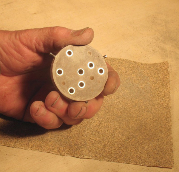

After a hundred years, sometimes the switch backing plate has become warped, causing intermittent contact. You can flatten it on coarse sandpaper. After flattening, you may need to deepen some of the dimples a little.
Some switches have backing plates held in by pins, like this one. Others have bent-over tabs. If you have one of those you'll have to unbend the tabs to get the backing plate out. While you have the switch apart, turn the tabs red and let them cool so they won't break off when you re-bend them.

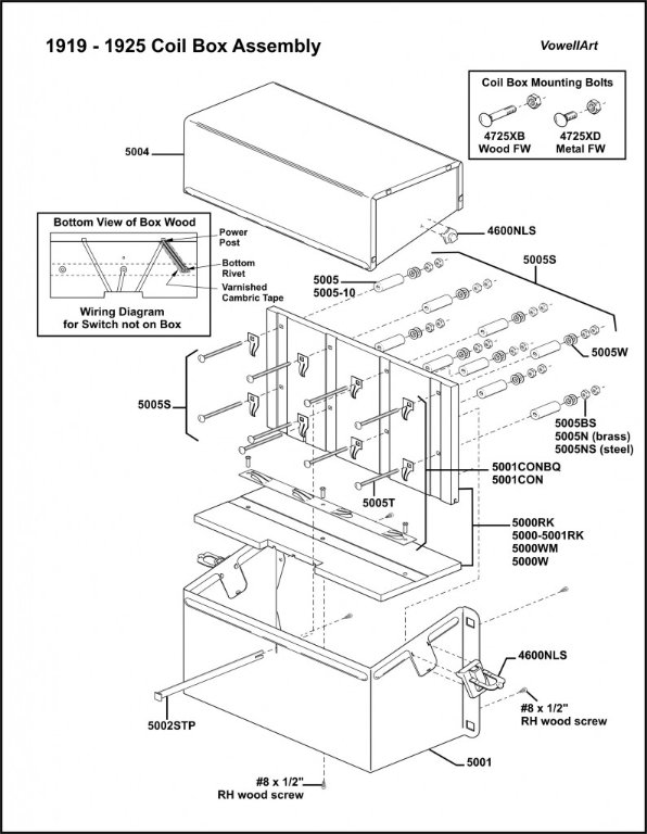

How is your coil box wired. Normally the MAG post on the box on a starter car is left out or not connected to the the center strip inside the box. So hot wiring to that post would do nothing. You can remove all the coils and test continuity from the MAG post to center strip inside the box and the same for the BAT post. The post with the continuity connects to the switch center, "coil", position on t he switch via the terminal block

Check your wiring from the diagram I posted above.

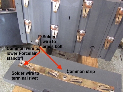

There should be no high voltage to the common strip at the bottom of the box. There must be an external contact somewhere or a real bad coil box.
The only way would be some kind of carbon arching from a poor wood box, carbon tracks in the split plywood used in original coil boxes that gets warped and decays overtime.
That is why the best way is to restore a coil box to new, to prevent any issues of that box that holds 4 trembler coils that can put out thousands of volts to those lower Porcelain standoffs!

Notice that in Dan's picture all the contacts are soldered to the bolts. That's a good thing.
- Posts: 4085
Re: New T owner and a few questions
Thanks Steve
Just when workin' on Henry's child, like to do the best for longevity....to keep the Ford running for another 100 years

One hand on the body and Eric is grounded - he should not get a shock through insulated wires unless the wire insulation is bad and grounding itself in other places.
Next: He touched one of the wires that is an INPUT to the coil box. There are 5 input wires, 4 from the timer and 1 from the switch (since on battery all would be battery voltage/amps), and 4 out wires to the spark plugs form the coils - high frequency voltage. How many posts are sticking out of the coil box?
Pictures of the condition of the wires, terminal block and coil box (inside and out) might help others see something amiss.

There's no tuning up the coil box. Just be sure all the hardware is making good contact with the coils where it's supposed to and there are no unauthorized grounds. I was going to recommend the MTFCA Electrical System book, but refurbishing or rebuilding the coil box is such a straightforward affair that the book doesn't even mention it. As the saying goes, it ain't rocket surgery.
