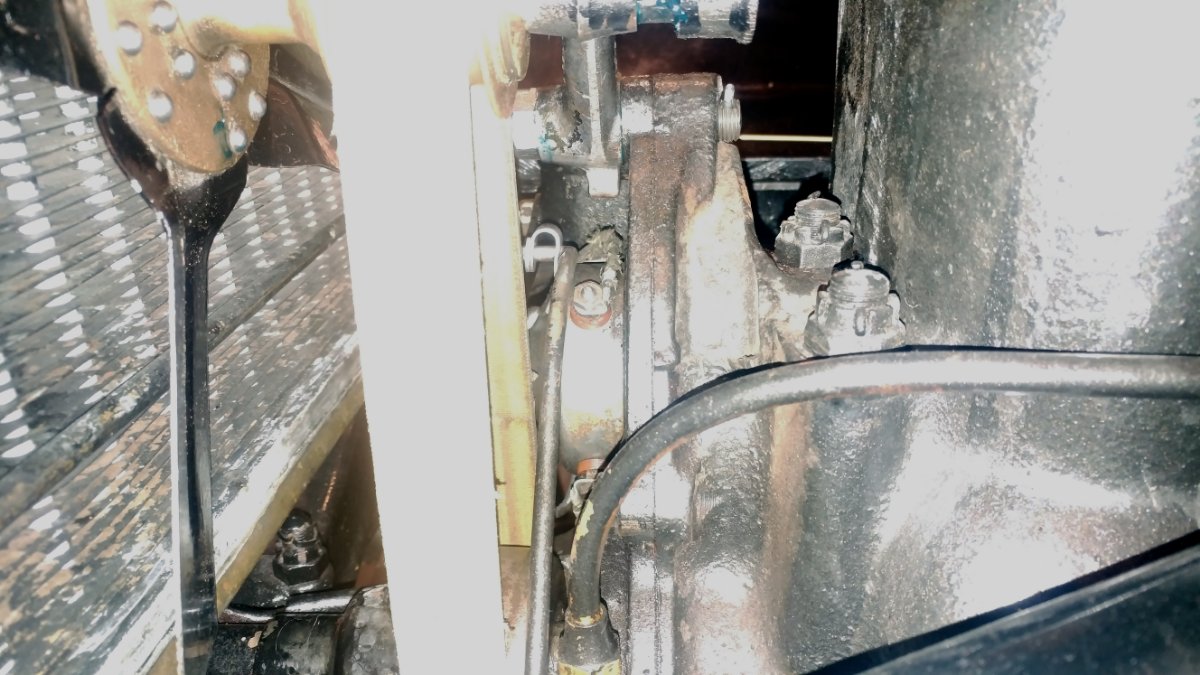

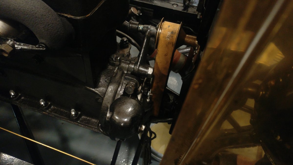

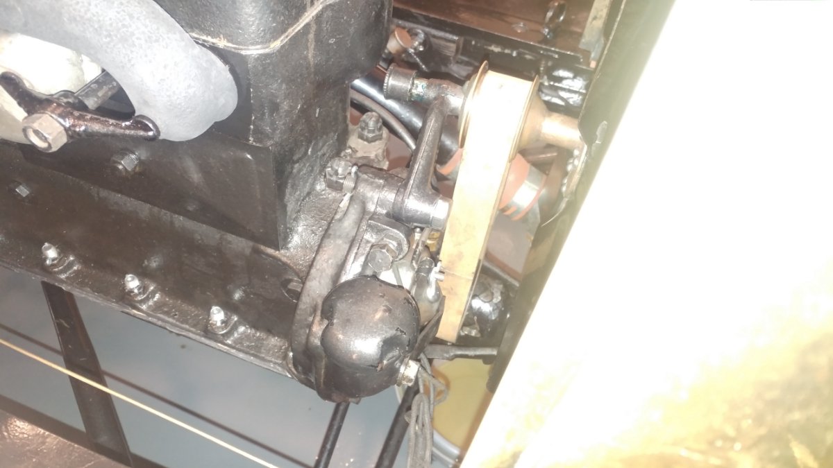

About timer:
I made two pictures of motor front side (with and without flash light).
Front side of engine w/o flash
Front side of engine with flash
The timer is a bit conical and held towards the engine by a metal finger.

I added another picture of timer, taken from left side.
See above, added there.

That looks like a Ford or Ford-style timer, so the adjustment procedure given in the book ought to be correct. But lever positions will vary somewhat from car to car for reasons of wear, adjustment, etc.
