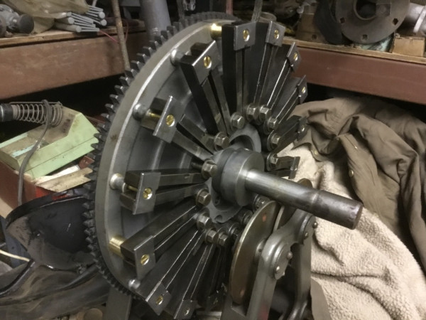

I’ve got the flywheel off of the engine that I’m currently redoing. The mag worked fine in this car before pulling the engine out, but I want to give the magnets a boost while it’s all apart. I don’t want to remove the magnets from the flywheel and have seen, in the “TRANSMISSION” book, a photo of an assembled flywheel sitting on a metal grease drum, magnets up, field coil ring sitting on the magnets, and a battery charger. No details are given as to the procedure of “zapping”. I’ve done it before, in the car, and been successful. Never did it this way before.
Does the coil ring just sit directly on the magnet clamps and then get rotated a bit until they stick together ?
Positive lead hooked to the mag post contact?
Battery Charger or some 8D 12 volt batteries? I’ve got all kinds of chargers and batteries at my disposal.

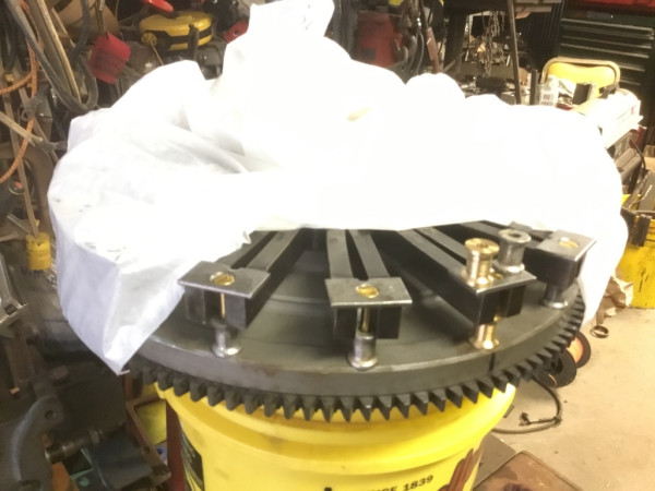

I recommend removing the magnets from the flywheel, examine everything, and at least install new brass holddown screws. These screws have a tendency to break.

When you reassemble, a few thimbles made from brass makes balancing the assembly easy.

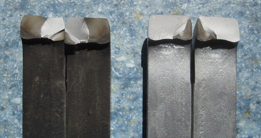

Give each magnet a ring test. Looking for that cracked magnet that will come off down the road. Belt sand the outer bent end for a visual of a crack. Not as common as a cracked drum, but common enough to check em all.

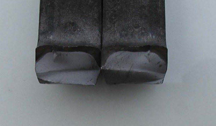

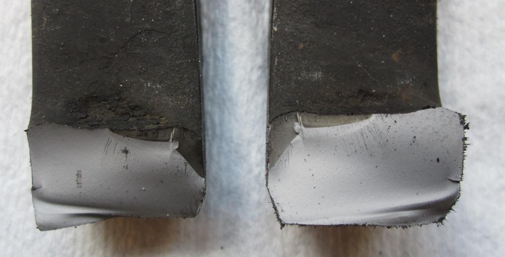

I am no fan of sanding the magnets. They may not be fully cracked through the metal.
Hold each magnet at the vee end between your thumb and forefinger.
Rap the end of the magnet on the anvil of your vise and don't be bashful about it.
If it is not cracked it will ring like a tuning fork.
If it is cracked the magnet will break into two pieces and don't be surprised if it does not break at the vee which would be the logical spot. I have seen them break in the middle of one leg.

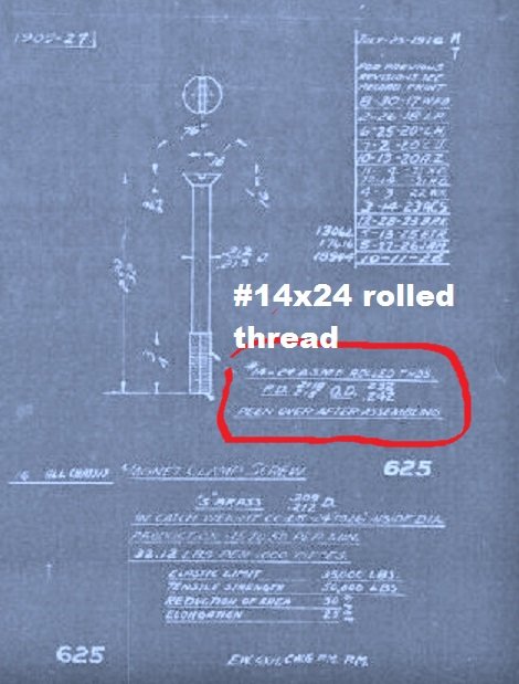

Also, note that the retaining screws are NOT BRASS. THEY ARE BRONZE, which is twice as strong as brass. If you need replacements, go to a marine supply or boat store. They will have BRONZE screws. for you to use in magnet mounting.

If sourcing bronze machine screws from boatbuilders, be absolutely certain of the correct ones for your engine. Originally Ford used 14-24 screws, modern replacement ring gears are 1/4-24. jb
- Posts: 6614
Re: Recharging magnets out of the engine
William
what is your source of information regarding the screws being bronze?
I have never torn down an engine that had bronze screws. And according to factory drawings, that is because they never built one with them.
Here is Ford's drawing, which specs 35,000 Elastic limit and 50,000lbs Tensile strength (the red annotation is not from me, it was from someone else pointing out the correct thread call out). Brass has elastic limit of 70 ksi and tensile strength of 52,200 psi
Bronze has elastic limit of 65 ksi and tensile strength of 34,800 psi
in a previous post you suggested that folks should use bronze as it was twice as strong as brass, and now you are stating that Ford actually used bronze. Neither is correct
Dave
once you ascertain which threads are in your ring gear, you can purchase the correct screws from one of the suppliers and have full confidence that what you purchase will serve you very well.
Dave

Scott's elastic and tensile numbers are reversed but his point is valid. It should read as follows.Scott_Conger wrote: ↑Tue Jan 04, 2022 10:26 amBrass has elastic limit of 70 ksi and tensile strength of 52,200 psi
"Brass has elastic limit of 52,200 psi and tensile strength of 70 ksi
Bronze has elastic limit of 34,800 psi and tensile strength of 65 ksi"
Ron Patterson
Notice that the print for Ford Factory Number T-625 indicates the magnet clamp screw was manufactured from "S Brass"

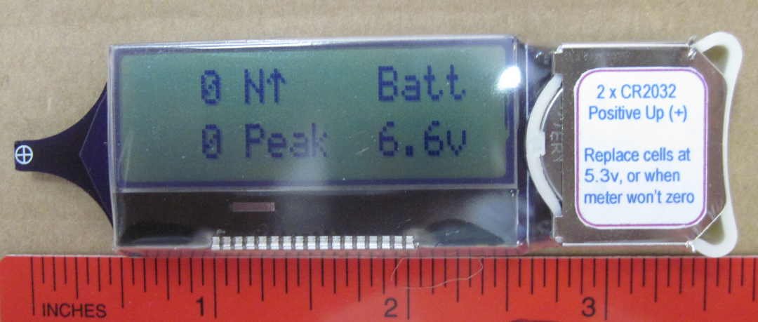

I do have a tool to measure the Gauss or magnets strength.
They are out of production, but may be produced again, if there is sufficient demand.
