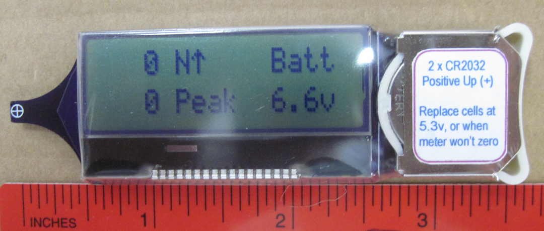

I do have a tool to measure the Gauss or magnets strength.
They are out of production, but may be produced again, if there is sufficient demand.
