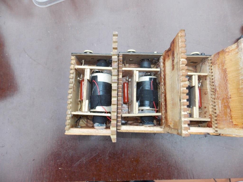

The solution to this problem depends upon if you really have a first half of 1913 KW coil box or something else?
The original KW coils used the first half 1913 KW wood boxbox were larger (see photo) than later standard sized KW coils.
As Steve (got10carz) indicated you have to make shims to go between the coils (5 shims) AND (4) in the back (rear of car) of each coil and the inside of the coilbox to take up the extgra space left by using the smaller coils in the larger coil coilbox. You will alos have to solder some sheet brass pieces to the later coils to make up for the slightly different coil contact spacing of the 1913 KW larger coils.
With some careful measureing and patience making the shims this solution works very well.
If, on the other hand, you have a wood coilbox (not KW) from another year car the solution is somewhat different.
If you can post a photo of you coilbox we can tell exactly soo exactly you have.

Daren, here is another option to consider. I have a 1913 with an original KW coil box. I use later more modern coils with brass strips soldered to the contacts and wood spacers in the coils box. See 2 pictures: 1) the coils in the box with spacers. 2) 3 coils: later one, 1913 one with lower contacts, and a later coils with the soldered strips.

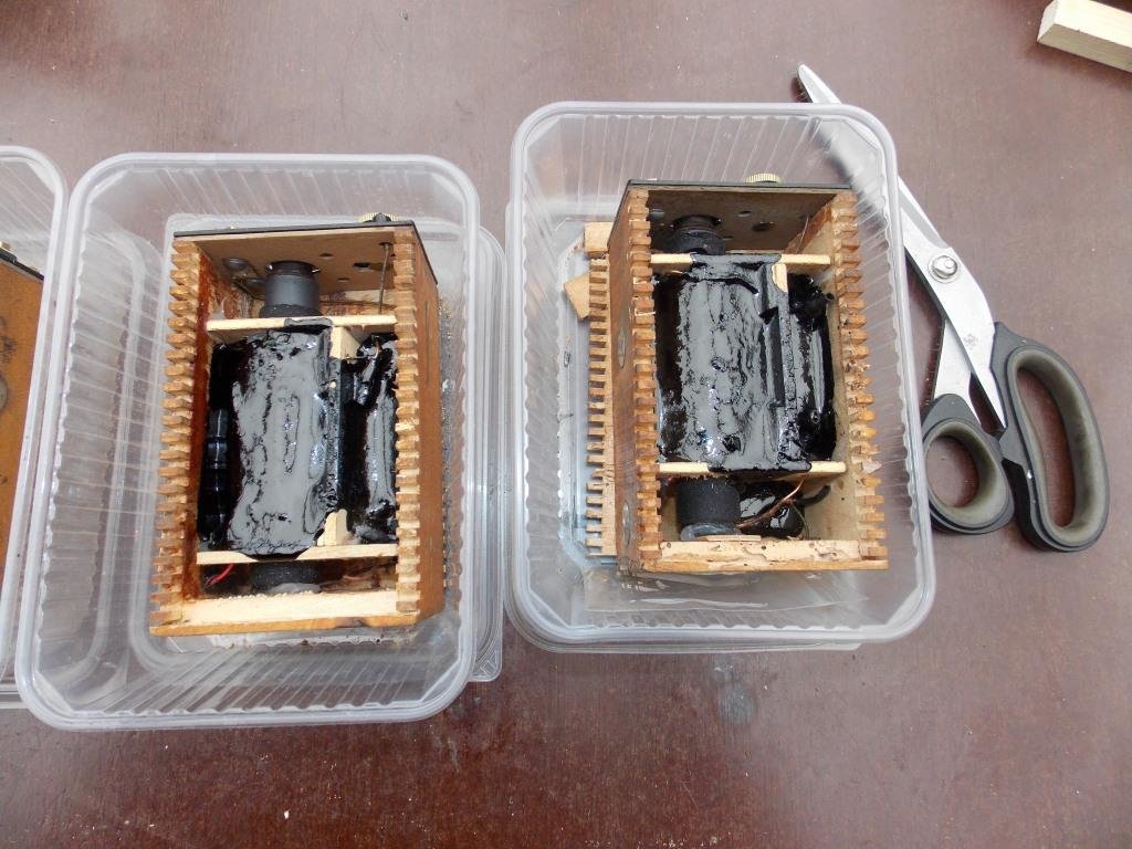

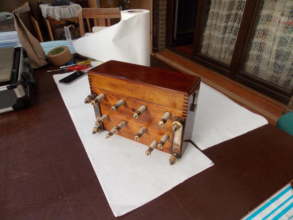

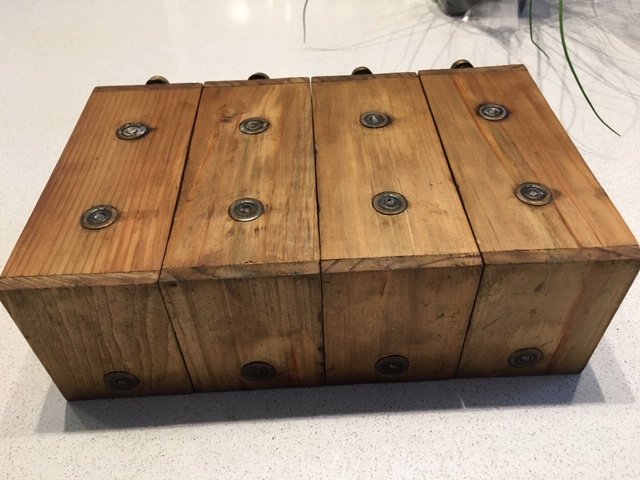

Ron Patterson wrote: ↑Wed Jan 05, 2022 10:08 amRich
Ron Patterson

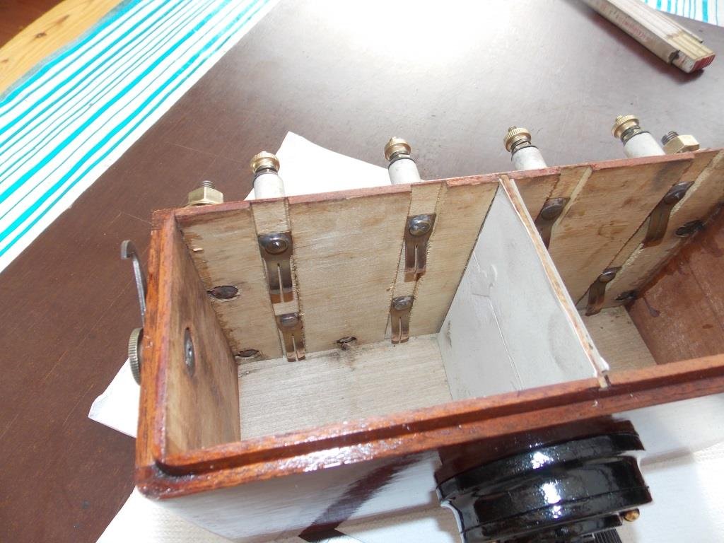

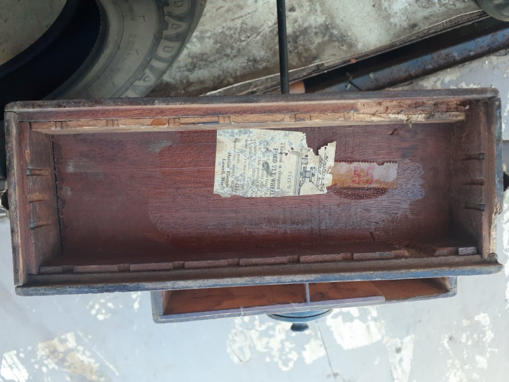

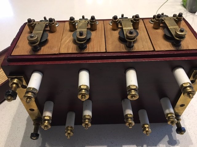

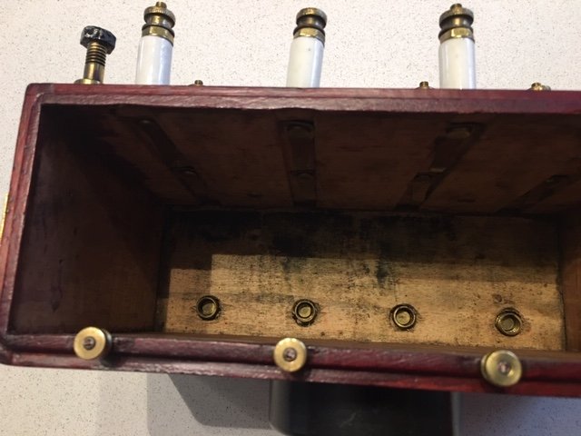

Hi Ron,
What is your suggestion for using later coils with this coil box as well?
Super Mario Bross
1911 Touring
1914 Speedster
1911 Touring
1914 Speedster
Quickm007

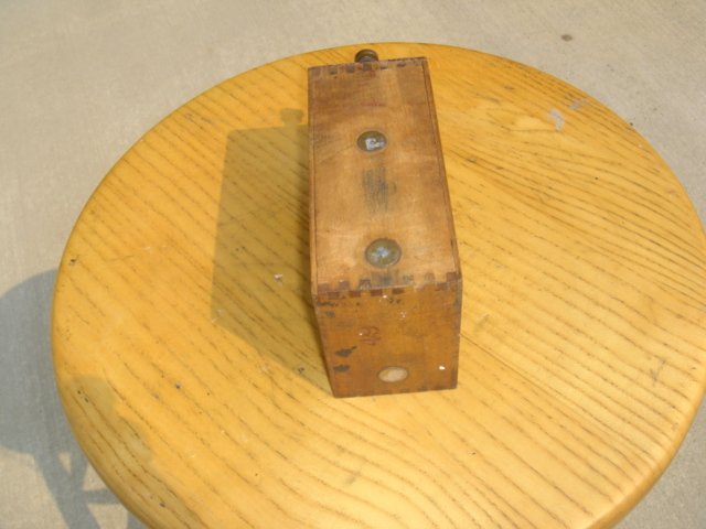

Quickm007 wrote: ↑Wed Jan 05, 2022 1:38 pmRon Patterson wrote: ↑Wed Jan 05, 2022 10:08 amRich
Ron Patterson
Hi Ron,

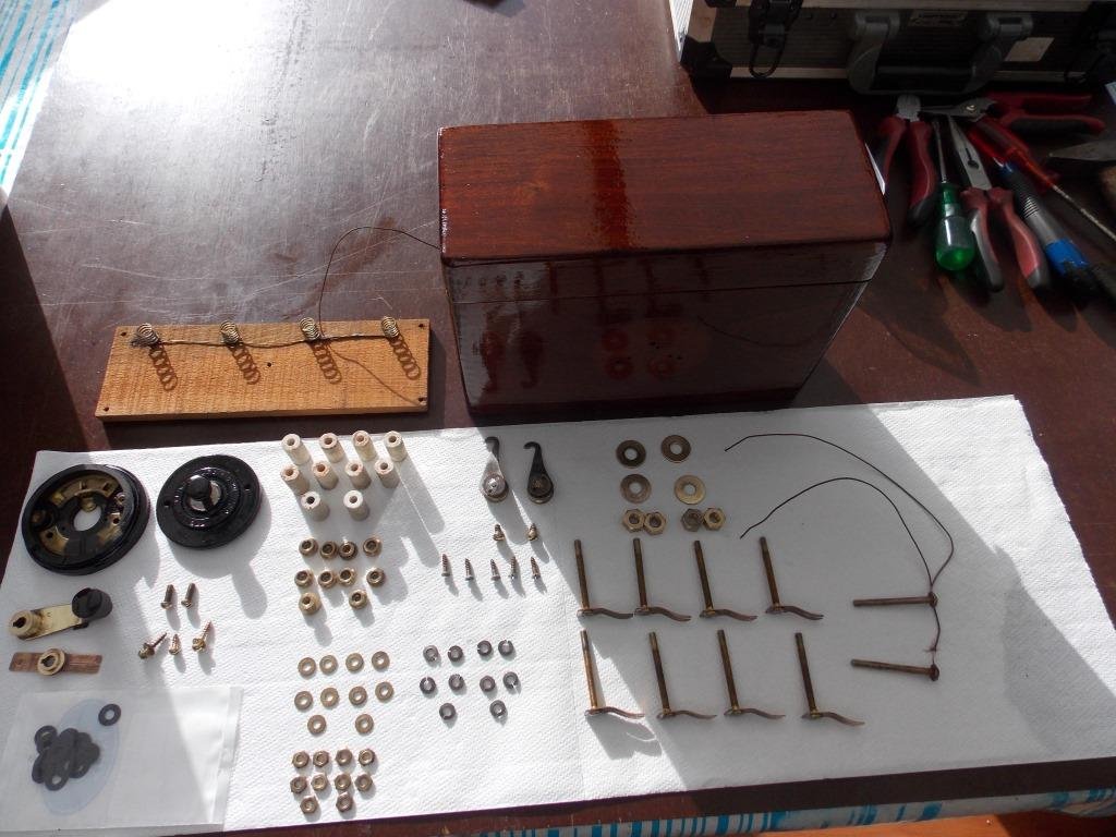

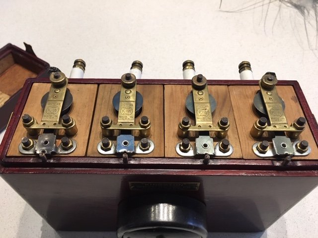

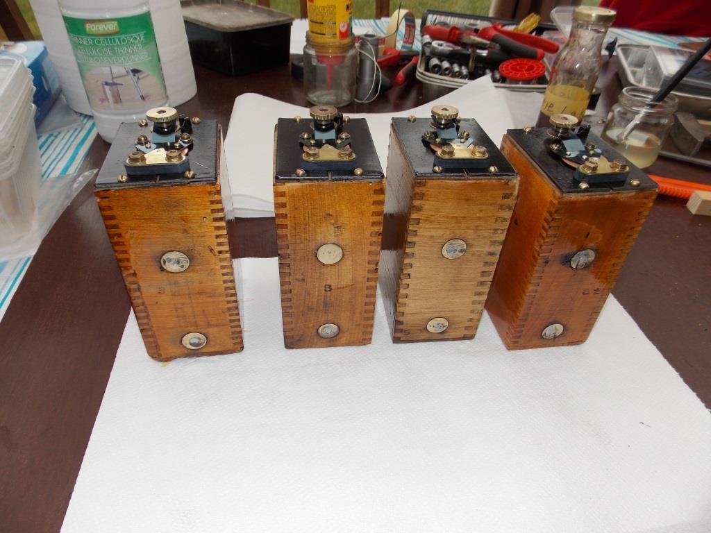

Super Mario Bross
1911 Touring
1914 Speedster
1911 Touring
1914 Speedster

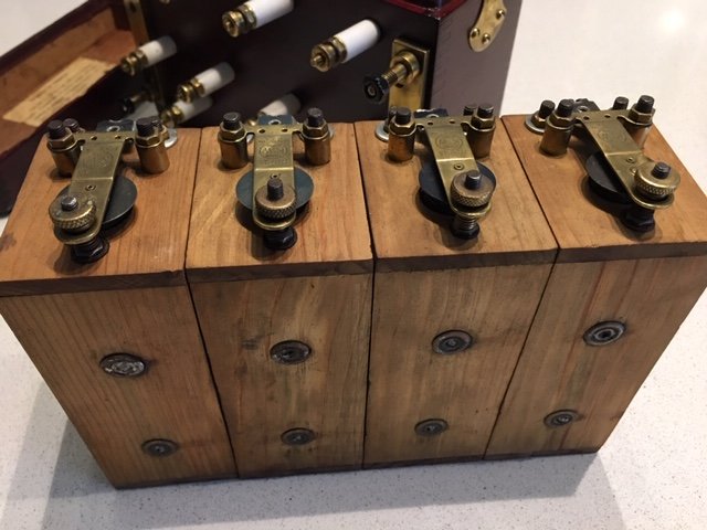

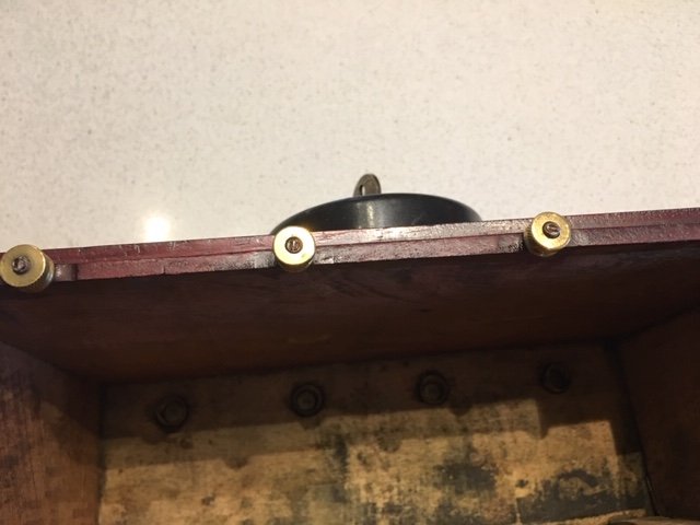

Re: later coils in 13 box

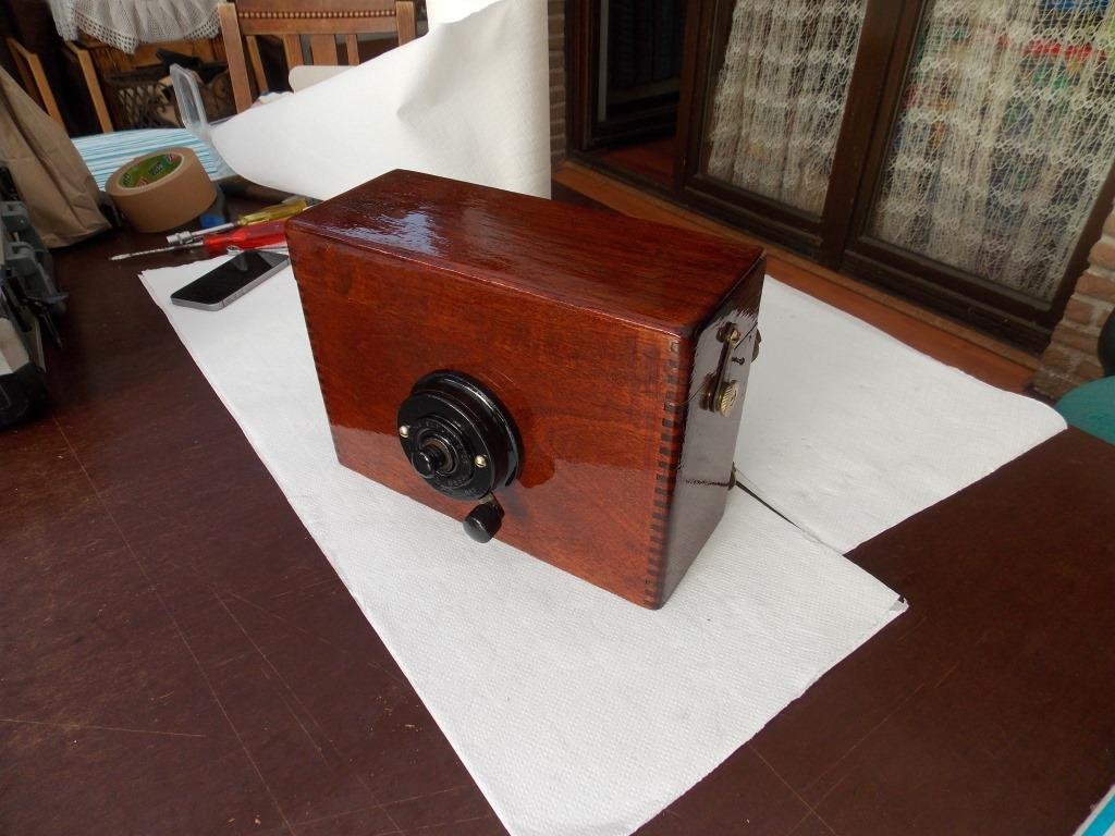

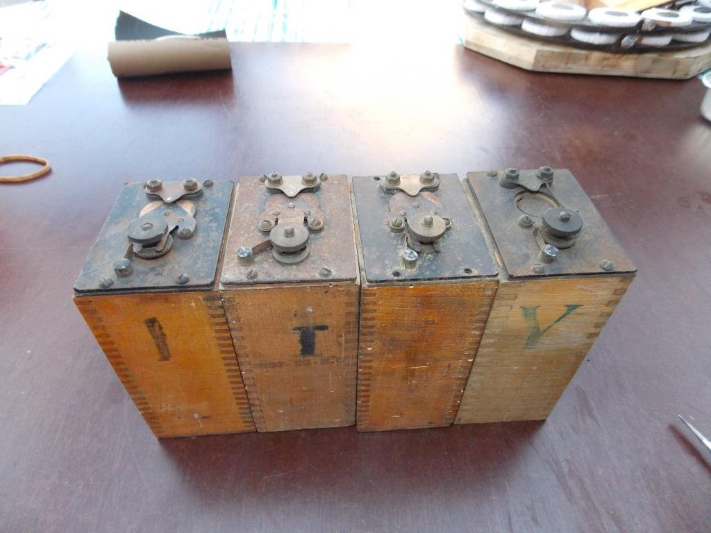

Quickm007 wrote: ↑Wed Jan 05, 2022 1:39 pmcoils 6.JPGcoils 8.JPGcoils 9.JPGcoils 11.JPGQuickm007 wrote: ↑Wed Jan 05, 2022 1:38 pmRon Patterson wrote: ↑Wed Jan 05, 2022 10:08 amRich
Ron Patterson
Hi Ron,
Super Mario Bross
1911 Touring
1914 Speedster
1911 Touring
1914 Speedster

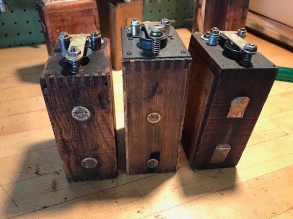

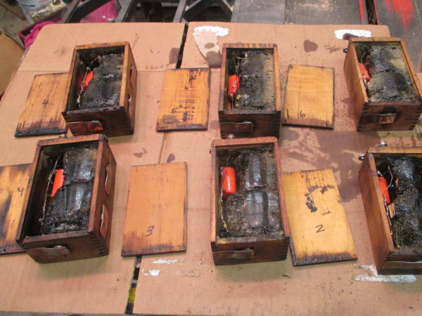

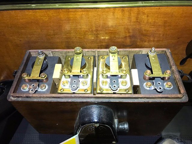

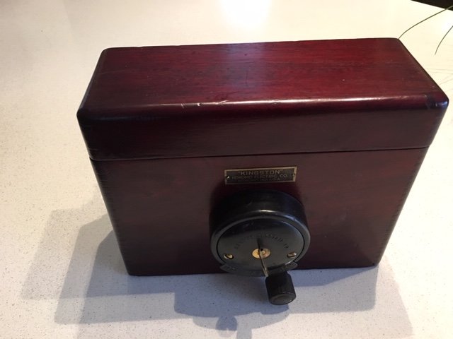

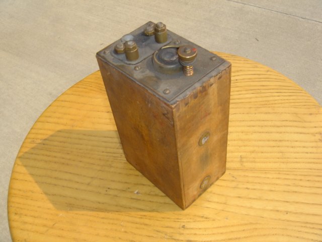

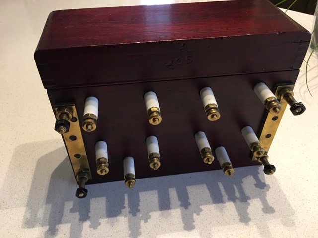

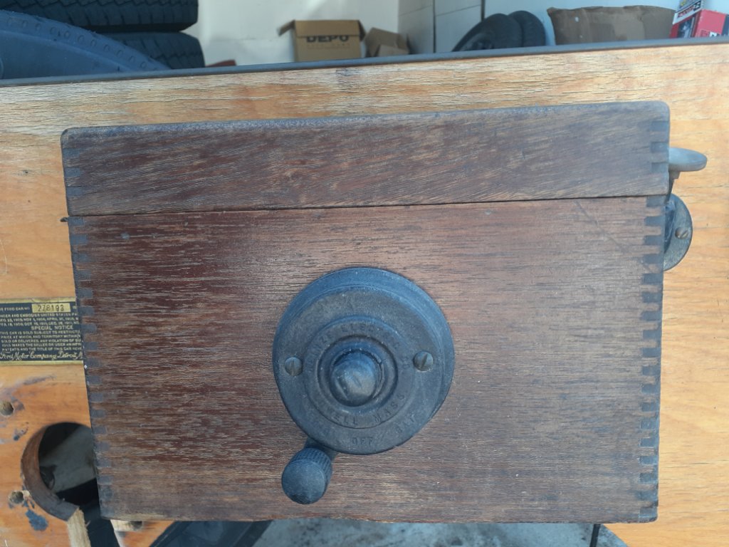

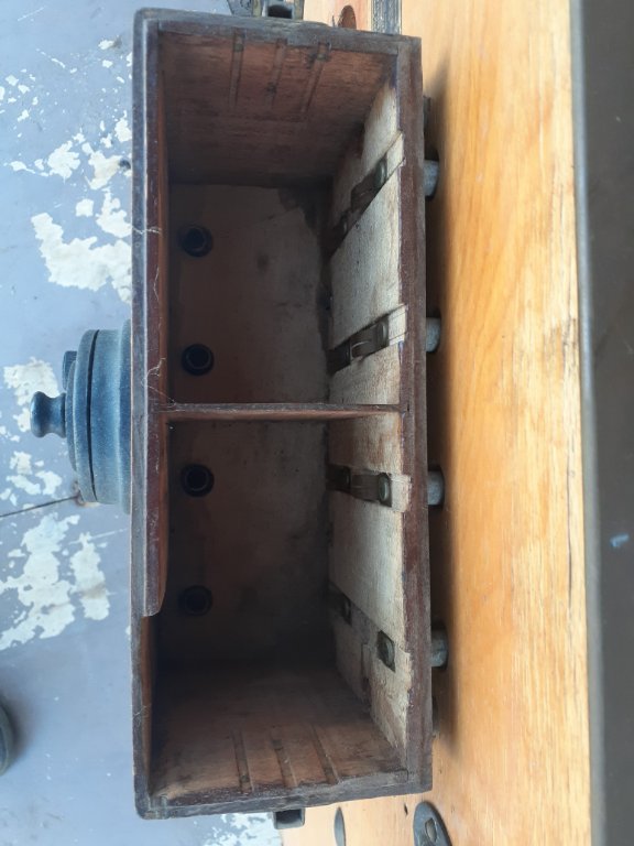

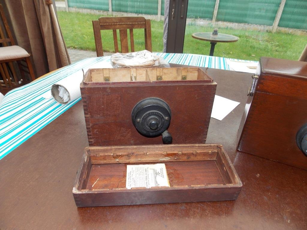

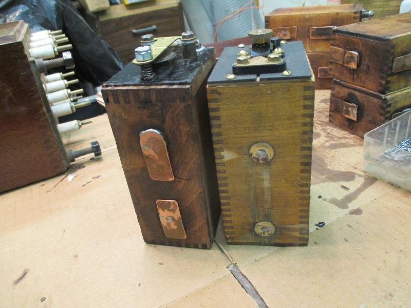

Here are a couple of pictures for clarification. The second picture is the underside of the lid.

Rich wrote that his coil box is too narrow to accept the newer coils, so he will not be able to just shim them and add tabs on the contacts.RichJ wrote: ↑Wed Jan 05, 2022 7:40 amThanks to all for the informative replays ,I have a box that is too narrow to accommodate the newer coils and I don't have the original coils,
has anyone re-configured the KW coils to fit in the smaller box ?
I' d be interested in buying the early coils -if anyone has any they would part with ; then I could do as Les suggested and use master vibrator or E timer.
Ron Patterson
My response to what I understood the original posters query was carefully crafted to be about the wood KW coilbox with the early KW coils used in the firt half of 1913.
Frank B. has helped that with better photos of the exact situation I described.
I would only add that soldering tabs to the coilbox contacts of later coils to line up with cntacts in earlier coilboxes is simple to do, is reliable and commonly done in these situations.
You will many other people seeking solutions because ignition coils in pre 1913 Model T's was cluttered with many types of cois/coilboxes were frantically being tried by Ford to to address the fundamental problems with seperate Trembler coil per cylinder inherent in multi-cylinder cars.
KW and others made a boatload of money selling Master Vibrator coils. KW made a bigger bundle of money by convincing Ford to adopt their Williams designed ignition that was qquickly standardised upon and used from 1913 to the end of Moel T production. Details can be found in the attached article.
Ron Patterson
Ron Patterson

I modified KW coils to fit into an original Heinze coil box.
They need to be reduced in size (front to back) by 1/4"
I did that by cutting the finger joints on the top and bottom deeper by 1/4" and re-sizing the other corners and joints accordingly.
Then extension for the contacts, etc...
It was very labor intensive and time consuming, but they work well.

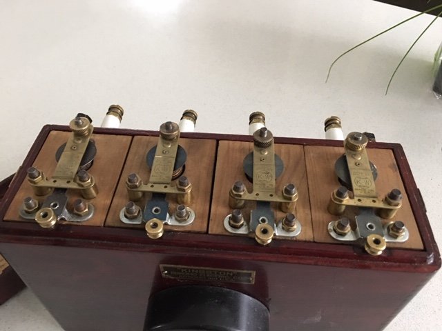

Mario, it looks like you have some special made coils for your Kingston box.
If you are having issues with them, it would be best to start a new thread.
Quickm007
- Posts: 1202
- First Name: Mario
- Last Name: Brossard
Hi for sure, I do not want to highjack this thread. I was just asking because it was really similar of my situation but with all input I saw on this actual thread I have an idea what to do.

Keith, I have been going through some ideas to fix Clays Heinze coils. I have 4 Heinze coils, but as it is, they are wrong for his 12. The idea of resizing the coils might be the way to go, and would be using more readily availed parts. I am still toying with using the later windings with the original points, don't know yet if I will pursue that route as the primary is a lot taller and would require some changes to the lid as well height of coil, adding about 3/16-1/4" to the height of the Heinze coils.

FWIW, which may be nothing, I rebuild, restore, and reproduce all styles of Heinze coils used on Fords and other early cars, 1906-1914. Exact replacement parts are readily available and I have many satisfied customers. The issue is my getting back out to the shop, if and when this knee/leg will allow it.

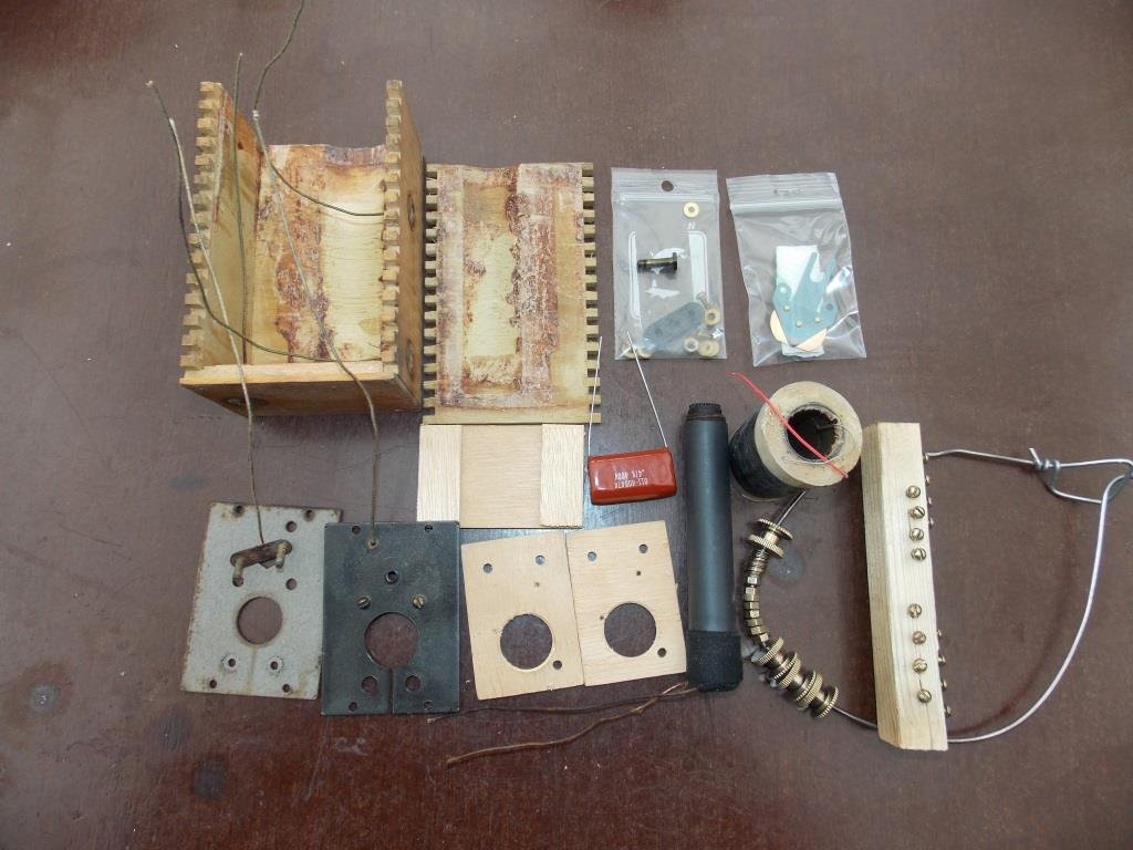

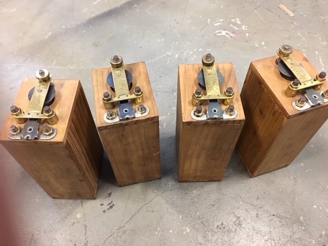

First best wishes for the New Year.
I am dealing with the same problem: fitting later coils in a 1913 K&W wooden coilbox.
In the past I rebuilded a few Heinze coils with the later interior parts (see photos).
Here, to make it look right, I will build new boxes that fit right in the K&W coilbox.
It will be cleaner and better looking than make shims and adapting later coils to the box. (Will post photos as soon as it is done.)
Good luck
Andre
Belgium
Good luck
Andre
Belgium
