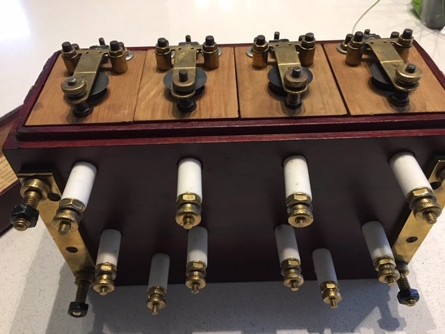

Here are a couple of pictures for clarification. The second picture is the underside of the lid.

Post by RichJ » Wed Jan 05, 2022 2:41 pm
One more picture.

Rich wrote that his coil box is too narrow to accept the newer coils, so he will not be able to just shim them and add tabs on the contacts.

I am dealing with the same problem: fitting later coils in a 1913 K&W wooden coilbox.
In the past I rebuilded a few Heinze coils with the later interior parts (see photos).
Here, to make it look right, I will build new boxes that fit right in the K&W coilbox.
It will be cleaner and better looking than make shims and adapting later coils to the box. (Will post photos as soon as it is done.)
Good luck
Andre
Belgium
AndreFordT
Posts: 566
Joined: Sun Jan 06, 2019 12:25 pm
First Name: Andre
Last Name: Valkenaers
* REQUIRED* Type and Year of Model Ts owned: 1926 ; 1922 ; 1915.
Location: Scherpenheuvel
Re: later coils in 13 box
Post by AndreFordT » Fri Jan 07, 2022 8:05 pm
And here the coilbox.
